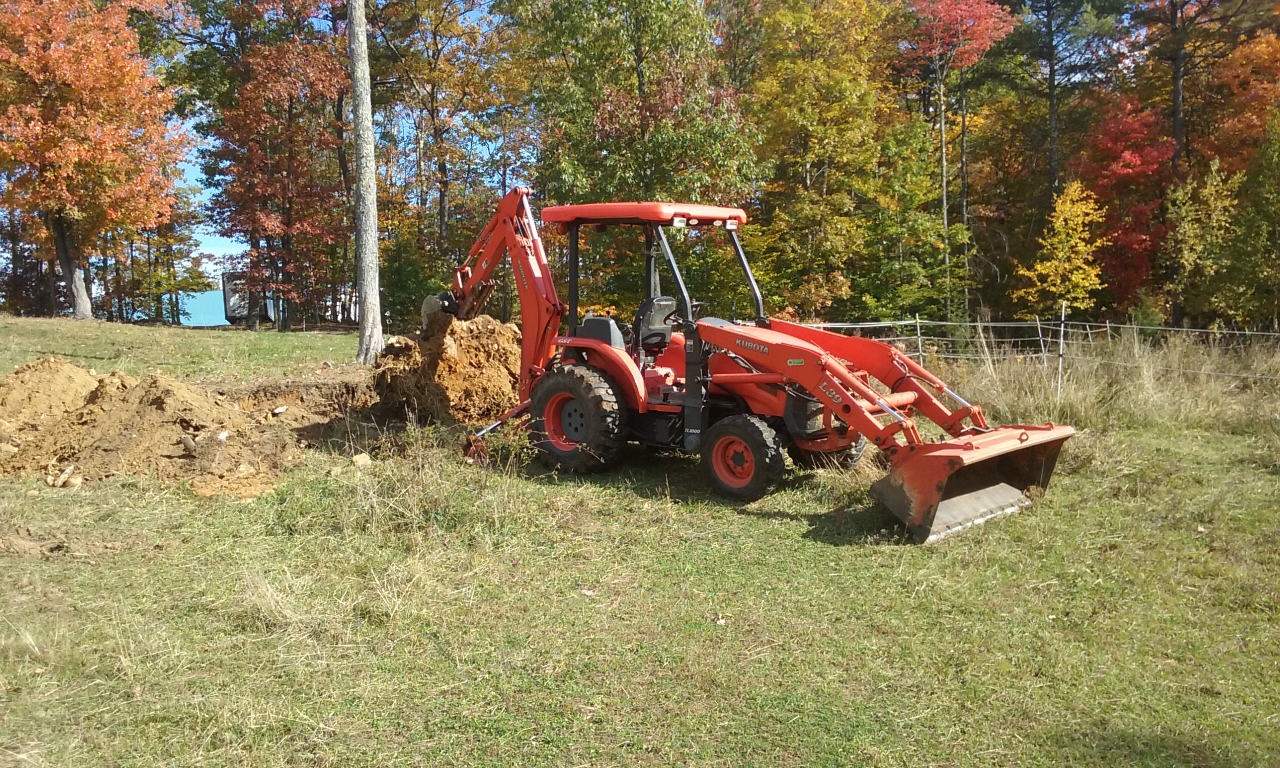

The Owners manual of my L39 says not to run loaded tires with a BH
Note Picture of 750 lbs of wheel weight on my tractor with hoe. I need the weight.
