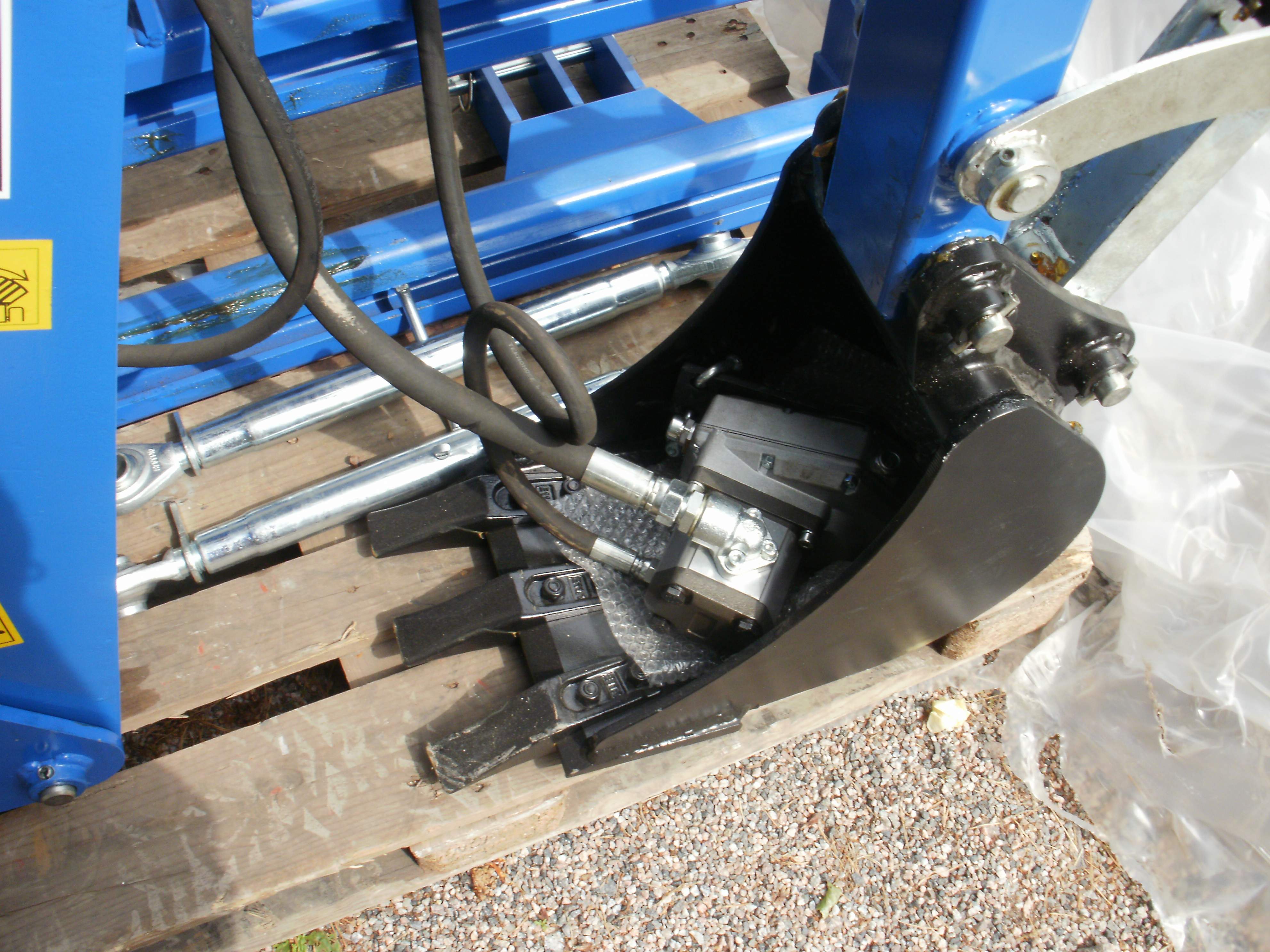

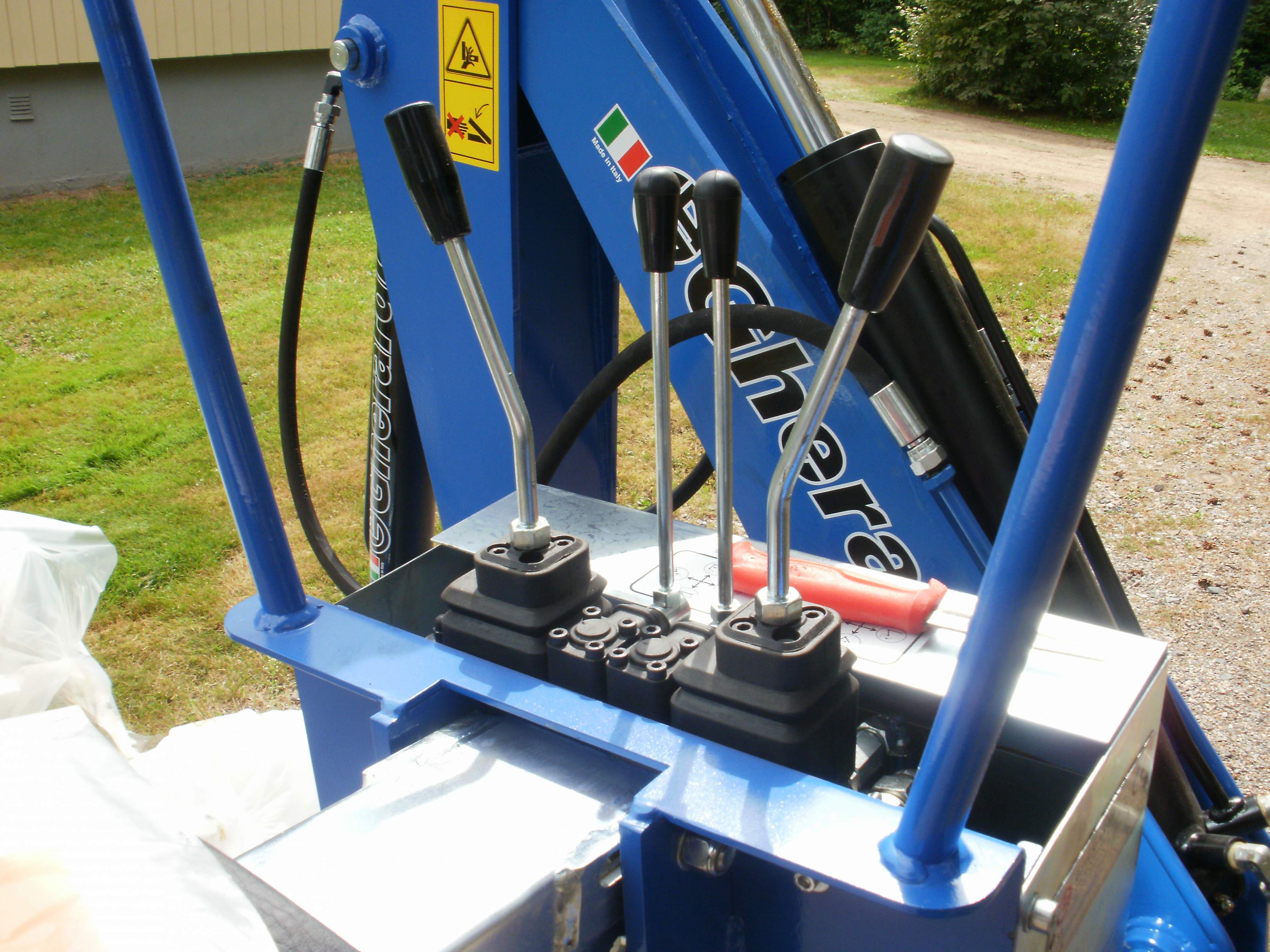

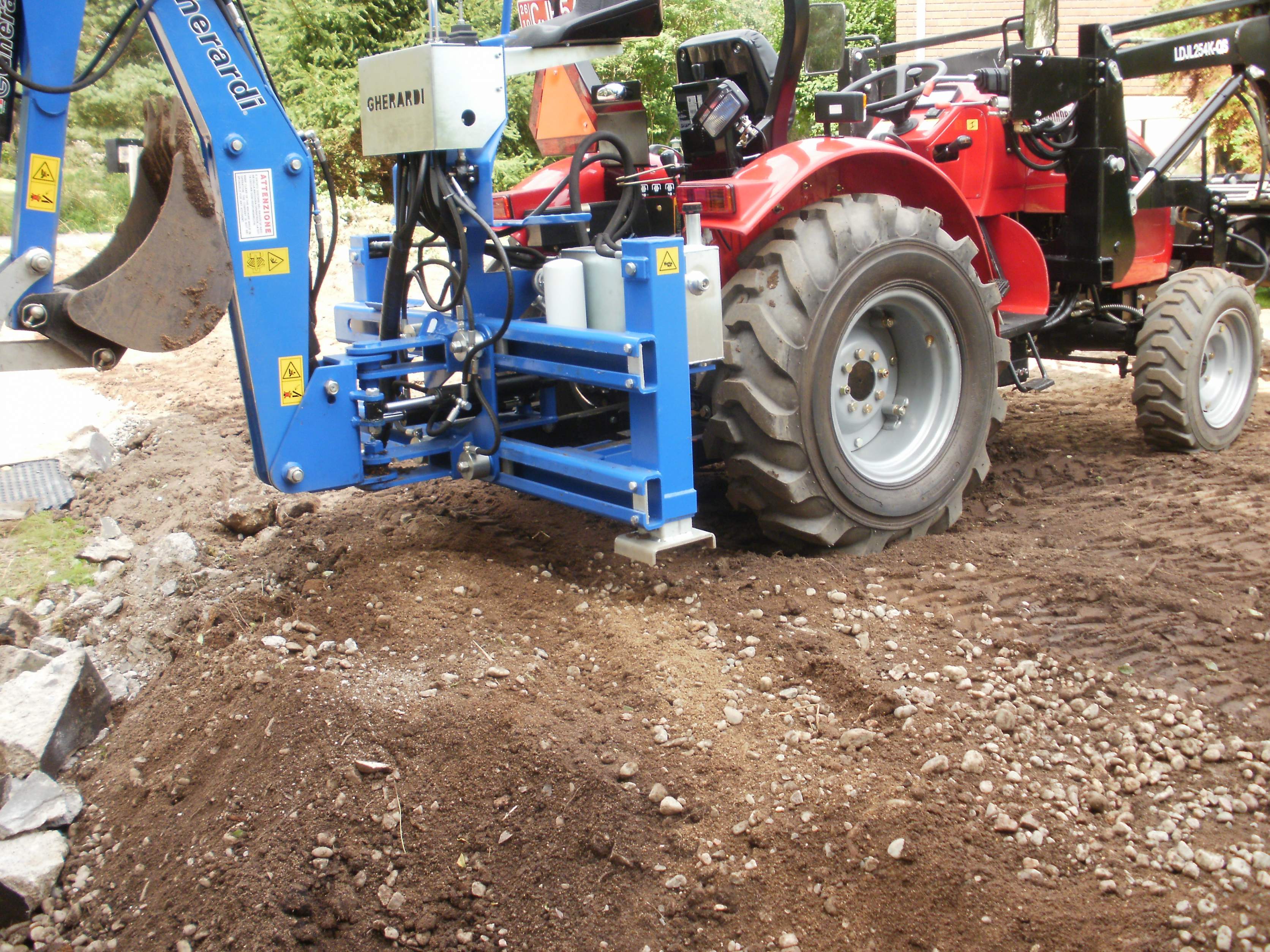

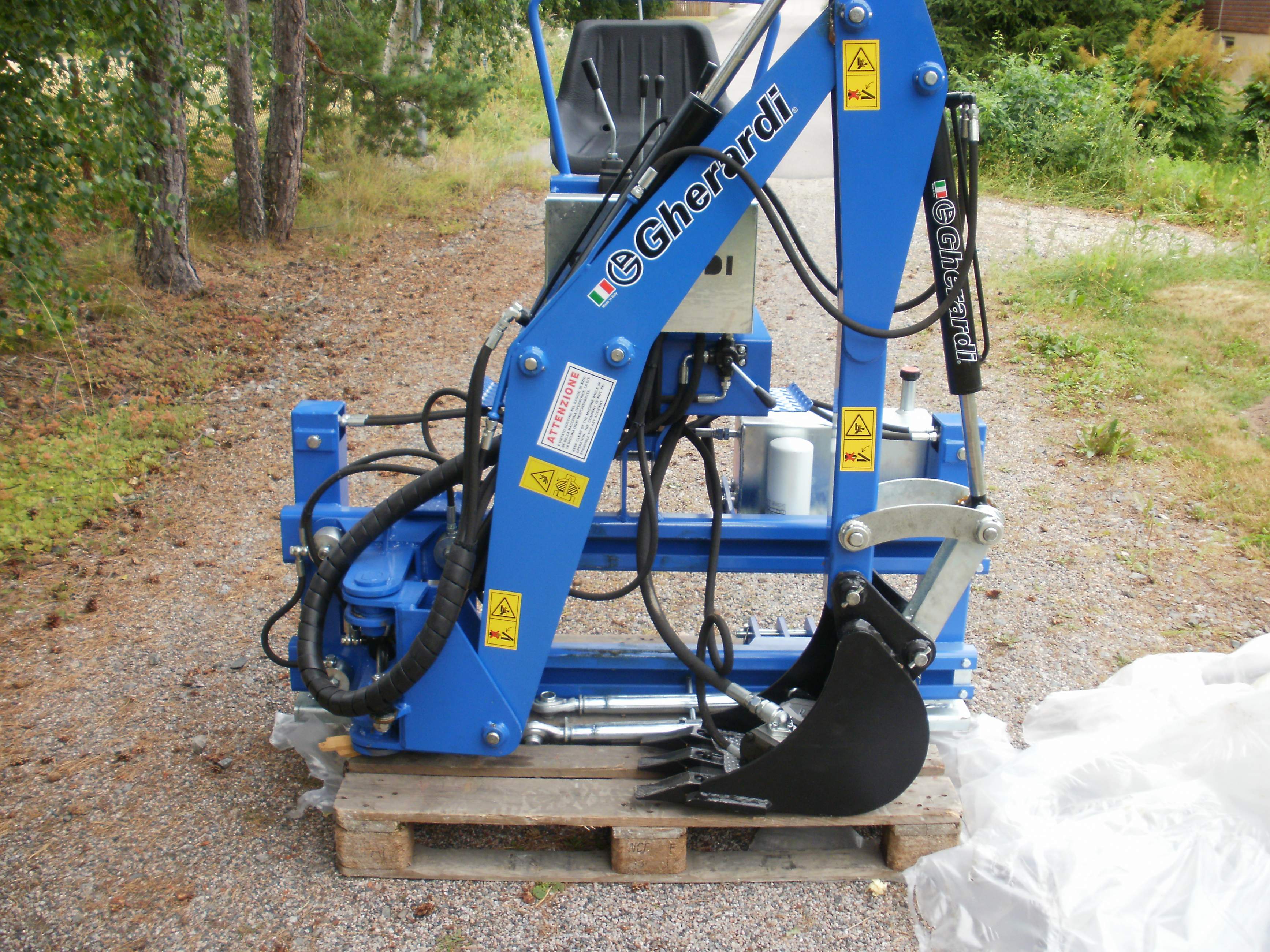

Hey Johnny.
I have a Mahindra 2541 (Mahindra 2525 in US) which is the former Lenar 254.
When I made an choice for which backhoe to fit on it I made a a lot of research before I decided. I read that many people has had problems with the Chinese backhoe so I decided to go for a Italian type.
I am not afraid to do my own imports without any dealer support to save a lot of money, so both the tractor and the backhoe I order directly from the factory where they are made.
The Italian backhoe is a -2010- Gherardi Backhoe 7,2' Digging depth, 4850 lbs breakout force, Side Shift type. I have made a custom sub-frame for it. It was delivered as a 5 point setup instead as the common 3 point. But with a breakout force of 4850 lbs/ 2200kg I decide go for a sub-frame.
I am very pleased with it so far, it is fast and very very precise in the movements, you can operate it with simultaneous movements and its very strong.
My backhoe has its own PTO pump and oil reservoir. This feels for me much better then charing my common sump with the backhoe. With its own hydraulics I have a clean hydraulic oil with its own circulation filtered by a 10 micron return filter and I know that the pump capacity is rated for the hoe for best performance considering pressure and flow.
If I make a comparison against the price in France on a Chinese backhoe which according to they're site cost 3908 Euro inc VAT. I payed 4056 Euro incl VAT for the Gherardi. But then I had to pay shipping to Sweden also but still it is almost what a Chinese backhoe cost here in Sweden.
Just some input on why I choose a Italian type with its own hydraulic pump system :)
What kind of FEL do you have?
Here is some pictures on my rig and on the backhoe.

Sweden-art, I assume by your pics and what you called side shift that you can move your hoe to the left or right side of your tractor? Is that done by the hydraulics? That is a cool idea and would come in very handy for digging around buildings.
I have a Woods BH on my tractor and while I am very satisfied with it, that feature would have been nice. I have the need to dig around my house foundation to lay some drain tile to help keep the basement from getting wet. Your configuration would work pretty nice for that, mine is going to be a little more difficult or at least will require a larger hole.
   / Backhoe #8
Hey.
Thats correct. It can be moved from side to side. As you mention it can be very handy when digging near walls and foundations. The frame/outriggers width is 5' (150 cm) thats is slightly wider than my tractor. But i guess I loose some stability with this type comparing with standard center pivot outriggers. But frankly I cant see how it could be more stable than it is :) Guess my sub frame is helping a lot for the stability.
The lock/unlock for it is hydraulic but to move it sideways you need to push with the dipper stick.
The woods model looks very nice. I sure would have taken a closer look at them if we would have a dealer in Europe. But i dont think there is any woods representation here. I did did not find any though.
