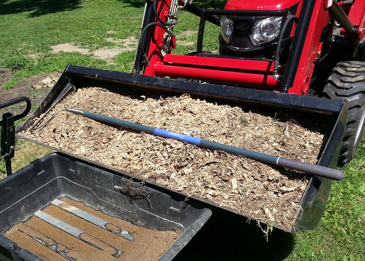

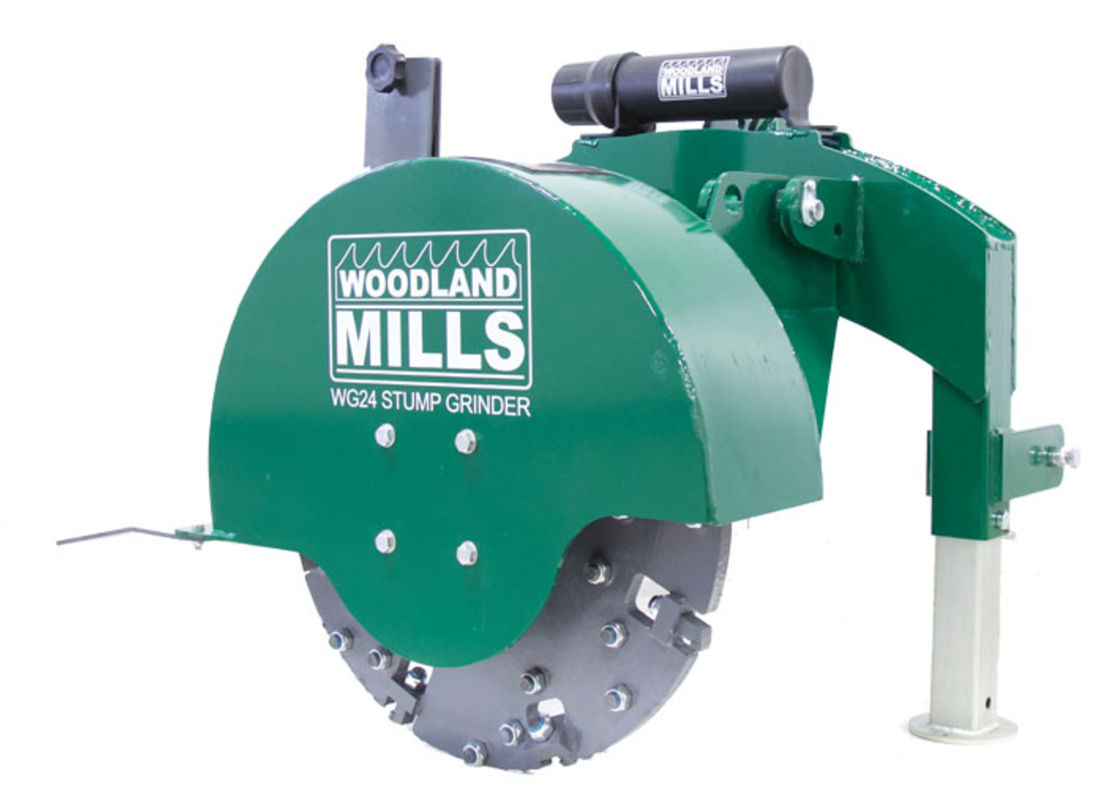

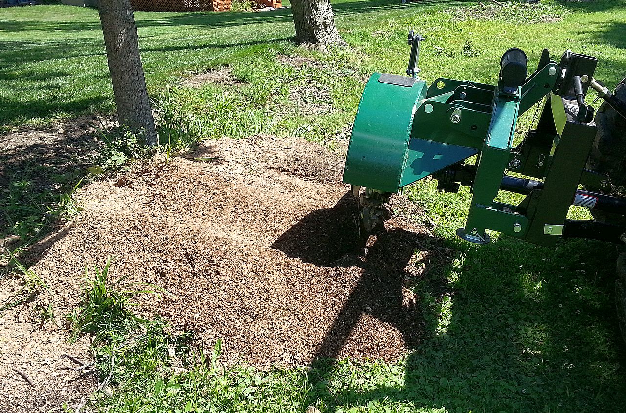

I bought a tractor with backhoe and a Woodland Mills stump grinder (with a straight PTO shaft to the disk, requiring tractor motion to cut), and a tree puller, as I was paying a fortune for tree work. This is what I've learned: it's much quicker to use a stump grinder to get things out of the way. Yeah, in a few years you'll have a little sinking where the rest of the stump rots, but it's nothing—if you have an FEL.
Still, there are some I dig out, especially on property lines where I am grading; there, it's worth the time.
Even though I have a shuttle shift, I have no real issues with my grinder, as I usually have a slight slope for the tractor to coast down, and I control the speed with the brake. Otherwise, I "roll" the bucket to move the tractor. It would be easier with a hydrostat, of course.
If you are grading (we've removed some dead pines and ashes along a property line, where we're making a two foot drop off into a gentle slope) you'll have to bite the bullet and dig 'em out. I figure that for 12" stumps, I can grind up to ten in the time it takes to properly did out a stump.

Cool on the grinder. Talk to me about the woodland mills grinder! What is the exact model? would it work on my 55 hp? I'm so tickled you like it---that's what I prefer the stump grinder and then fill in holes later. Has it torn up your PTO at all since using it. I have about 40 stumps to deal with this time, and they range from 8 inches to 18 inches all pines and one large oak stump. The LS is hydrostatic. Do I go back to the dealer to find the attachment or do I look for it used to save money?

I have a Worksaver SG-26 3pt grinder... I've done several hundred stumps with it. Works fantastic. More refined than the Woodland Mills grinder, but more expensive too. There are a handful of companies now that make 3pt grinders, so you'll have your choice. I drove out to Iowa to get mine, they sell on eBay. Your XR4156 has the same HP as my machine, you'll handle it well.
