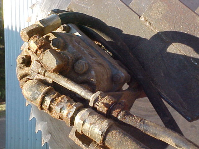

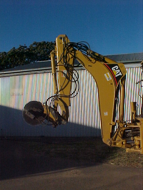

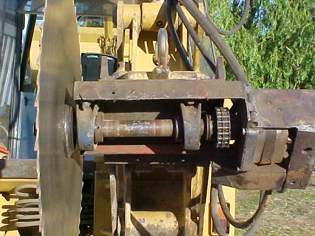

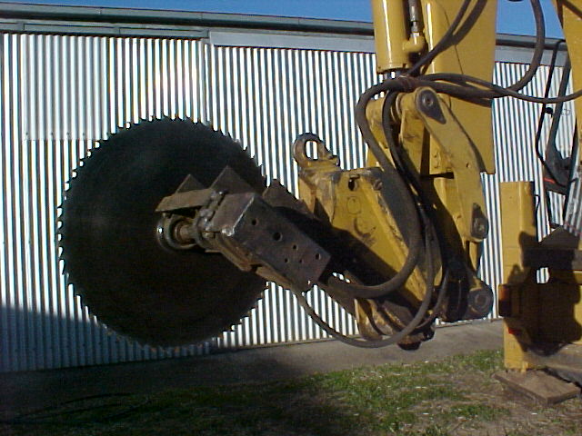

I've been using a homemade, hydraulically driven circular saw for a few years now.
The motor is a Plessey gear motor and has been working well for the last 2-3 years since I plumbed a separate return to reservoir line (rather than through the valve).
Another problem has been the hyd fittings coming to grief when they sometimes come in contact with branches etc.
So today I fabricated a protection cover from a bit of old Chev Maple Leaf chassis rail (found in amongst the steel offcuts in the workshop) and a piece of flat steel.
It is easily removed by pulling out two pins - I always unscrew and plug the hyd lines when removing it.
With 160 lpm - about 40 gpm I think, available it has plenty of speed but as with most hyd driven things it will eventually slow in heavy going (1' plus hardwood) and have to be pulled back to recover speed.
