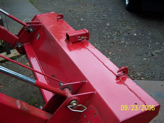

I don't have the backhoe for mine. I mounted a receiver hitch on my bucket. You could probably weld this to a backhoe bucket somehow also.
