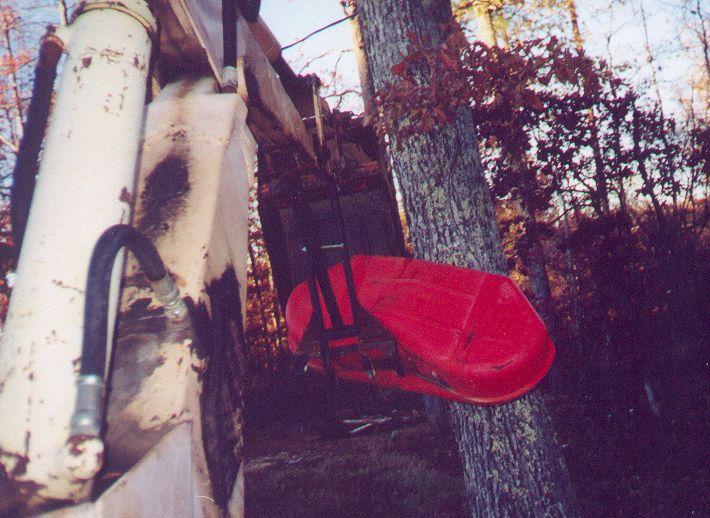

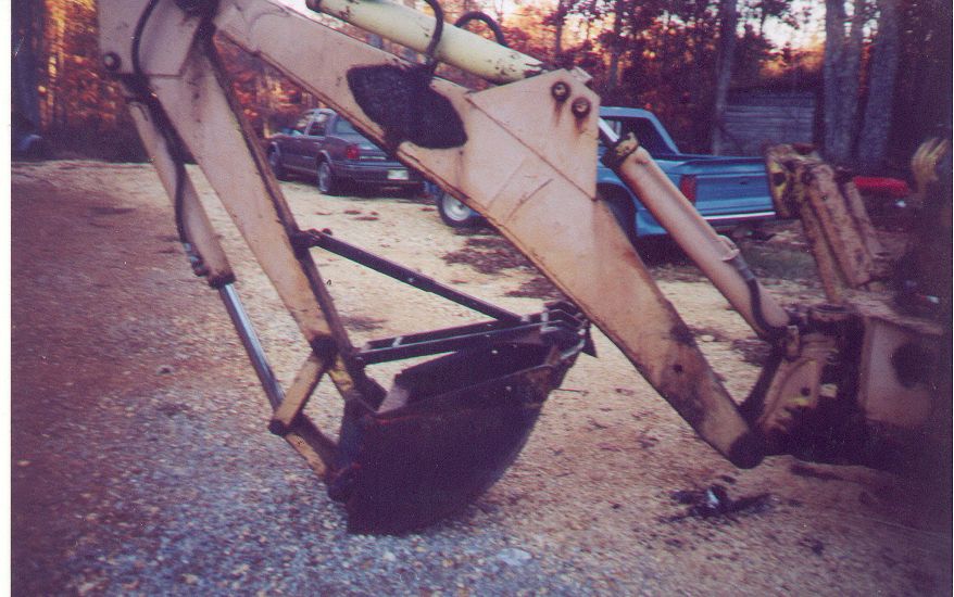

I thought id post a picture of my thumb grapple i built for my old 3550 Ford backhoe. It took 15 dollars and 4 hours to figure out how i wanted it. I think i was 17 or 18 when i built it. Ive loaded logs scrap iron torn down and loaded old barns, and placed rip rap with it. also handy about grasping small 4 inch diameter pines and pullin them from the ground. I made 4 tines on the thumb becaus the bucket has 5 teeth. that way i cand use the horizontal bar to hold against the web between the bucket teeth. when pullins small itemes like rebar scraps.

thump pics

grasping combine fuel tank

thanks for sharing your work and idea with us ... my mechanic has been looking for an inexpensive way to make his own thumb ... yor pictures hit the nail on the head.
   / backhoe thumb #5
This too is what i have been looking for - it's great and inexpensive to boot.
I am thinking about a swing up design with a bracket on the BH arm so you can store the thumb on the arm when not in use. Also doing it so the atachment link folds into this bracket too and then gets pinned in.
Great idea, now off to the drawing board.
