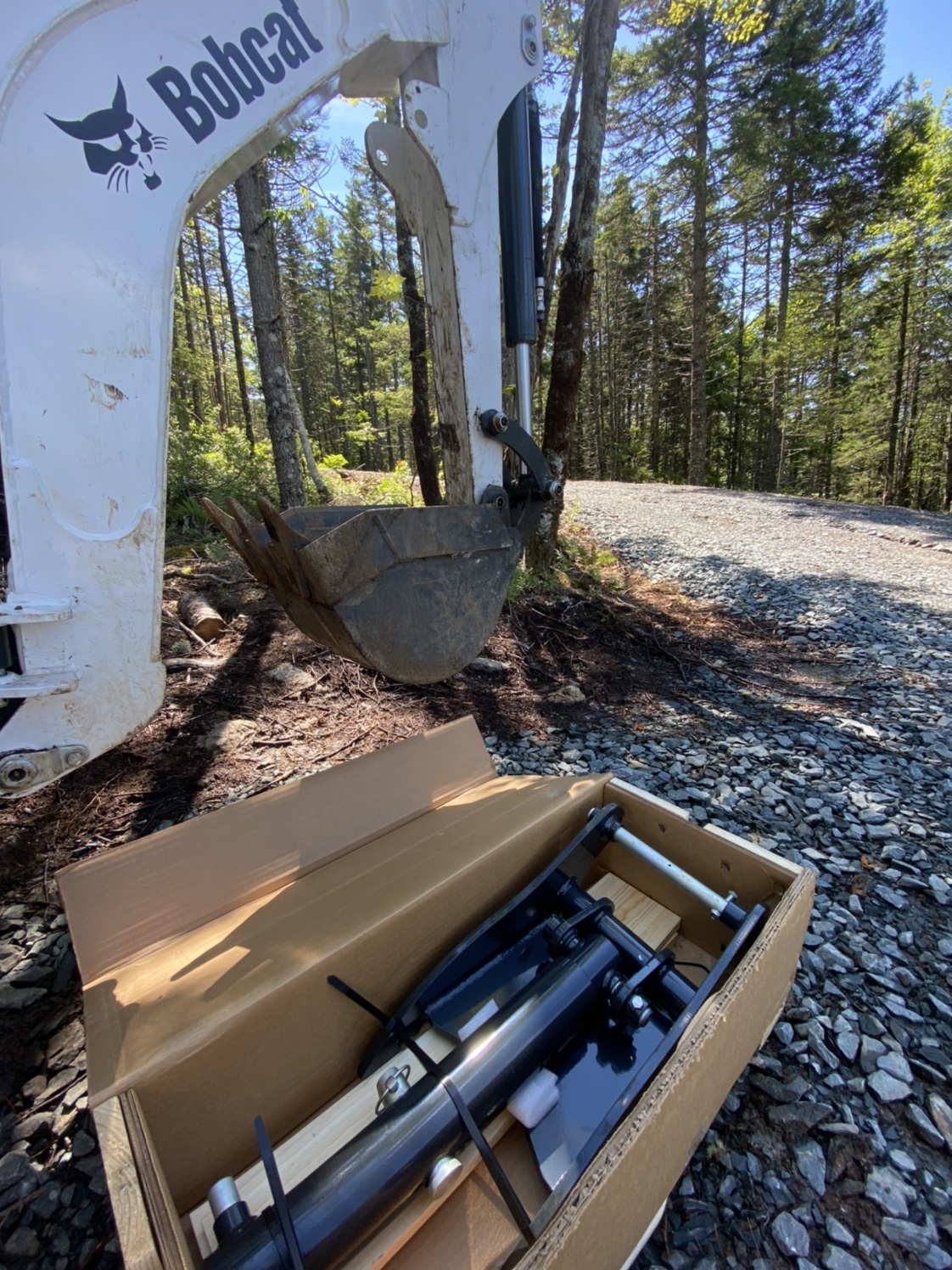

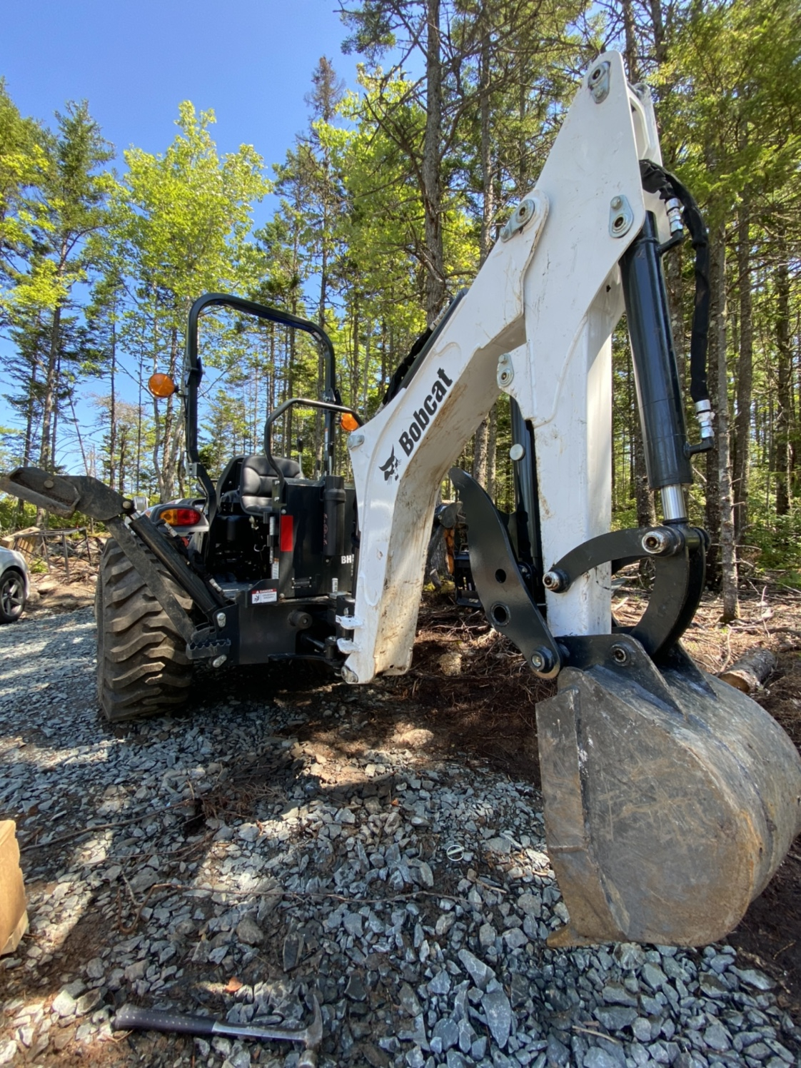

I ordered the thumb with my Bobcat CT2025 and backhoe, but it wasn’t available in the spring when the tractor was delivered. It finally arrived this weekend, 45 minutes to install and wow what a game changer!
I’m putting an 800’ trail through the woods and the thumb makes removing the organic/moss layer way easier as well as grabbing felled trees. My feet/hour of trail will go way up now, excited!
Just wish it had come a bit sooner, would have saved a lot of paint on the dipper while moving large rocks.

This tractor is equivalent to Kioti CK2610. Tractor is essentially the same, but Bobcat uses their own design/supplier for the FEL and Backhoe.
I got the thumb for $1400 CAD, which is a ridiculous price compared to aftermarket, but the backhoe model is too new and I couldn’t find an aftermarket model that would fit.
I must say, it is very heavy duty compared to the light weight looking adjustment bars I’ve seen on some. I would have liked hydraulic, but since this backhoe swings a full 180 degrees it is easy to reach and adjust without getting down off the machine.

If you are thrilled with it so far, replace the fixed tube with a hydraulic cylinder. Then it will work just like an excavator. "It's a fair bit of work though".
