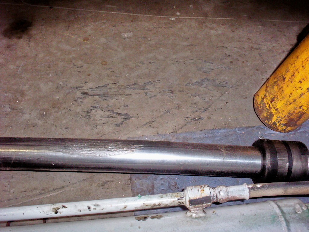

A couple pops? Makes me think bent rod even more. Do yourself a huge favor. Do not use the backhoe until you determine the problem. If it is an internal cylinder problem, you can probably salvage most of the cylinder. I have a cylinder here in my shop from an old ford backhoe that the idiot operator kept using after he had this same issue. It took me about 3 hours to disassemble the cylinder and after I got it apart, the only thing good on the cylinder was the fittings that were screwed in to the ports. :eek:
You can see where the rod was rubbing the cylinder housing. I could have saved the piston and housing if he stopped using it.
Now I don't know if yours is a cylinder problem or not. What I'm saying is don't let a minor problem become a major problem.
