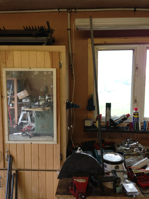

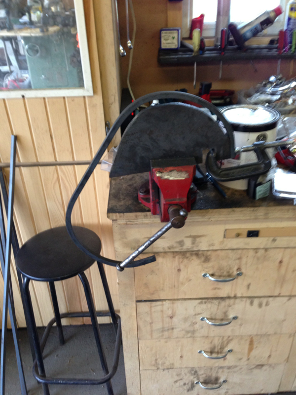

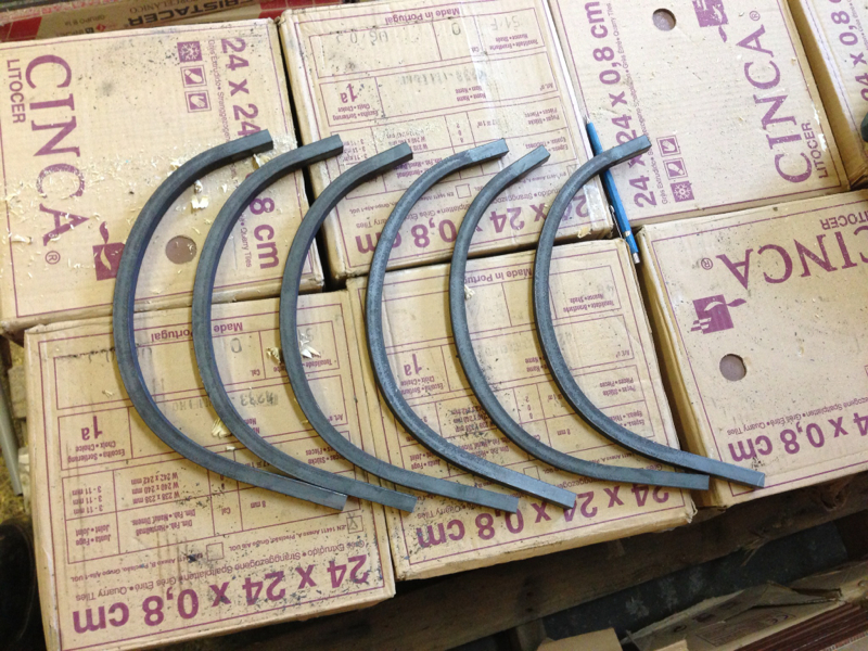

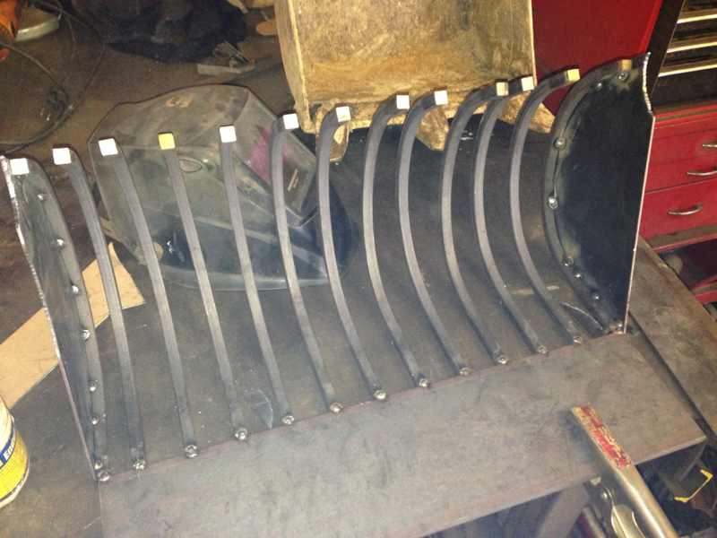

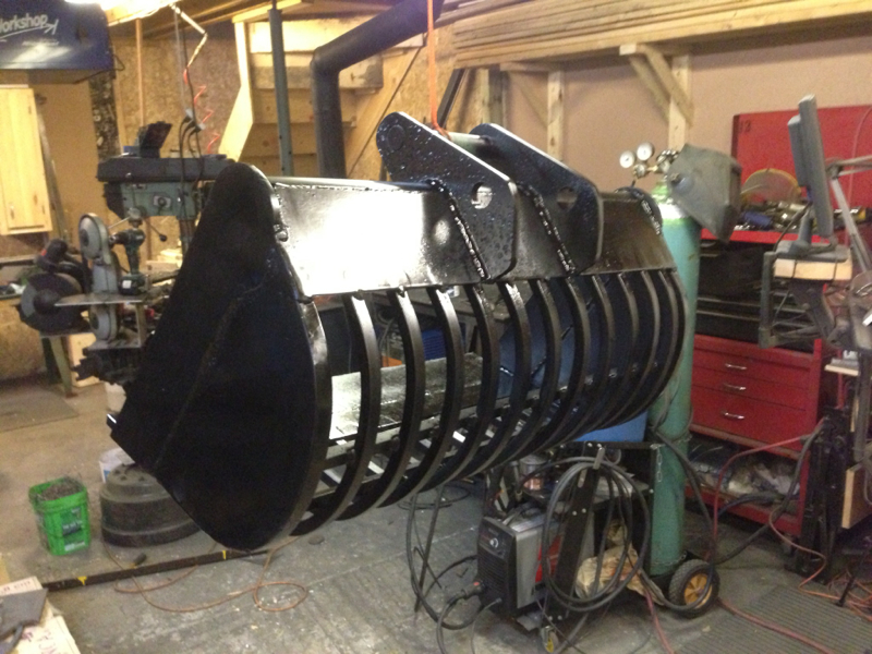

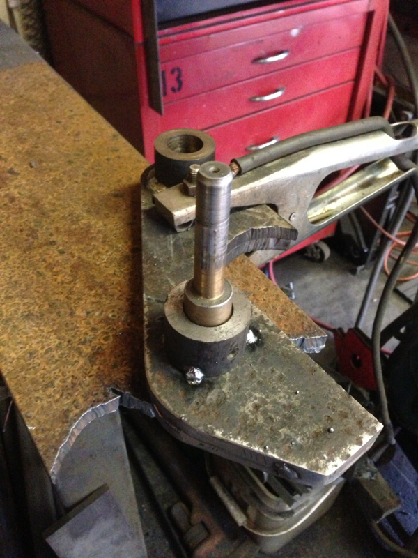

Since I live in an area that is mostly rock I wanted a way to remove the larger rock from the gravel. Started out with a bending jig clamped in the vise and 1/2" square stock and started bending.
Made two pieces out of each bar so I could have some leverage.

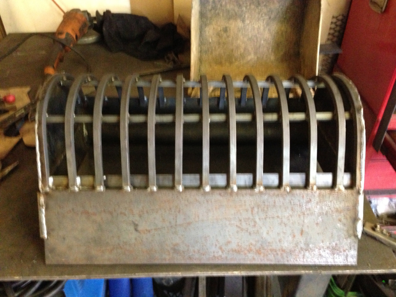

All cut to size. There are 13 in total.

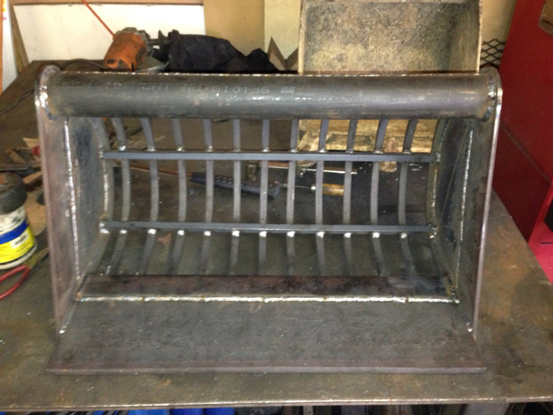

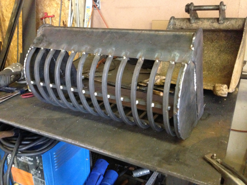

All 13 tack welded to the front edge of the bucket.

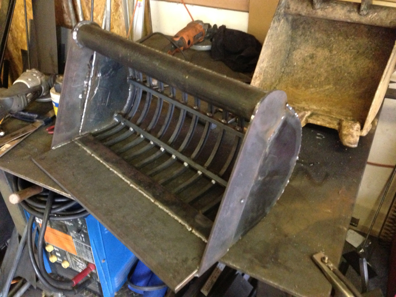

1/8" Side plates added.
Front edge of the side plates is 1/4".
All tacked together and squared as best I could. The 1/2 square had some twists from being bent by hand.
Front view.
   / Backhoe Skeleton Bucket
#2

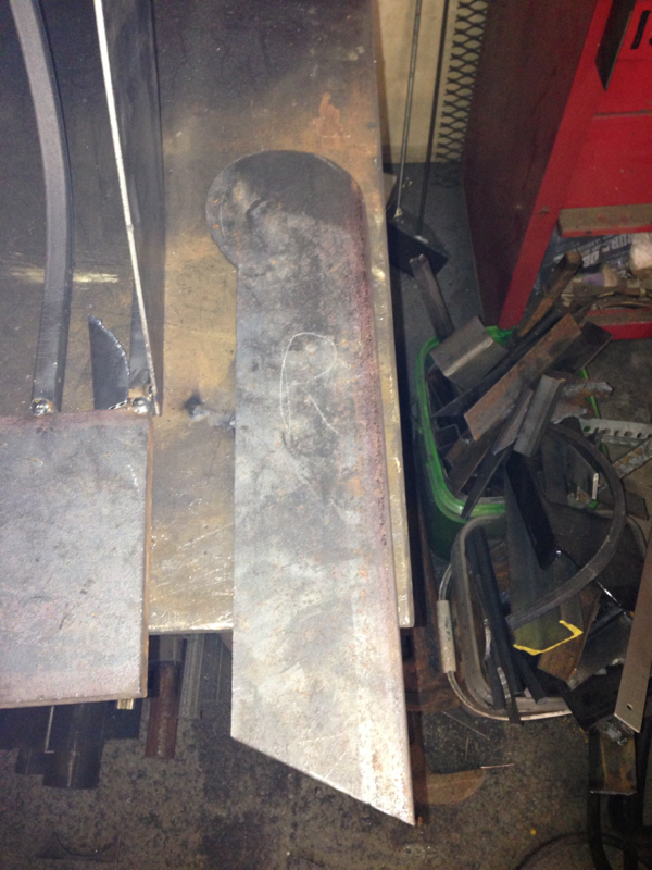

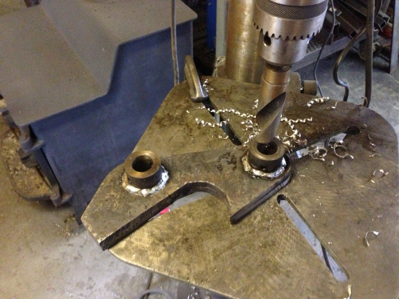

Started cutting out the mounting points.
Cleaned up and test fitted.

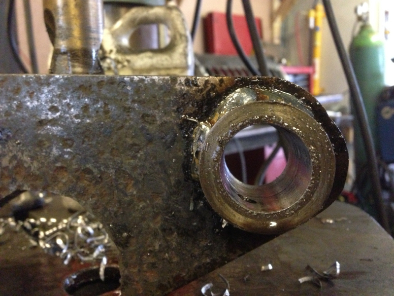

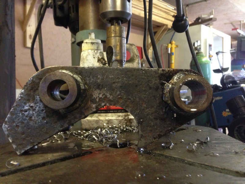

Centred and tack welded together and then drilled two 7/8" holes for the pins.
Once the holes have been drilled I used the 7/8" drill bit to centre the flanges used to secure the pins.
Once welded solid I drilled them out to 1" so that I would have clean perfectly aligned holes.
One done one more to go.
Clean hole with no ridges from the flanges being welded on.

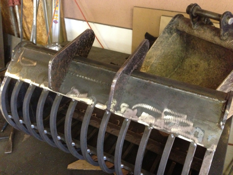

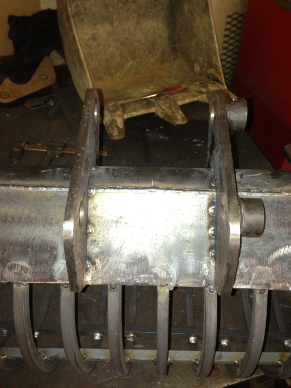

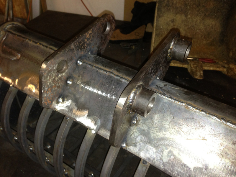

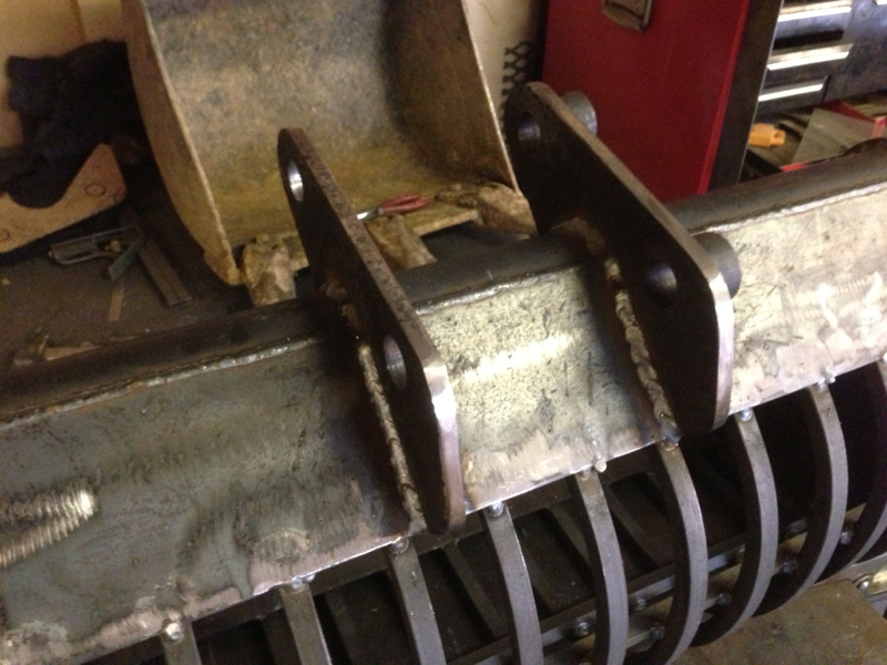

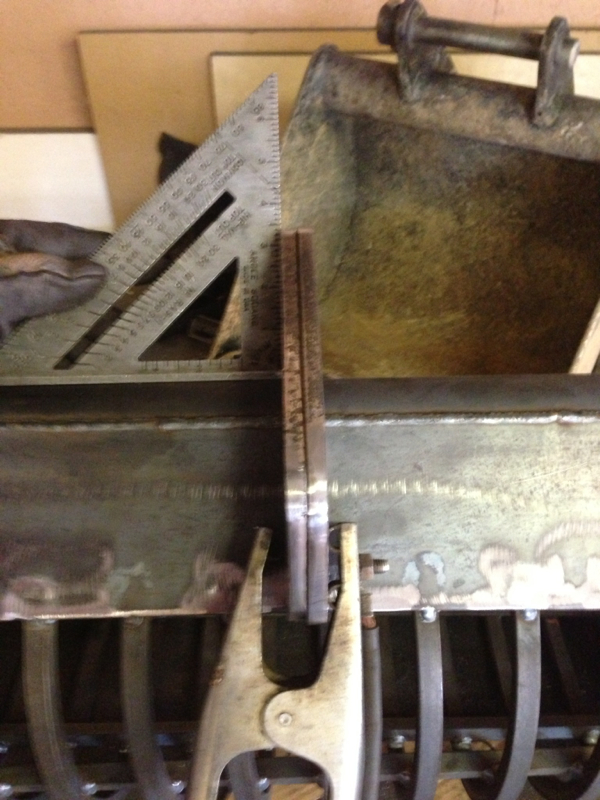

Centred the mounting points and tacked them in place.
Lots of tacks and constant checking to ensure they are square.
Welded solid.

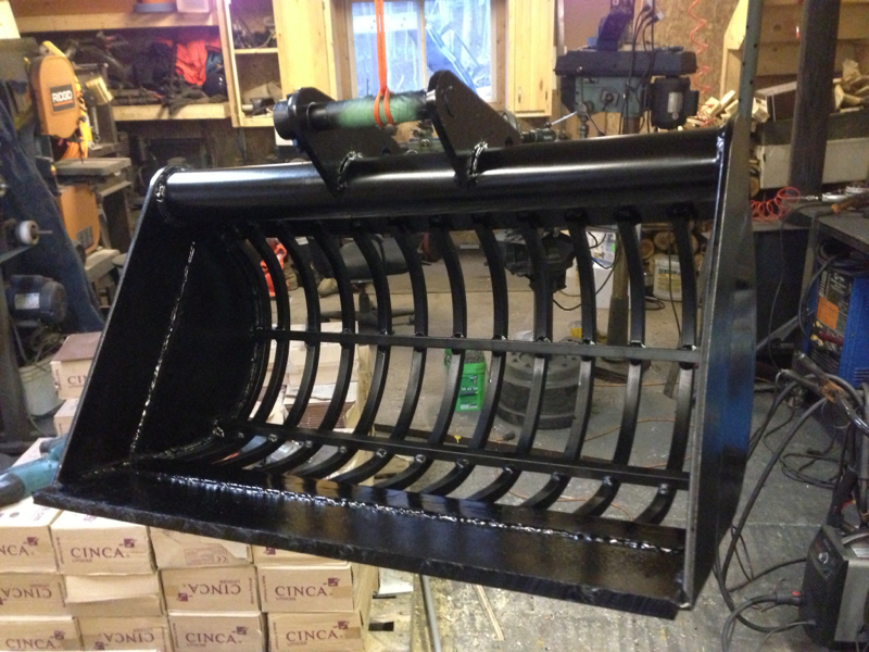

The finished skeleton bucket. Just needs a coat of paint and she's ready to screen dirt.
Coat of paint on it tonight and tomorrow I will add the teeth and try it out.

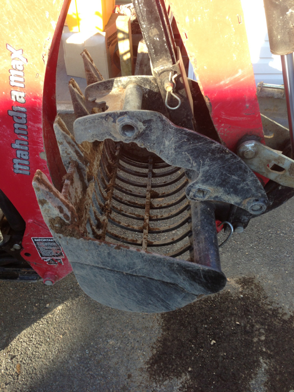

Teeth were added and I tried it out in some old sods that my neighbour had in his backyard. It works good but I think a bigger deeper bucket would work better
How much bigger would you say it should be? Any pictures or video of it working? By adding a quick attach did you lose any digging power with the backhoe? Nice bucket, you do good work. :thumbsup:
#16
I would make it deeper and a little higher so you could have some extra room to shake the material, the width is fine. The quick coupler works great and I have not noticed any lose in digging power. The coupler only adds a couple of inches of reach.
