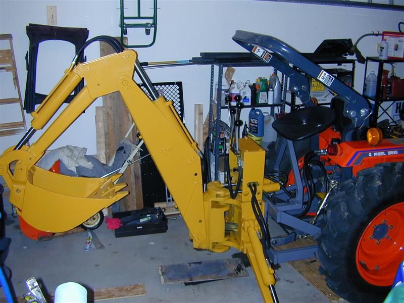

I have a 3054 and being the type to go the hard but cheap route I found a used Gulin (Chinese) backhoe and made a subframe for it. From my research this hoe is very heavy. Somewhere near 1200lbs and my subframe is probably around 150lbs. From the specs I found mine should dig around 7' deep but I really only will need to go around 5' to get below frost line here. I was told it is the closest to the current Gulin LW7 specs. It has a 16" wide bucket and its cylinders are huge. Its big but my tractor 'seems' to handles it very well. I have a Bulher loader.
Yesterday I tried it out for the first time and I dug a 4' hole in very little time. Thought about what could be buried in there then filled it back up. I had looked at Kioti backhoes, and a few of the well known American BH's. I then had considered building a hoe from either Cadplans or CDP. But I don't have the time and the cost for those kit build units would be more than what I have in this thing because of the outragous price increase in steel.
The picture kind of makes the hoe look short and fat. But when extended it does goe way out there. I thought I would mention this simply because of the weight of mine.
thx
Jim

I have a rhino 7.5ft. on a LB1914 and have over a 100 hours of digging with backhoe without a problem. a couple of times ive put 250lbs in the loader bucket to lift 30 inch pine stumps out of the hole. It is also very sandy where i live so its easy digging. The 3054 is a 1000lbs heavier i think it would handle 85. You have to use your head when digging you can hang the tractor strait out in the air with the backhoe it puts alot of stress on the subframe WART
