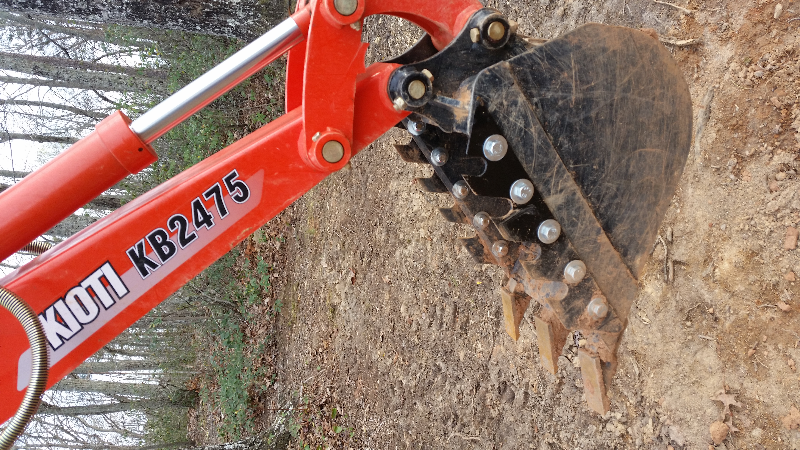

My little Kioti backhoe has a tough time with some larger roots as do most compact machines. I didn't want to have to change the bucket out and put a ripper on and take it off. Now I can just saw through the roots, or weaken them enough that the backhoe can break them. Thicker steel would be nice, but this is what I had.

I like that! Chew at it for a little while until its weakened, great idea.
Could make it from hard steel, such as a blade edge. Seems like it could be designed to clip o to the bucket edge, and just one bolt or pin to retain it.

An old blade edge would be great to use as long as you can cut it. I only had hand tools to use. It works better than I thought, but I will probably use thicker steel next time.

Like that idea. I'm even lazier, I have 2 chunks of flat bar notched out, I push the pallet forks together, tack weld to to the forks. Then you can dig and push the forks into the ground ripping the roots loose. Work your way around the tree then just push the stump over. blow the welds off with the torch grind it smooth. In my case necessity is the mother of invention. Didn't have the hoe when I came up with it. Got the hoe, tied it, fork method still faster. Makes less of a hole also.

Good Idea I guess. You said little machine, I see way more time unstucking that than just getting into the hole with a sacrificial chainsaw blade and cutting the roots loose.

I have tried both this and the chainsaw, and use both. On roots less than 6" in dia, using the teeth on the bucket is way faster. Larger than 6" and I may as well climb down and cut them with the saw. Chain only lasts for about 4 cuts in my soil here. Carbide chain is too expensive!
