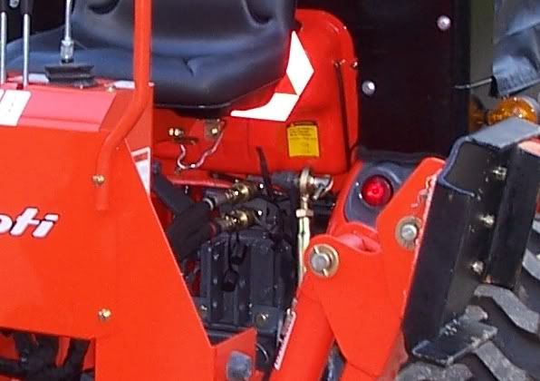

BACKHOE HYDRAULIC QUESTION
Does anyone have a backhoe attached to a CT235, 230 or 225 using the standard selectable A - B rear remote hydraulic connections? My dealer told me that this is the hydraulic configuration for the standard Bobcat (Rhino) backhoe. He also said it's good for Top & Tilt.
I'm used to one output hose from the tractor, which goes to the input of the hoe... and a return hose from the hoe to the tractor.
If I have "A" selected as the output from the CUT, will the return hose from the hoe connect to the "B" connection on the CUT?
This is the only thing I can think of, but "A" and "B" are both selectable as output sides.
Thanks

   / BACKHOE QUESTION #6
Thanks Dmace. I presume that while using the "B" selection as the cut output, the returning hose from the hoe connects to the cut "A" connection?
I'm a little confused as to the question but there are two quick disconnect couplers on the back of my tractor stacked one on top of the other. Now while in the "A" position one of the couplers (Top for example) is the pressure line and the other (Bottom) is the return, now if I put it in the "B" position then they just switch so that now the Top is the return and the Bottom is the pressure line. This is why it's good for a dual acting cylinder such as a top-n-tilt for 3pt attachments.
In this picture you can see the rear remotes and the zip ties on the lines.
click thumbnail for larger image

Thanks Dmace. You just answered my question. I wasn't sure if these two lines were both output lines or if one worked as a return depending on the A or B selection. Appreciate the photo. I can see the red tie you were talking about; good idea to avoid confusion.
