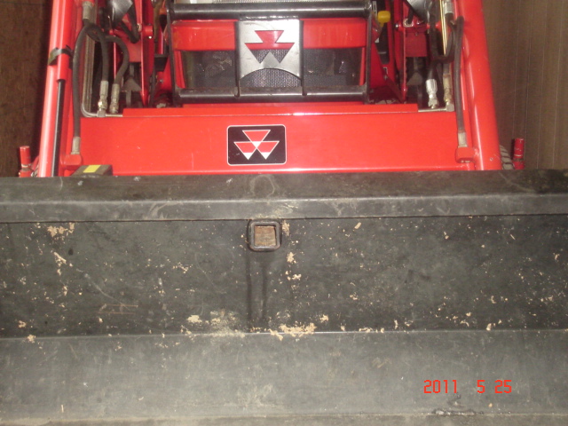

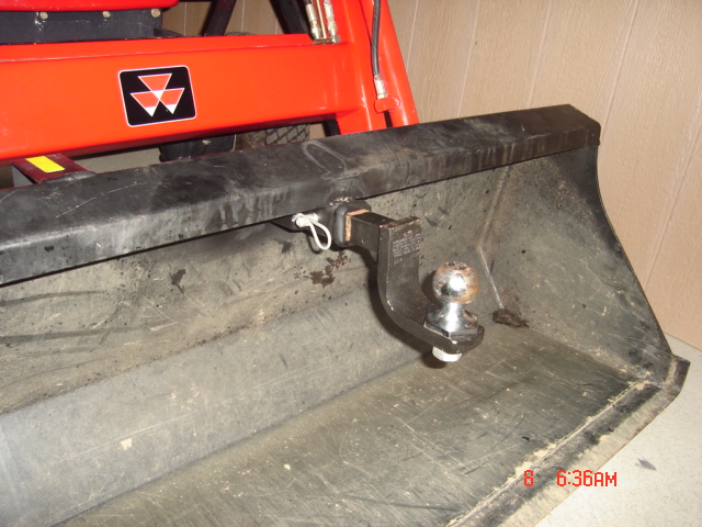

I have a 1-1/2" receiver hitch on my FEL. Works very well.
It's welded under the upper lip, reinforced with a piece of steel webbing. (Another great idea is to weld some chain hooks onto the top of the FEL lip!)
   / Backhoe on, can I still tow? #9
View attachment 460440View attachment 460439
Just curious why you'd choose to put the receiver inside the bucket instead of on top of it? Wouldn't it reduce what you can fit in the bucket?
   / Backhoe on, can I still tow? #10
His arrangement allows him to get the ball lower to the ground. A top mounted hitch might not lower enough to hook up to a heavy tongue weight trailer without some hernia inducing lifting. The amount of space that a 2x2 inch hitch takes up is negligible. The only problem I see with that is perhaps getting the receiver hitch filled up with mud and having to clean it out each time before use.
