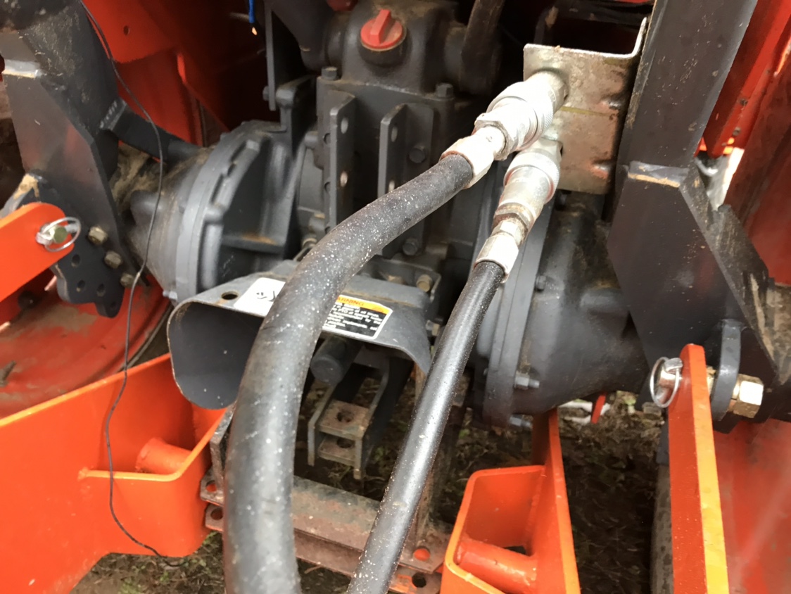

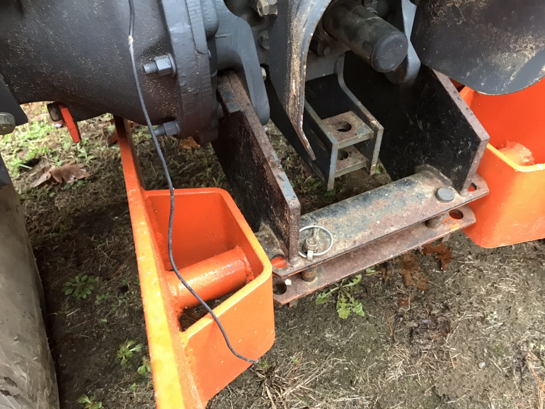

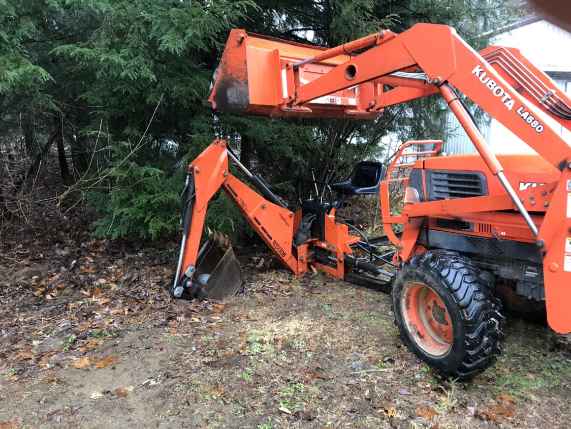

I just bought a Woods 7500 backhoe used with a subframe.
It came off of a Kubota L3600.
Does anyone know what brackets or pictures of the mounting pieces to install this on a L3301?
I did get a couple pictures of the gentleman ‘s setup that it originally installed on(he went bigger) but can’t match those up with anything for a l3301 on the web.
Thank you
Lenny

Who made that subframe? The one on my Kubota L3240 was much beefier.
   / Backhoe mounting brackets for L series? #3
You should be able to contact Kubota and purchase the backhoe subframe for your tractor without needing to buy a backhoe as well. The subframe should be able to be easily modified to accept the Woods backhoe.

I recently bought the same backhoe except mine has it's own pump and tank. Luckily mine came off another 2850 so all I had to do was make a couple of the smaller brackets. You dealer will have pictures of everything you need to mount it up.

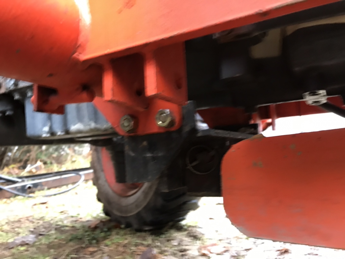

I spoke to Woods and a local dealer and got a bit more information. It appears I have a model 9629 subframe. The 3301 calls for the different type that looks like two plates with one going up each side and a 4 point pin hookup in the back.
Trouble is that the earliest ship date is Feb 2019 and 1500 bucks plus shipping.
That would go a long way toward that plasma cutter from hyperthermia I’ve been eyeing!
I think I will use what I have and make the brackets I need. It looks straight forward with the exception of finding a piece of heavy walled tubing for the rear bracket support.IMG_0038.jpg the piece under the drawbar.

I'm all for buy tools but for that rear mount piece it may be better to buy it and build the rest. I was lucky and that was the only bracket the guy managed to save with his.
https://store.germanbliss.com/woods...nt-sub-frame-mounting-kit-9265-assembly-parts
Part 6 is what you need? I had to make parts 6 & 8.

It looks like I'll need to make 3 parts. Yours says Model 9265 while mine for some reason says 9269.
https://store.germanbliss.com/woods...e-mounting-kit-9269-for-kubota-assembly-parts
It says that there is a length difference of the main frame but the brackets have different part numbers so I assume different widths were made to accomodate the different tractors.
I would rather buy that rear piece but not sure if it's available for a 3301. Can you measure what thickness of metal your vertical pieces and round tubing of that rear brace is made of?
