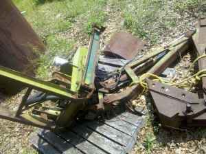

Does anyone recognize this back hoe? I am wondering if it will fit my 2020D

It looks as if it came off a YM155D.

Cripes, and I thought my old limegreen backhoe was a beater! But that one really takes the prize.....it's in really tough shape. Is it complete? Got anymore pictures? I see a couple of hoses, but no reservoir or pump. Or seat. Yanmar did sell a few in that color made with the odd open frame and the weirdly curved bucket like that one. One unique feature was a chain drive for the swing movement. Yanmar made it to fit the YM155 and 195 back in the 1970s/early 80s. If it's a 3 pt it ought to fit your 2020.

This is the only picture I have ....I found it online and for sale. I have traded emails back and forth with the owner but its like he has classified information and I don't have clearance. I do know that it is not a 3pt..so I guess its not a bolt on for my 2020

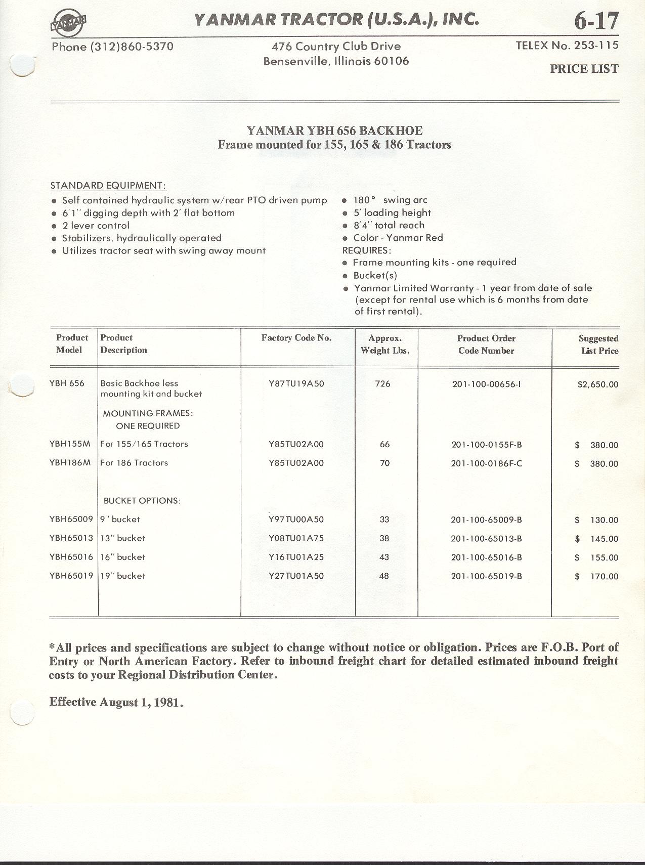

Here is the old spec sheet and also the price list. I've also got the manuals if you decide to do it. Frankly, that picture that you showed makes me wonder if you might be able to do better with just about anything else. But I know how BH envy feels. Had it myself until I got my hands on an old YBH600. Absolutely be sure that this one has PTO hydraulic pump and reservoir or that your 2020 has hydraulic flow for remote attachments. THe PTO pump new probably costs more than that rusty BH.

The ad I found didn't even have the picture... I traded some emails with him as well, he said it came off a "1500D, 4 wheel drive yanmar, 2 cyl." and that's about all I got.
It doesn't exactly look like it would be easy to attach and un-attach from the tractor.
