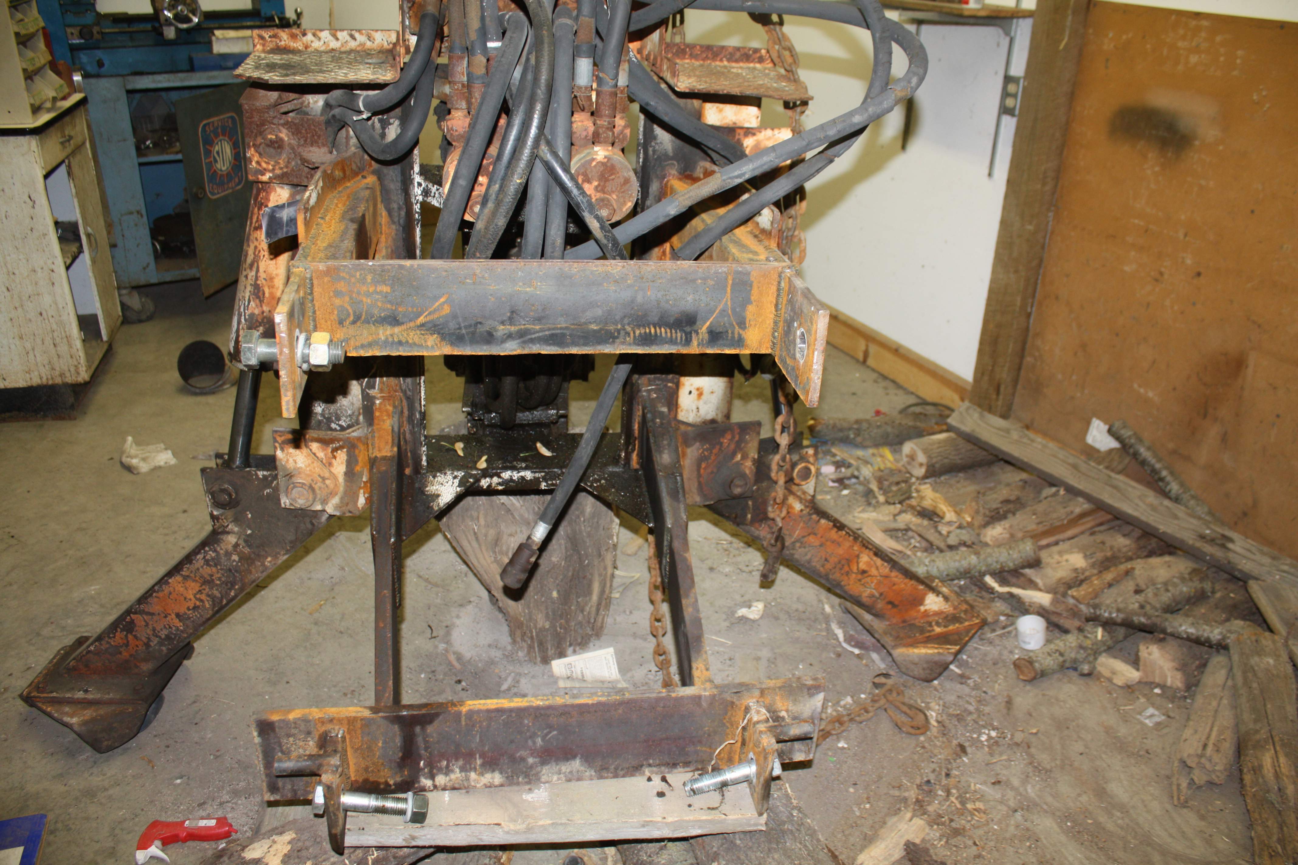

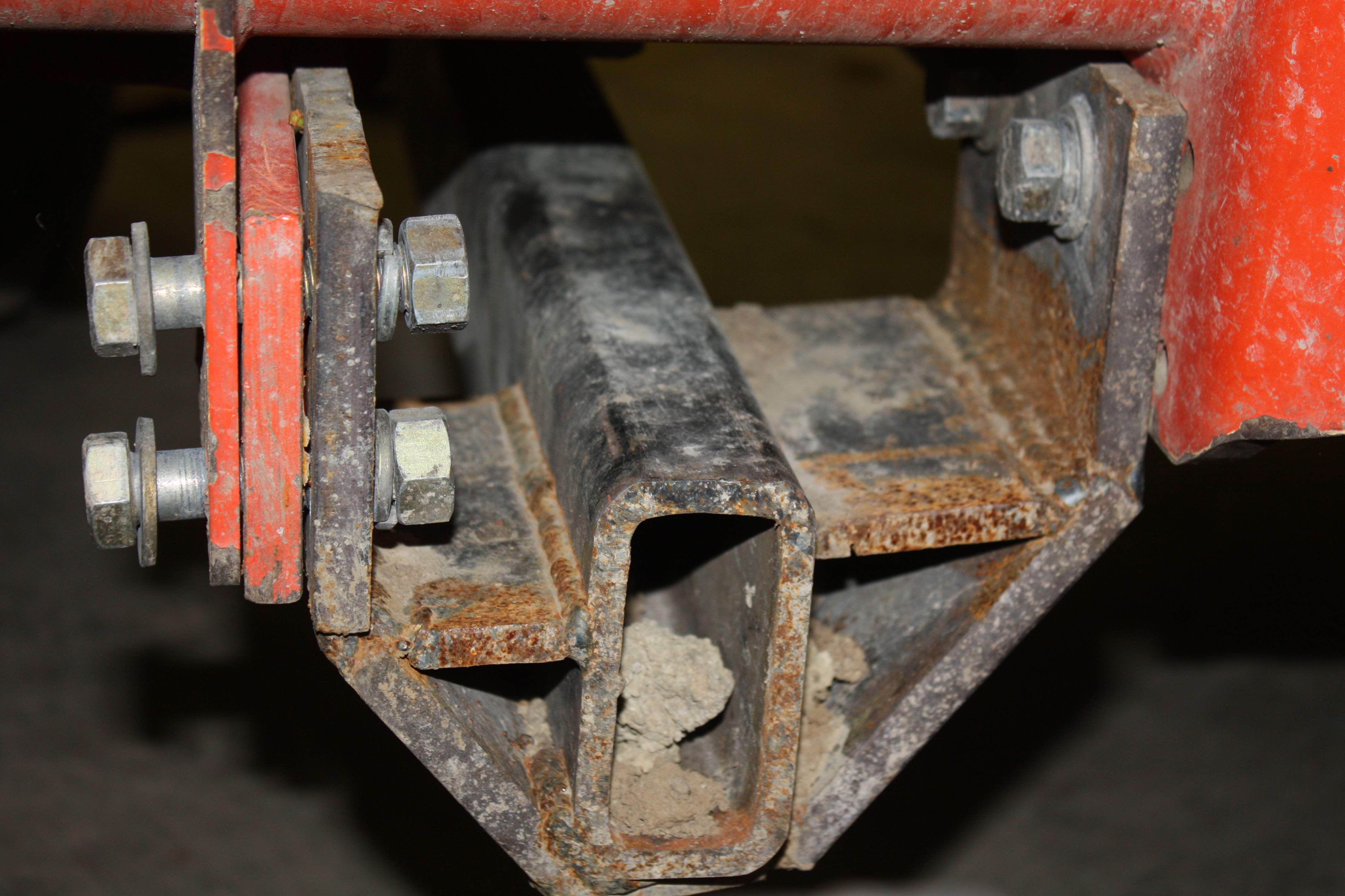

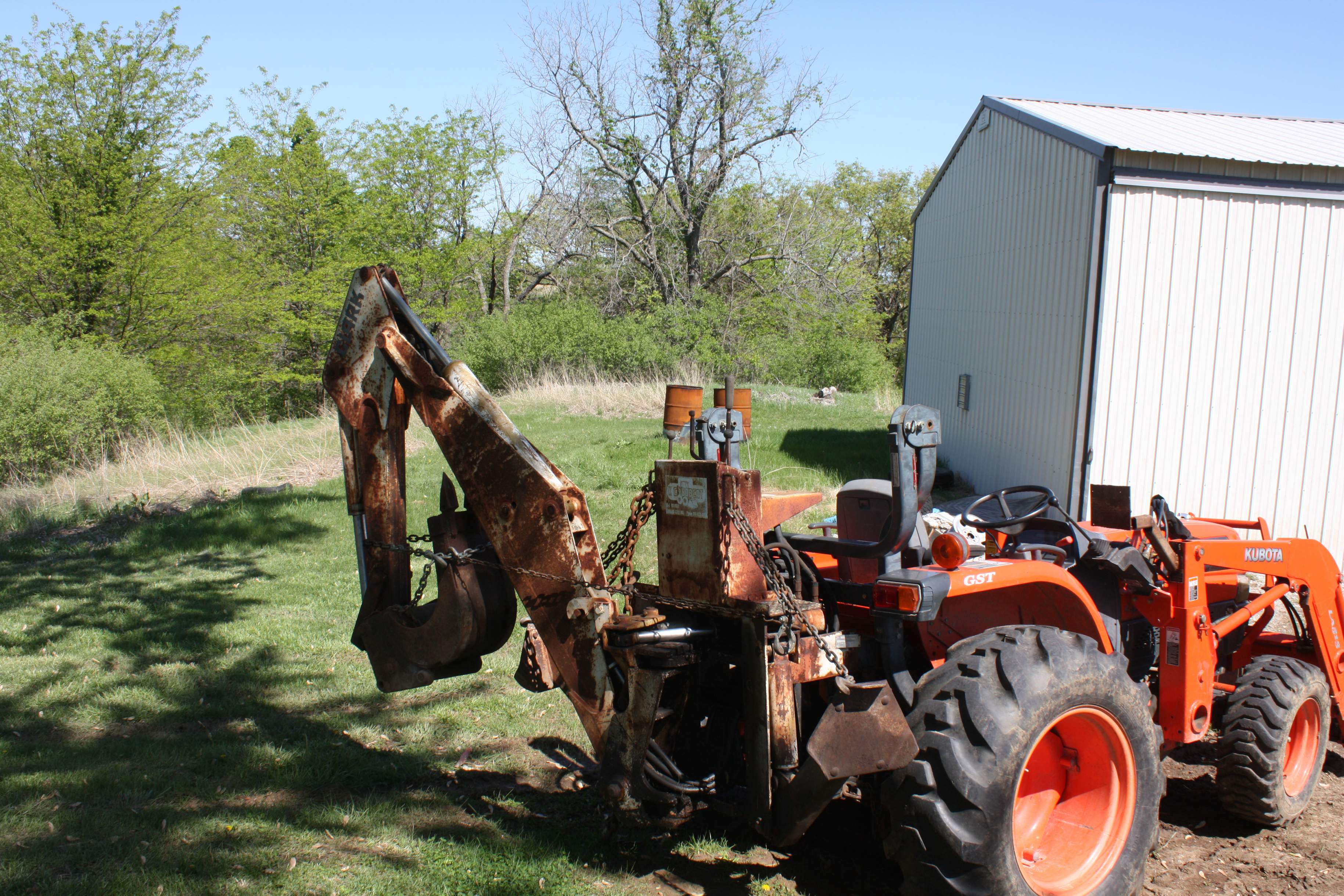

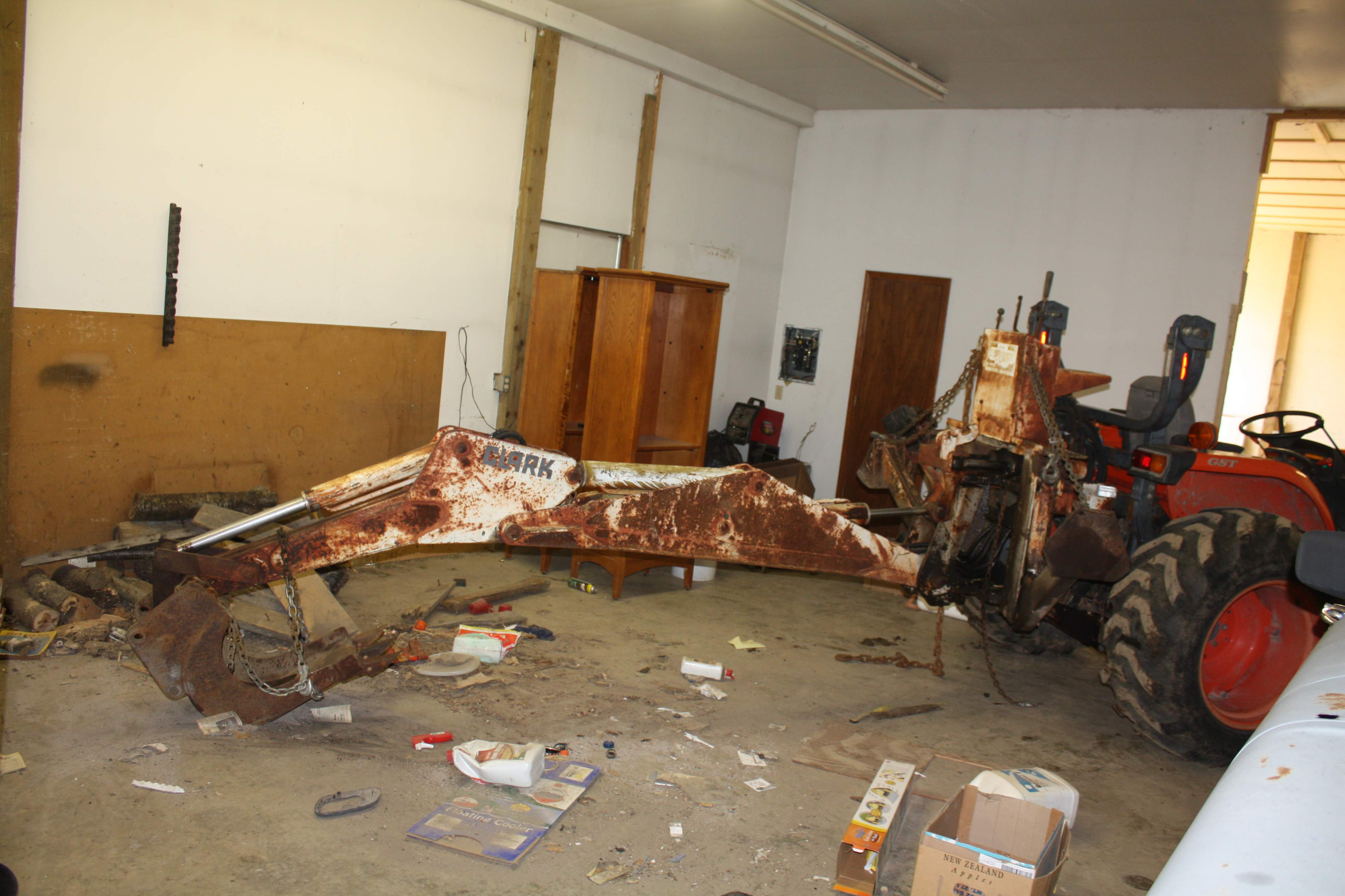

anyone know anything about a older bobcat backhoe unit got it mounted on my kubota 3130 had to custom build a sub frame for it,trying to figure out which way to do the hydraulics pto pump or run them off the tractor,dont want to bypass the safety switch if i can help it and it kills the tractor if you get out of the seat in gear or pto running.

the pto pump i bought was one off of a old international tractor it had a 3 gal tank i believe it was a farmhand pump and motor ,not sure the gpm the tractor puts out would the tractor have enough cooling for it to be hooked to the hyd on the tractor to run it .the backhoe is probley a little big on the tractor but its heavy duty i got a 12in and 2ft bucket with it already had a thumb to put on it from my last backhoe,the back hoe is set 2ft off the ground for ground clearance set it up so i could put a 4 ft mower deck on the hoe later to do my ditches i cant do now
   / backhoe hydraulics
made the mount as close as possible ,it does good you can get on a grade and turn go up a hill and it still has good balance ,not alot of room for the tank and pump im gussing it puts out 8gpm i had a 700m bobcat skidsteer and this fit on it put out 10 gpm might be slower but for my own use it will work.my kubota book says pump capacity is 8.3gpm not sure at what rpm
