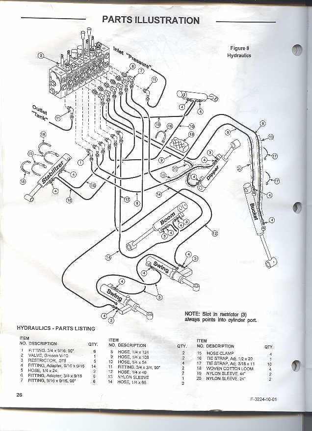

My New Holland 759C backhoe is giving me some trouble. Basically all the funtions work fine. The problem lies when you trying to pick up something heavy and hold it there. You can see it better and more controled when you try to pick up the rear of the tractor, or at least unweight it. The only circut effected is the boom cylinder. The curl and dipper work fine, at least they seem too. When you try to unweight the rear of the tractor and go as far a the relief valve lets you and put the control stick in its neutral position you can see the cylinder "leaking" down. I have checked for external hydraulic leaks and could not find any. So it seems that the possibilities are: the cylinder has an internal leak, the spool valve is leaaking by, or the relief valves are not fully seated (small peice of dirt). Does anybody have any ideas as to what might be going on? Are there any steps that can be taken to further diagnose the problem? The backhoe is only 2 years old. Attached is a diagram that I have with the operators manual. The spool valve that controls the boom is #39 which is on the right side of the diagram.
As a note this problem may have been present ever since day one.
Thanks for your help!

A couple things come to mind. If you were getting oil by the piston on a single acting cylinder, it would be easier to detect, as you would most likely have external seepage. I'm guessing this is a double acting cylinder. It is possible that the piston packing is blown.
Also possible as you suggest, is the relief could be sticking, or the spool could be leaking. Both the relief system and the spool system can pe presurized to test the valve seals. I'm also guessing that you are not a hydraulic mechanic, and probably dont have a hand oil pump setup to test pressure on the relief or the spool. If you did, you could also test at what pressure the relief pops at. If you have an air compressor, ( even a cheap tire pump style may work )pressure gauge, and feel like rigging up the proper fittings, the test should be telltale if either of the valves leaks <font color=blue>significantly<font color=black>.
Disconnect enough lines to isolate that section of the spool, and pressurize one side of it, gauge inline.. see if it holds pressure. Try the other side as well. Dissconnect the input to the relief and pressurize it.
Use due caution, etc, etc ( standard liability warnings ) when using compressed air, etc. And keep in mid that you are introducing air into sysstems that will need to be bled, etc, etc
You may even be able to test the cylinder the same way.. but only if it has a fairly decent leak... I'm not sure what pressure that it is taking to make the seal fail.. but you probably don't want to try to develop it with air pressure, if it is very high. ( If it won't leak with <50psi of air, I'd take the cylinder to a hydro shop for a test.
Might try disconnecting the oposed line to the double acting cylinder to see if you are getting any flow from it while engaging the other side, and vice versa. Be carefull around presurized fluids as well. If you don't feel 'safe' about these ideas, it might be a service call thing.
Pay close attention to your plumbing, possibly label the lines if it helps. Keep in mind how the flow diverter works in those spool valves... many are constant pressure, and will make it difficult to check while live and attatched.
Just a few ideas, I'm sure others with more experience will chime in with other goodies.

My approach would be to examine in the hydraulic fluid for foam and or water. Then I'd full stroke that cylinder a few times to vacate any air or other problems (those cylinders get hot and can evaporate water leaving an air pocket). Since you're loading the cylinder from two directions with the same result, I'd say the leaky spool or packing is the most likely outcome. Swap hoses to another spool and see how it behaves, then it's either the spool or the cylinder! Or if you're real lucky, loose fittings!/w3tcompact/icons/smile.gifSteveV

Not good news /w3tcompact/icons/sad.gif. Took the fitting of this afternoon. I got fluid coming out both the fitting on the piston and the hose. The hose is pushing more fluid than the cylinder fitting. Called the dealer, he was closed (it was Sautrday at 3pm). Will call Monday moring first thing to report my results to him and find out what the next step is.
I will keep everyone posted.
Does anybody have a fluid diagram for this backhoe NH759C?

I have a 757C diagram, not sure if it is the same. I would be glad to email it to you if you like. I would have sent it but did not see an email address in your profile. Let me know.

Here is the diagram.

Thanks. Its not exactly what I was looking for, But it did give me an idea of where the hoses run which I did need to know. I was looking more for the flow of fluid through the valving for a given funtion. I don't know if a fluid diagram like this is available. In my profession you can get fluid diagrams of automatic transmission (for the different gears)to isolate a bad component before breaking down the transmission. I was hoping a fluid diagram would help isolate a component in valve body.
The diagram you attached does help me.
