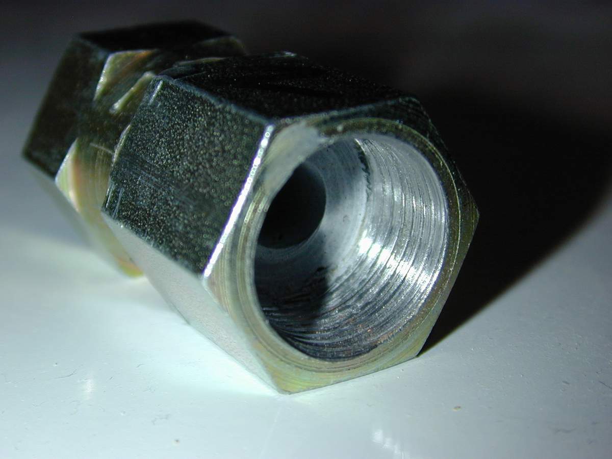

Update on the fittings.
I made 4 adapters using these from Surplus Center.
http://www.surpluscenter.com/item.asp?UID=2005030306530510&item=914&catname=hydraulic
I drilled them out to 21/32 for the 18X1.5m tap. Then used JB weld to fill them to the apropriate depth. Then machined the JB Weld to a flat surface for the O-ring to mate against. And drilled out the centers.
So far I have installed 2 of these Rube Goldberg fittings. And tested the backhoe. They are on the push side of the main cylinder. They did not leak. Got to say that JB Weld is some really fantastic epoxy.
thx
Jim

   / Backhoe hydraulic fitting
Thats probably not too out of line for the price of custom fittings. Considering I spent $65 for 2 custom hoses with some fittings to make a tilt cylinder. These are $1.50 each. Then probably .75 for the JB in each one. They are just a trial and error to fix mine.
thx
Jim
I consider my fittings "properly done" because they work and don't leak and I didn't pay alot for them.
