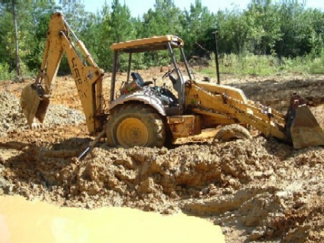

The real problem with working along the edge of a pond is getting into position and dealing with the mud.
The hoe will only go aproximately 180 degrees. You have to line up your tractor along the side of the shoreline so you can get the material away from it.
Then it will run downhill to your tractor and creats even more mud. Removing those mud piles is another thread all together, but getting unstuck is something you'll have to get real good at.
If you haven't learned to walk your tractor sideways with a hoe, you will have to learn this. If not, you'll need a dozer.
Get the backhoe anyway. It's something you'll always enjoy using and find dozens of things to use it on.
