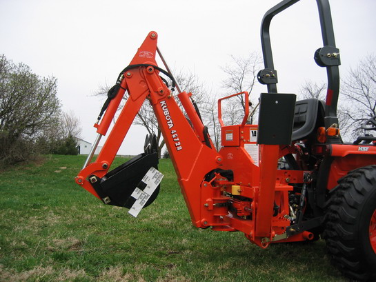

I have a B7610 w/B4672A BH. Yes, it's a 3pt. I considered the Woods BH6000, but found that the Kubota specs were slightly better, and the price was only a couple hundred different. I'm also of the notion that resale of the B7610 will be higher with Kubota BH and FEL. I don't have a MMM, and I've not removed the BH yet, so can't comment on those issues.
   / Backhoe for B7610 3 or 4 point #5
Here's a pic of the BH mounted. Brand spankin' new.
Guess how I removed the sticker. /forums/images/graemlins/smile.gif

   / Backhoe for B7610 3 or 4 point #6
</font><font color="blue" class="small">( Guess how I removed the sticker. )</font>
Oh, I'd say you dug a big hole and it magically disappeared?

   / Backhoe for B7610 3 or 4 point #8
John,
That's just amazing, how'd you ever guess? /forums/images/graemlins/smile.gif /forums/images/graemlins/smile.gif /forums/images/graemlins/smile.gif
Surprised Kubota doesn't mention the magically disapearing stickers as a feature. /forums/images/graemlins/grin.gif
