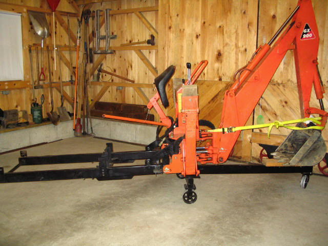

How do you move a 1400# backhoe? Build a B/H dolly

Looks like a real nice tricycle design, do you have any clearance issues rolling the backhoe under the tractor while it is still on the dolly?
   / BACKHOE DOLLY
No! rolls underneath quite nicely.Once underneath,I connect the hydraulic lines to the rear remotes.Once connected,the stabilizers are lowered to raise the B/H up off the dolly.Dolly is then stored in upright position to save space.

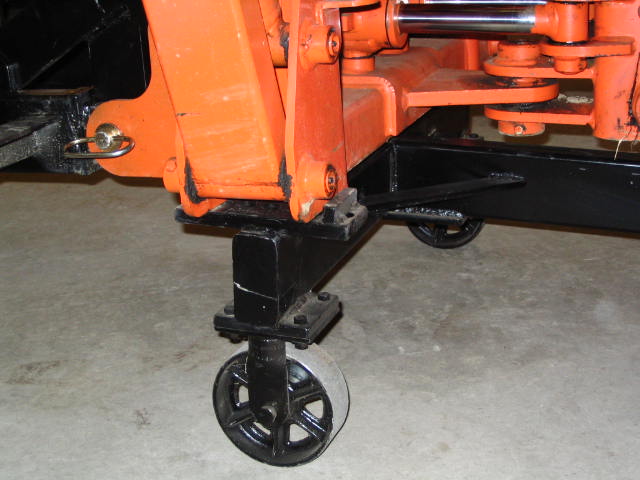

Nice looking set-up. I have a Wallenstein backhoe as well (smaller model) and have been thinking about building a dolly too. Thanks for the design idea. Any chance you could post a few more pictures from different angles? Thanks.

I have a couple more photo's
   / BACKHOE DOLLY
Another picture
   / BACKHOE DOLLY
More photos
   / BACKHOE DOLLY
#9
photos
   / BACKHOE DOLLY
photos -1
