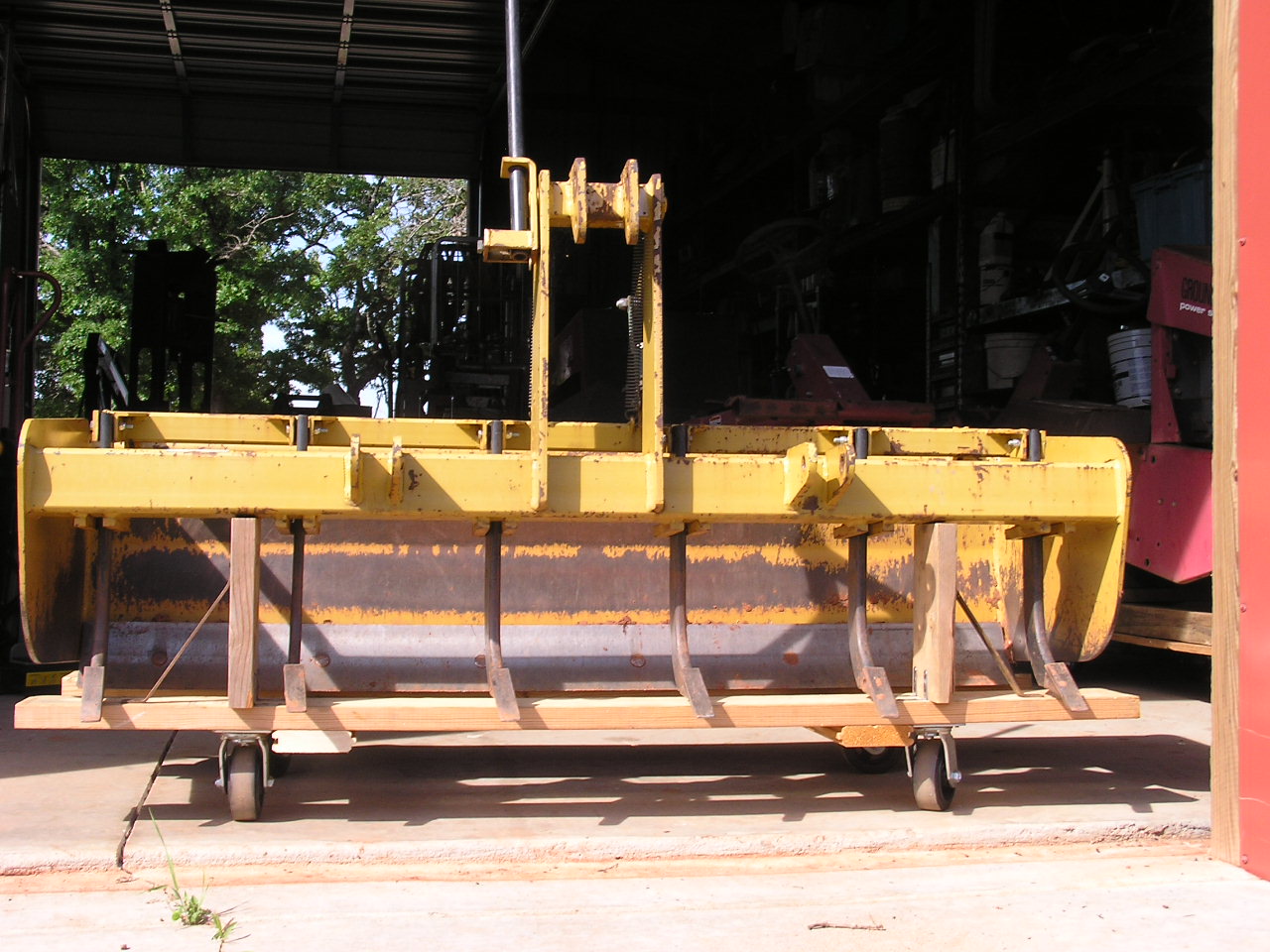

I am looking at building a backhoe dolly for the LB1104 BH on my XJ2025H. I have searched and found several dolly builds for other brands of tractors most of them were for 3PT hitch BH's and a few for subframe mounts.
I was hoping one of the other LS owners had built a dolly for thier BH and could post some pictures.

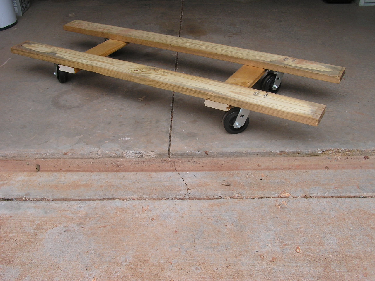

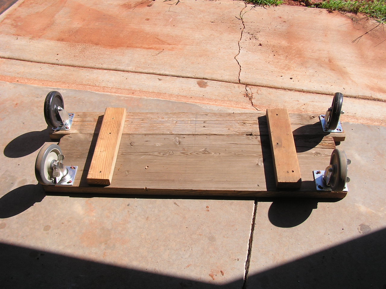

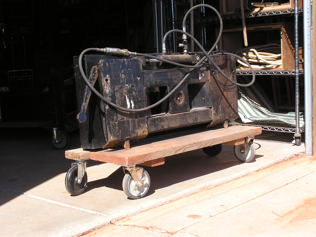

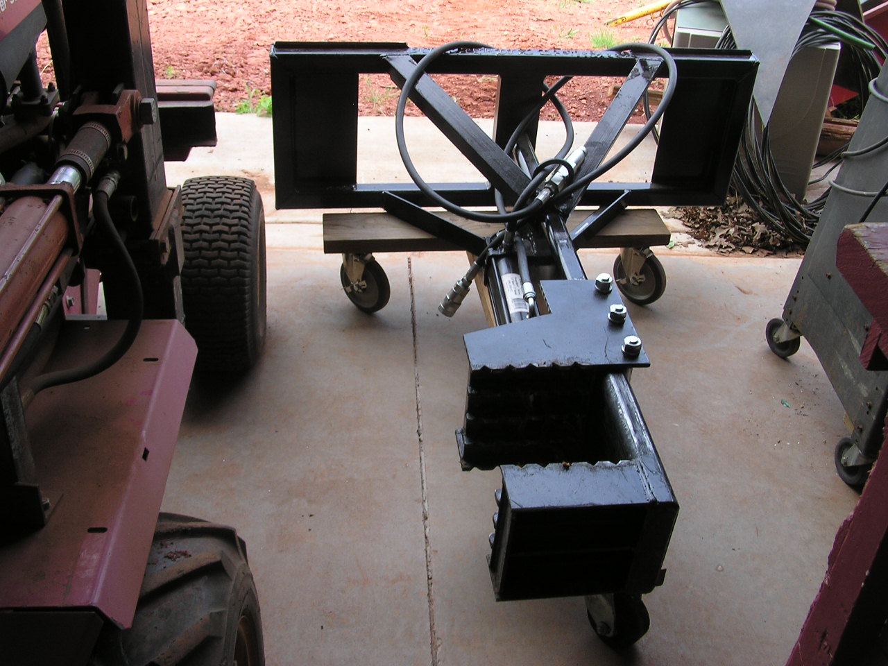

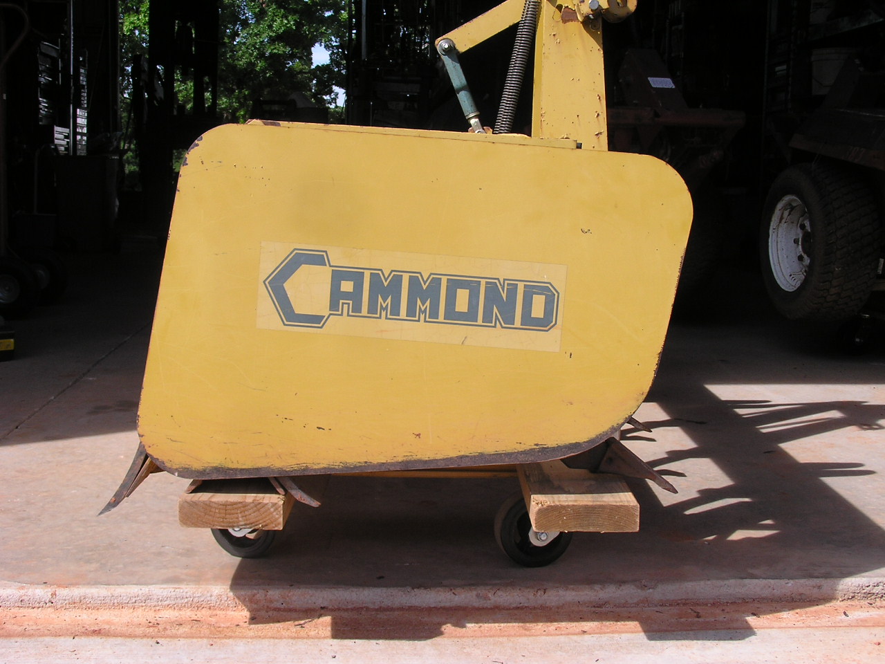

Like you I wanted to build a dolly but found nothing exactly like my hoe and tractor so used what I found as a base to build my own dolly out of the simple T designs.
When I was done I found it was too high so I had to modify it to allow for the hoe to roll a little more so the hooks could disengage. Once I modified it, it works well now. The moral is you'll just have to dive in and work on it till it works unless you can buy something already made.
BTW I got my casters at Harbor Freight. Each are rated at 600lbs. Two swivels and two fixed. I put the fixed casters at the tractor end and the swivels at the bucket end.
6 in. Rubber Heavy Duty Swivel Caster
6 in. Rubber Heavy Duty Rigid Caster
When muscling about a thousand pounds of hoe around on your own you don't really want both ends going helter skelter, ergo the mix of fixed and swivel casters. Easy to move yet easy to control precisely. To reattach the hoe you need a certain degree of control in order to get things lined up.

If you search this board for backhoe dollies like I did you'll find all sorts of ideas. I downloaded many of the pictures for inspiration then based my design from the basic T types. Most are either T or a trapezoid. Be sure bear the weight in mind and the stresses that are put on it when you mount and unmount the hoe. I think most hoes rotate then pivot to clear the bottom hooks so bear that in mind too. I didn't provide enough clearance with mine the first go round and had to modify it a bit.

How much does your hoe weigh? I used four 600 pound capacity casters and my hoe weighs about a half ton or 1000 lbs.
