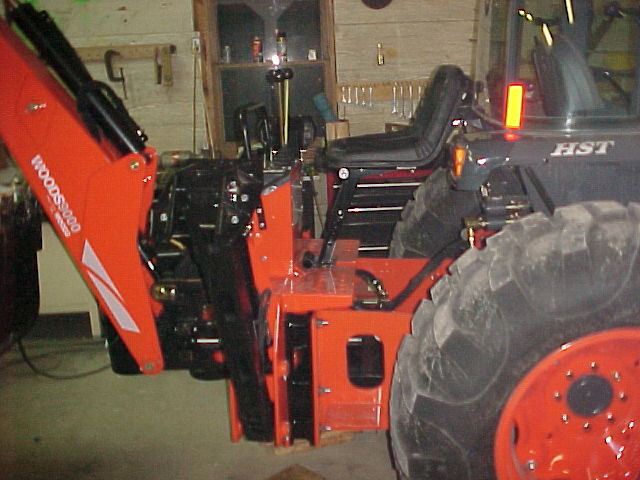

I have a Kubota L 5030 cab model, with a Woods 9000 hoe. works fine with the cab. While useing the hoe there is a seat for it behind the cab. Just make sure the dealer orders spacers other wise the hoe seat will hit the back window.
