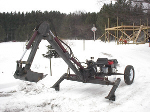

I built a caddigger 821 I'm no expert, but the way it was explained to me is a duel stage will allow you to do two fuctions at once. Like lift and curl at the same time. As to the valves I chose to let them enginer that. My time looking for the right parts if I could figure that out was worth somthing to me. I had alot of fun putting it togather. Used about fifty lbs of welding rod. Works great to. good for trenching and digging stumps ect. Only thing it's not so good at is digging basements. You can't throw the dirt far enough. have fun /forums/images/graemlins/smile.gif

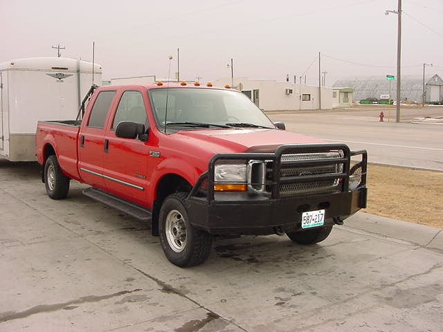

no I just got the plans. would like to get the kit but not able to afford it right now. a bit spendy. I will probably locate most of the metal myself. I can get some at a scrape yard that has a lot of 1/2 inch plate and other kinds for .15 cents a pound. cheap. /forums/images/graemlins/smile.gif already have some extra pieces of the stuff . I designed and built a bumber for my pickup from scratch with no drawings, just what was in my head so I figure I will manage.
