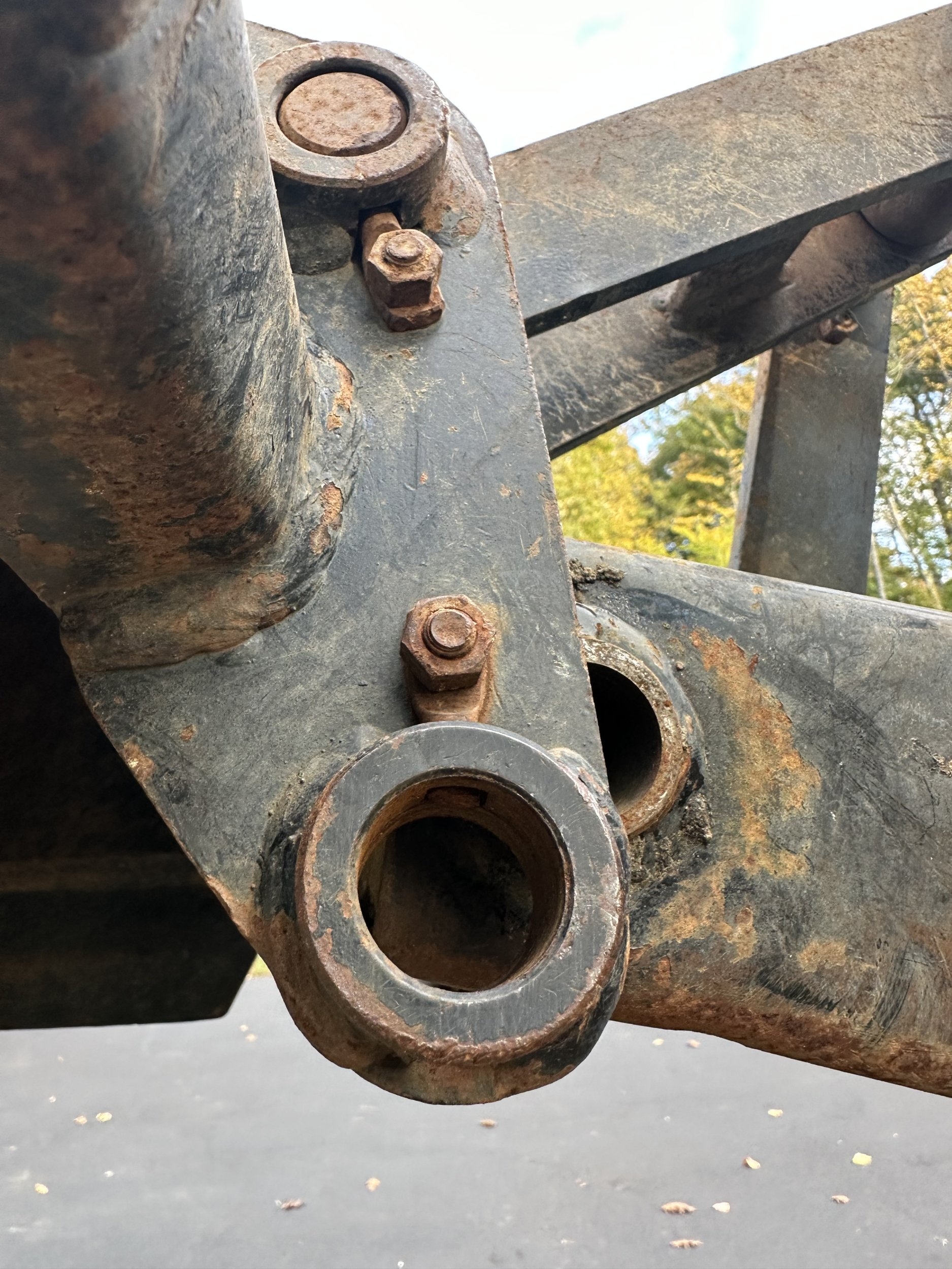

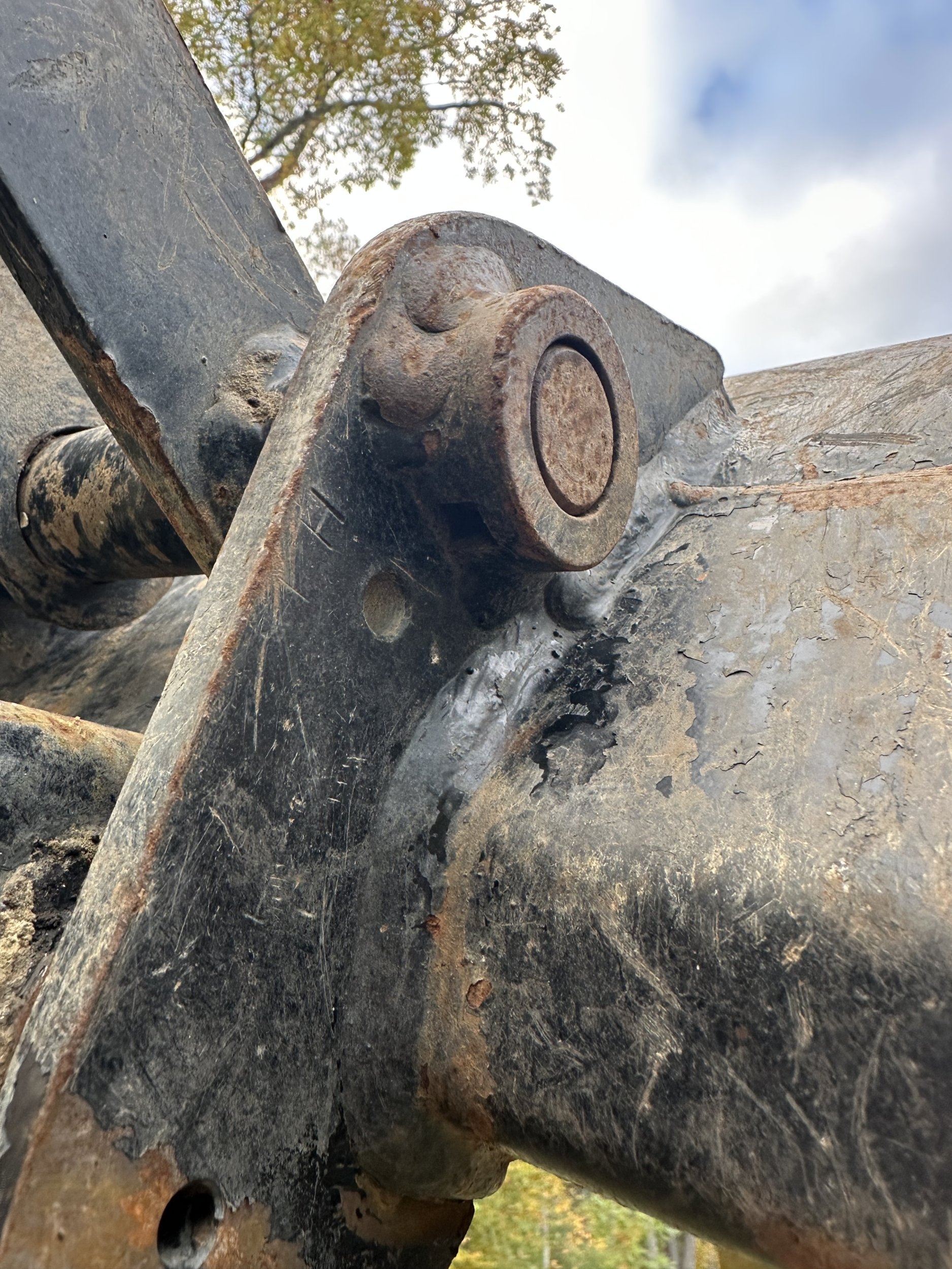

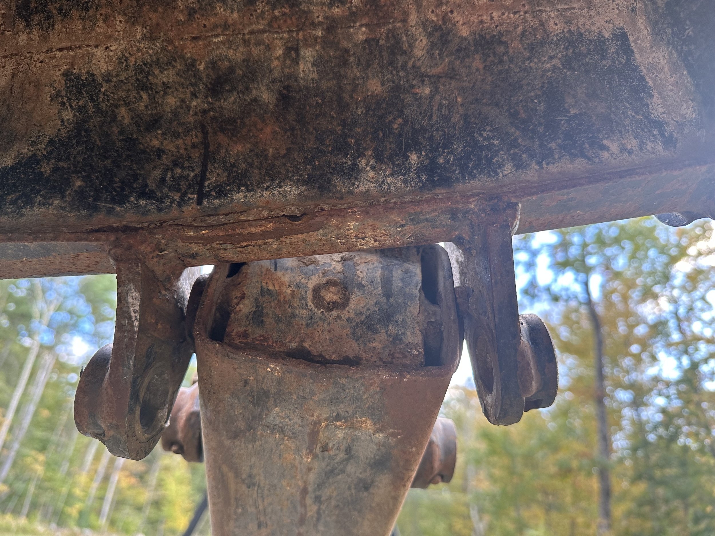

Pardon my ignorance, but are bucket pins fairly “universal”? As you can see, I bent the ears on my bucket and then lost one of the pins on my Bush Hog 762H backhoe (long obsolete). If I get a length from the other pin, or bring the other pin in to my tractor place, will they be able to order one? Or are they really backhoe specific? What about those bolts that presumably go through the pin to hold it in place?

Unless the other pin is easily removed I would be inclined to just take measurements and see if your tractor place can find a match for you. Be aware that the pin is probably hardened so that buying a pin without the hole won't do.

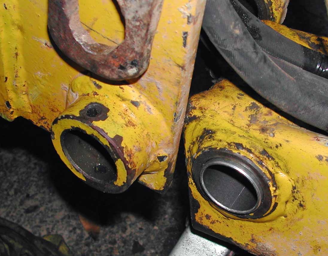

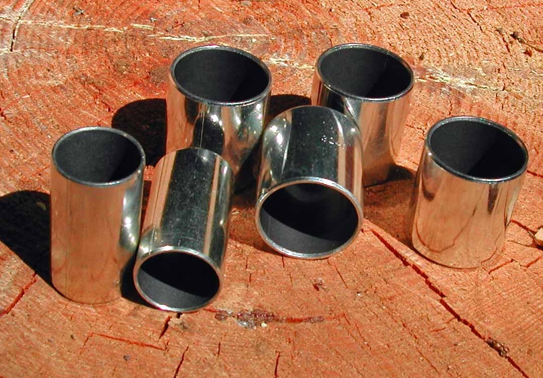

Some pins are hard, some mild steel. Some are drilled down the middle for grease, others are solid. Some hoes use replaceable plain bearing inserts, some don't. Tho inserts are better in most ways, they are not easy to remove, and they can block the grease hole if your hoe is greased thru the tubing and not thru the pin.
Bush Hog is supposed to make decent hoes, so I suspect you have thin plain bearing inserts. I buy them by size online. I suspect your pins are 25mm or 1.00" diameter. I just buy and cut as needed. I have used chrome plated pins, but you have to grind the plating off if you drill them for retaining bolts. Your hoe seems to have a neglected zerk fitting in the tubing.
Here are some pix of replacing the bearing inserts on my hoe.

IMO, from the looks of it, I'd say routine greasing was not in the OP's interest. I just rebuilt an H section for a Case extenda-hoe and it was twisted pretty bad and while I made it whole again, I told the owner it would fail anyway. Once you bend them, it's all downhill from there.
I have a feeling I'll be fabricating an entirely new one at some point in the near future and lightening his wallet quite a bit as well.
Far as pins go, don't have a clue what 'stress proof' steel is
Most likely you can buy the correct diameter bar stock from any steel supplier and use that so long as there isn't any bushings in the failed weldment or the failed weldment is 'ovalled' out, which I suspect it is from the looks of the neglected grease fitting and if they are, that is a whole different ball game.
