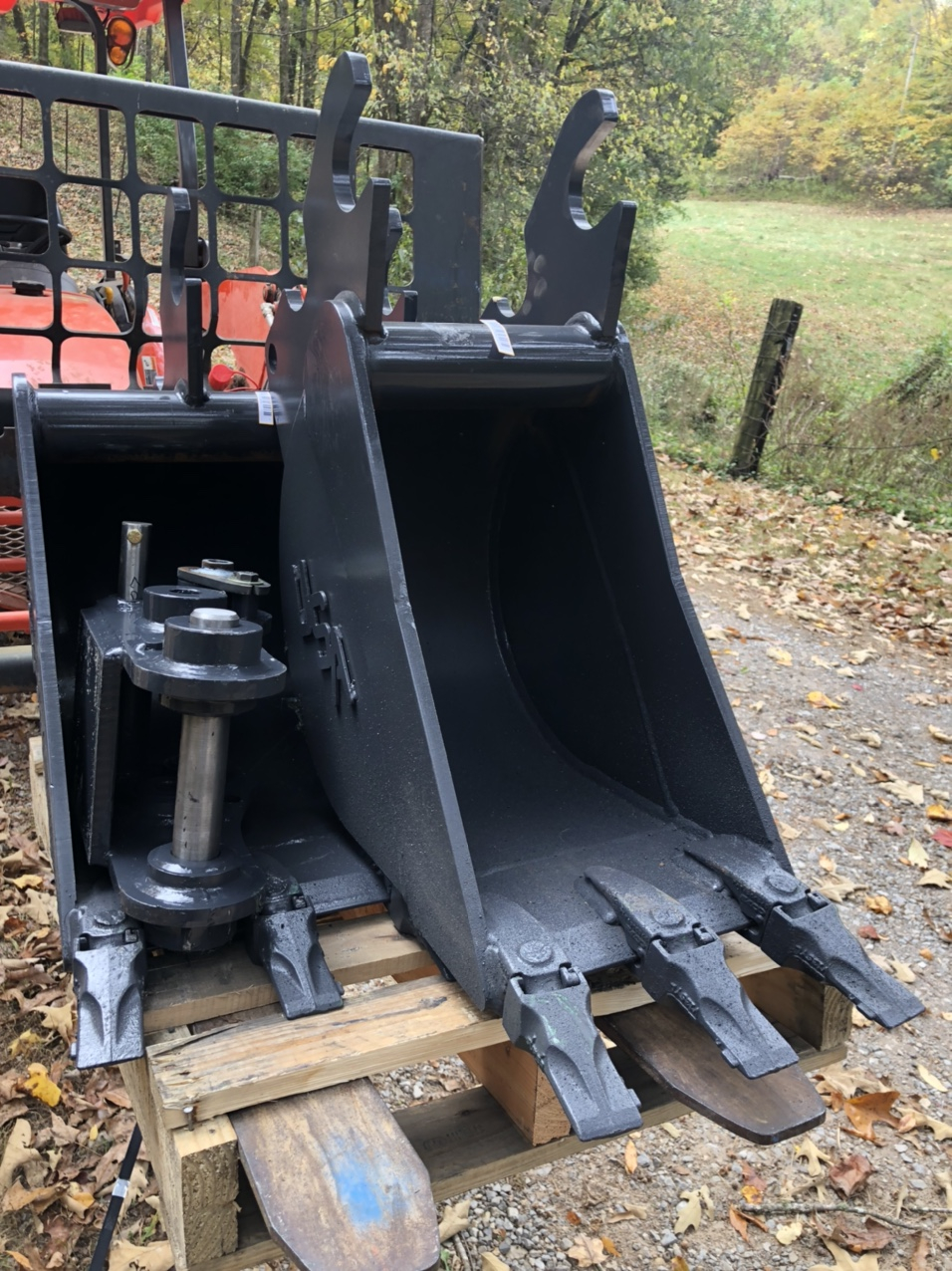

Two modifications ideas considering for 12”backhoe bucket.
First, sharpen and cut serrations in the side cutters to better cut/saw/break thru tree roots. Some single tooth rippers have this feature. Side cutters are AR400 1/2” steel.
Second, weld a swinging 1” D-ring to top rear of the bucket instead of a hook to attach rigging. Narrow buckets tend to plug more easily. Shaking while the D-ring hammers the back might help loosen stuck material?
Haven’t seen these features so there might be good reasons not to.

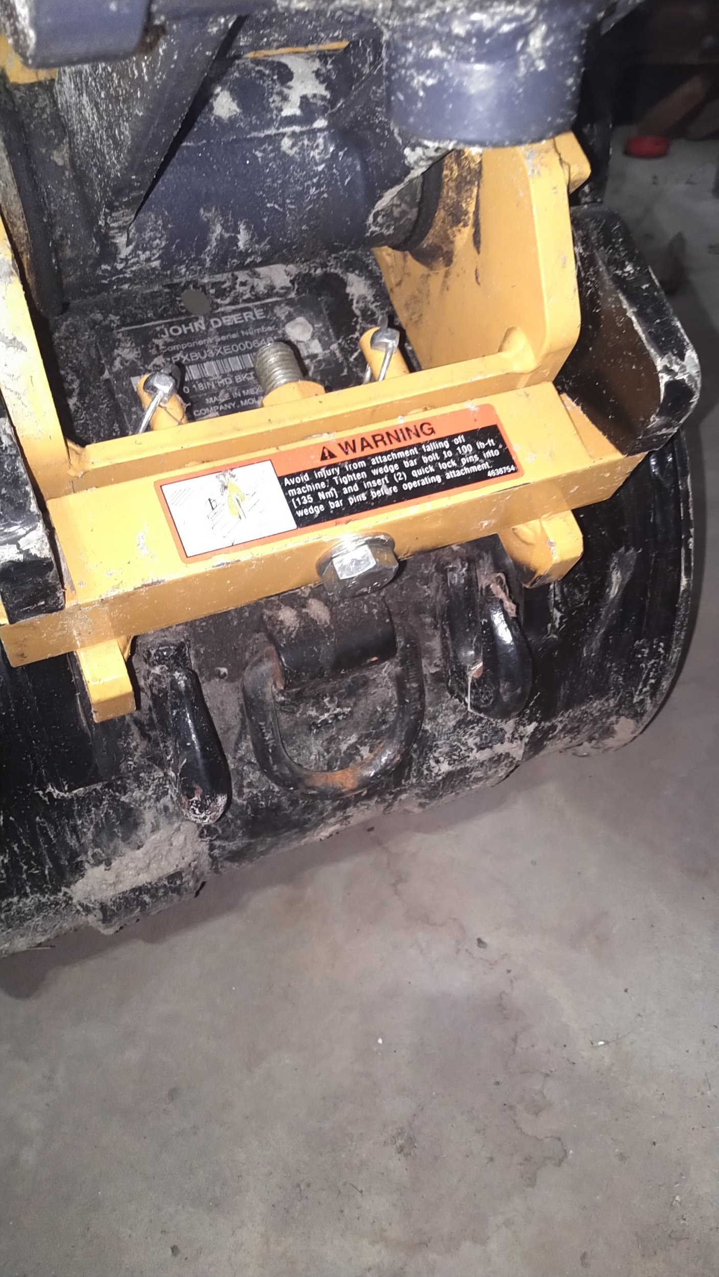

How about all of the above lol I'm a little careful about side loading the bucket pins however you can easily loop a chain through a d-ring probably not OSHA approved. anyway if you weld hooks on make tack it first to make sure the chain links will clear everything.
