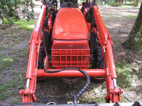

I added this one to my bucket recently. The chain you can see in the photo predates my owning a welder; not as handy as the hook 'cause it has to be so short to stay out of the way that it's hard to hook the chain.
I had to cut away part of the clevis on the hook to get it to be flat enough on the plate for my amatuerish welding.

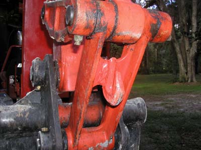

Walt, I welded on a 3/8" clevis grab on our L-39 in the exact same place shown in the photo attachment of the excavator bucket, works great.

Hey Walt, here's where I welded on a 3/8" clevis hook onto the L-39 backhoe.

   / BACKHOE BUCKET HOOK LOCATIONS #8
Here's another pic. It works great in this location.
   / BACKHOE BUCKET HOOK LOCATIONS #9
Whoops, posted the wrong pic, here is the one with the BH hook. /forums/images/graemlins/blush.gif
