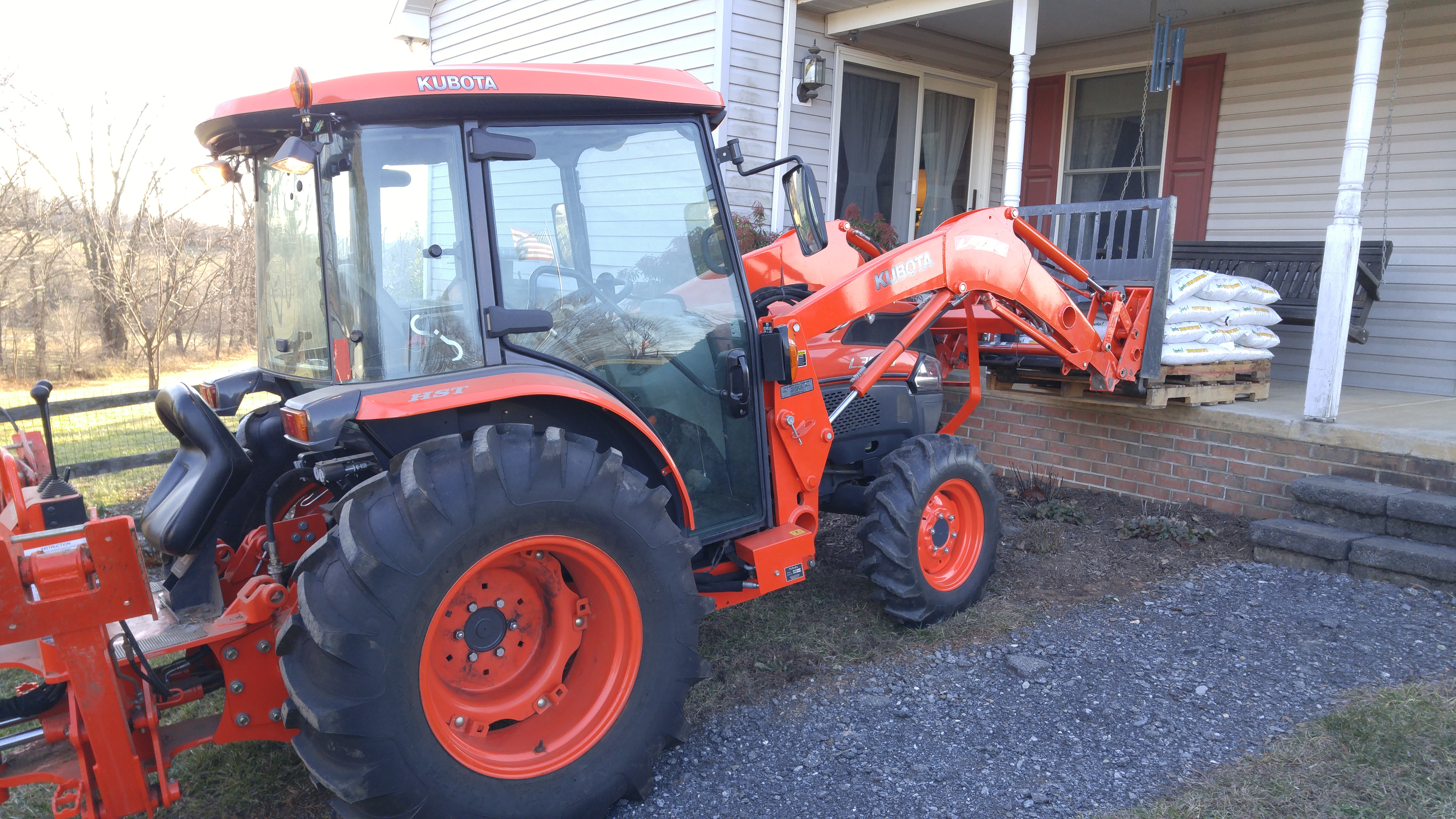

I'm considering upgrading my tractor to a cab tractor, but hate to get rid of the BH90 backhoe I already have.
According to what I have found using the Wholegoods documents from the last few years, only the BH92 is compatible with L3x40 cabs. While the BH90 will fit non- cab GL 40's, there are footnotes stating it will not work on cab models.
Does anyone know why the BH 90 will not work?
With respect to mounting pin details and parts that would interfere with the cab. What is the difference between BH90 and BH92? Does anyone see a workaround?
Thanks in advance for your help!
   / Backhoe BH90 on L3940-3. Why not? #2
Kubota designs their backhoes to tuck in very close to the back of the tractor for strength and rigidity - very good from a safety and performance standpoint. The backhoe on my older open-station GL, for example, has the operator's seat backed right up against the tractor seat, and my head is directly under the ROPS. From what I've seen, the BH90 is also designed like that. Problem is, that's right where the back window is on a cab model GL, and there would be no room for the operator's seat (or the operator).
Evidently there were enough buyers that wanted a BH on the cab models that Kub re-designed the BH so it would work, pushing the BH and the operator's station back a little to allow more room. Don't know if they stretched just the subframe, just the BH or both, but whatever it was, it ended up being enough different that you can't play mix 'n match with the backhoes and subframes between the BH 90 and 92. I'd suppose there could be some valid engineering reasons for doing that, even though owners of the older design are kind of backed into a corner, as you describe.

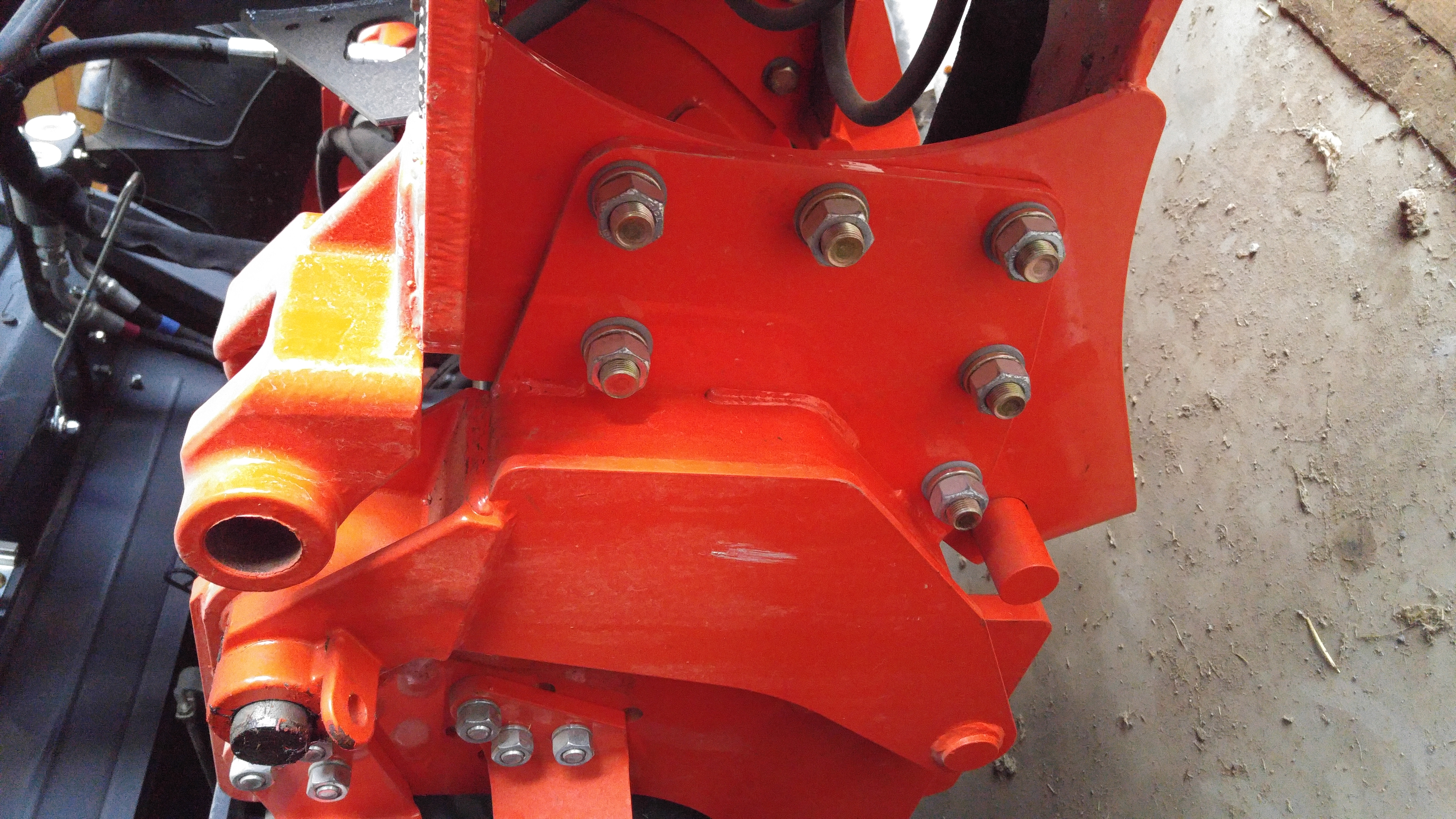

My bh92 for my cab has brackets to set it about a foot further back than for a non cab tractor. Bracket is on bh. If you had a non cab tractor it looks like the bracket could be removed to put the bh tighter against a non cab tractor.
   / Backhoe BH90 on L3940-3. Why not? #4

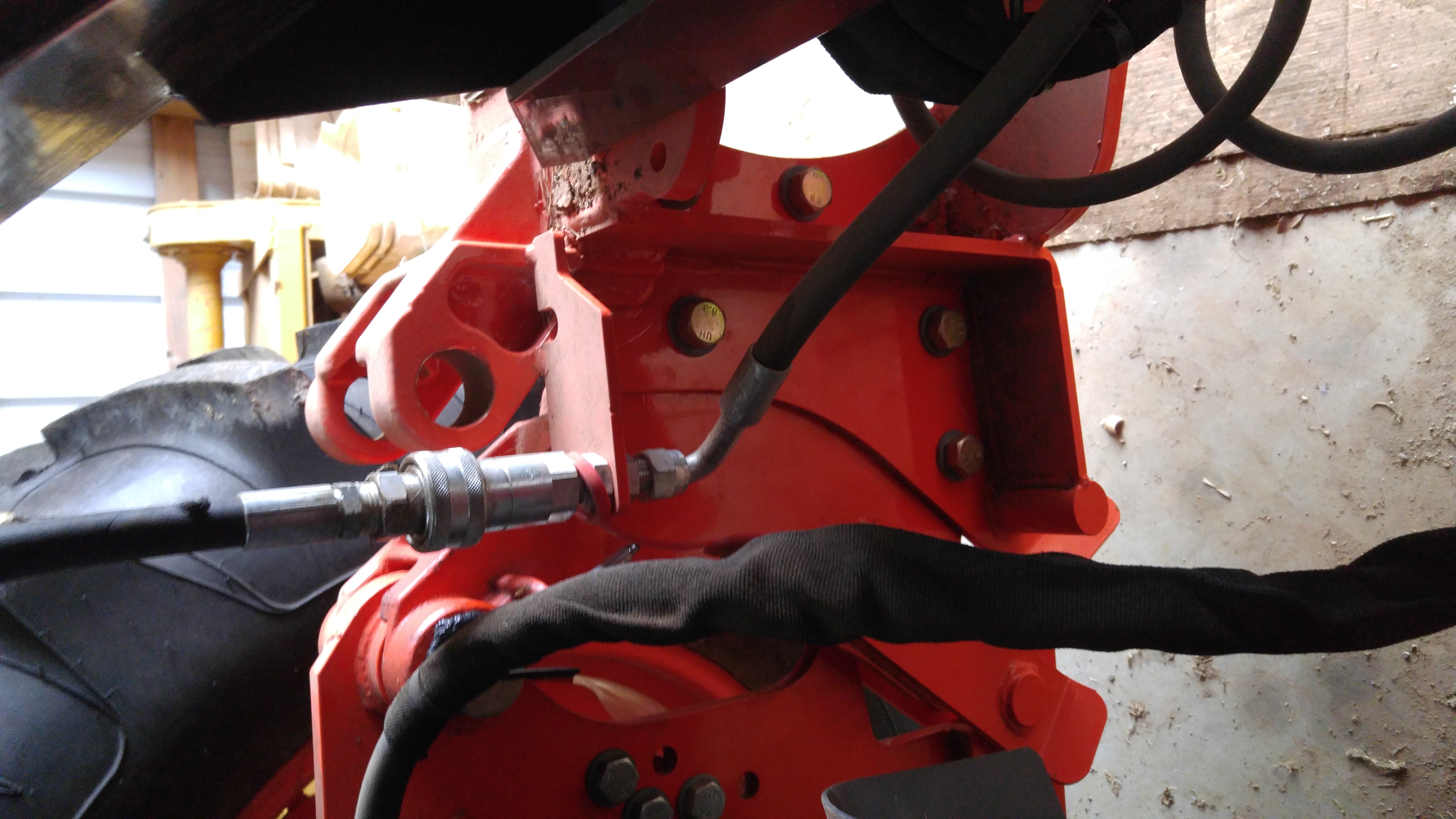

You can see the bracket bolted on, look behind right rear tire. You also can see the original unused pin holes, and on the far side you can see the pin on the extension bracket to the right of the empty pin hole.
My left side pin doesn't line up real well,so it takes some beating to knock that pin out. Right one comes out easy.

I would like to thank everyone for their feedback and photos. It's too bad Kubota didn't offer mounting kits (AKA: Adapter plates) similar to what buckeyefarmer's photo depicts for the BH90, but also understand there might be other technical reasons for not doing so.
Does anyone think these mounting kits could be adapted to the BH90 to make it work? I'm asking as I don't know anyone that has a BH92 that I could look at 1st hand.

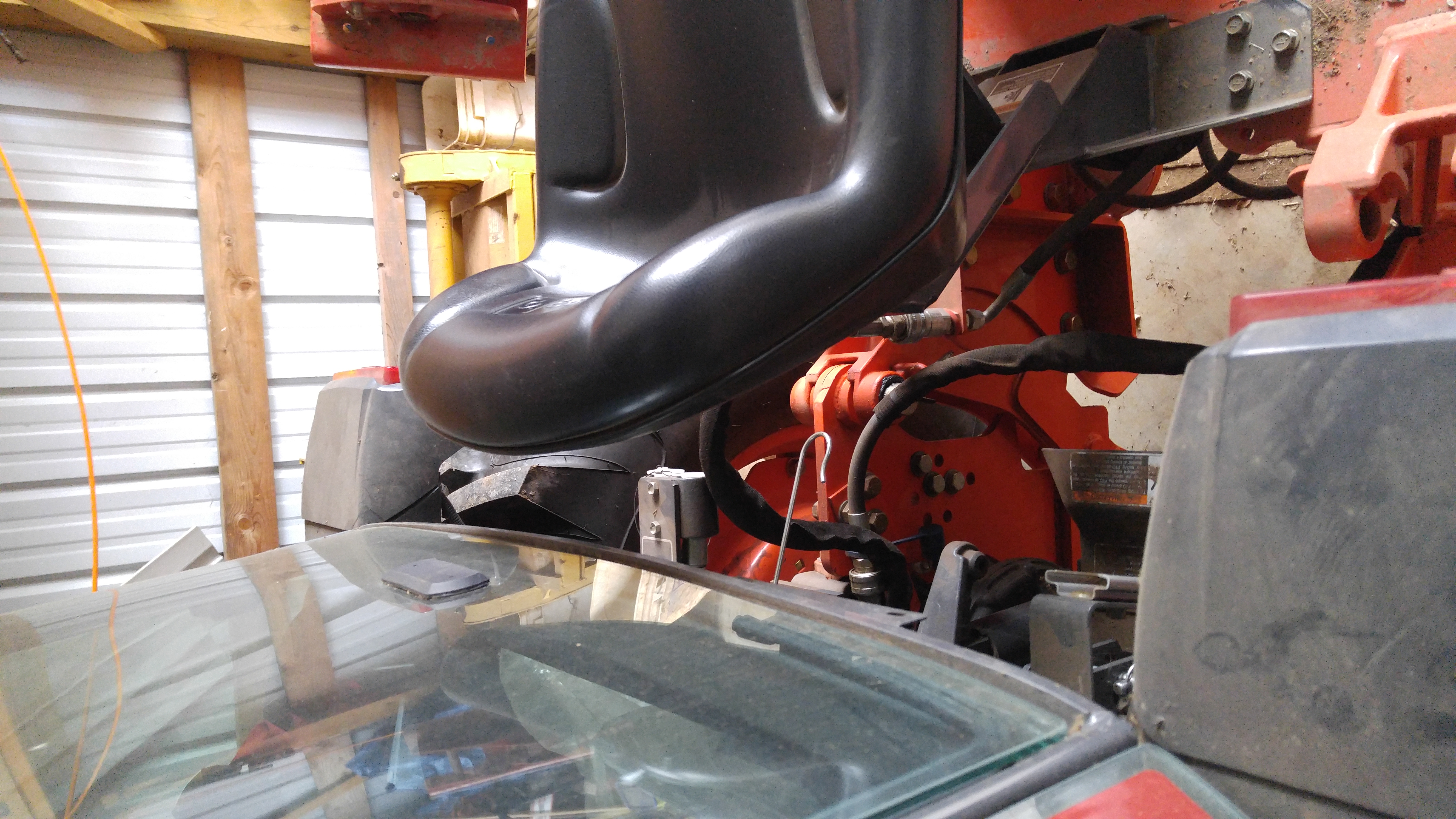

Pic of both sides of the bracket. Looks like the only reason for it is so the seat won't hit the cab. Looks like it would almost fit without the bracket.
