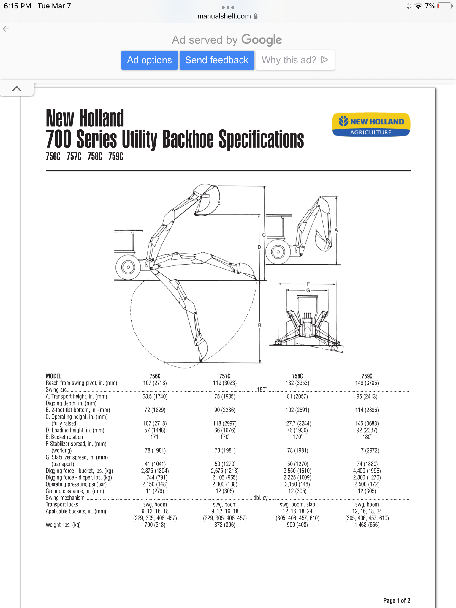

Good afternoon, I have a 2002 New Holland TC 21 (not a D model) which has a standard transmission, not a hydrostat. Would anyone know if there is a backhoe attachment that would fit this machine? also, a make and model number would be a great help. Thank you

According to tractordata.com, New Holland never offered this model with a factory Backhoe.
So you must consider if the plumbing is there to connect tractor hydraulics to an aftermarket Backhoe.
Hydraulic pump flow is low.
You are probably better off renting a stand-alone mini-excavator from Home Depot or a rental company than attempting to add a Backhoe to this light tractor. Without plumbing, an aftermarket Backhoe would probably cost $5,000.

Not only that bur without a subframe, you stand a real good chance of breaking the rear case. Backhoes really need a subframe mount, especially light duty tractors like you have.

Ford did have the 756C backhoe subframe mounted available for the TC21, 6’ dig depth. As previously stated, it would probably not be cost effective and may be slow. I also agree that mounting a backhoe on that tractor is not a great choice as the rear end housing is aluminum and could break regardless of the backhoe being subframe mounted.
A mini excavator rental may be the best option.
