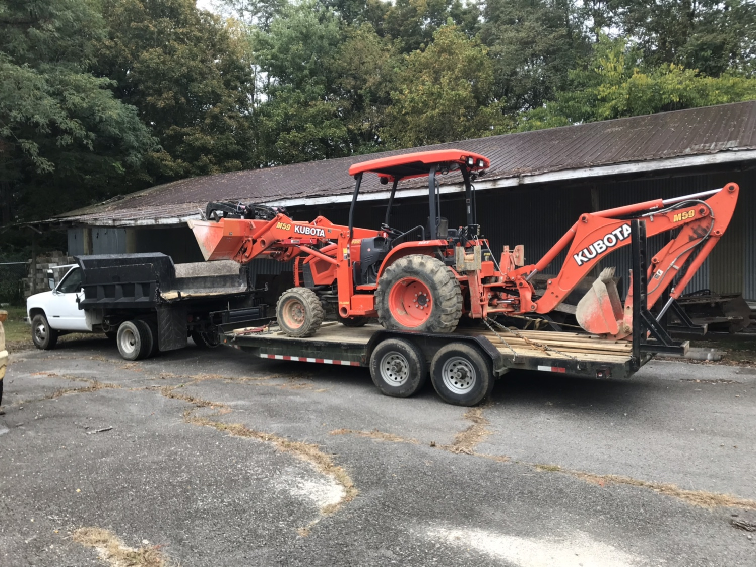

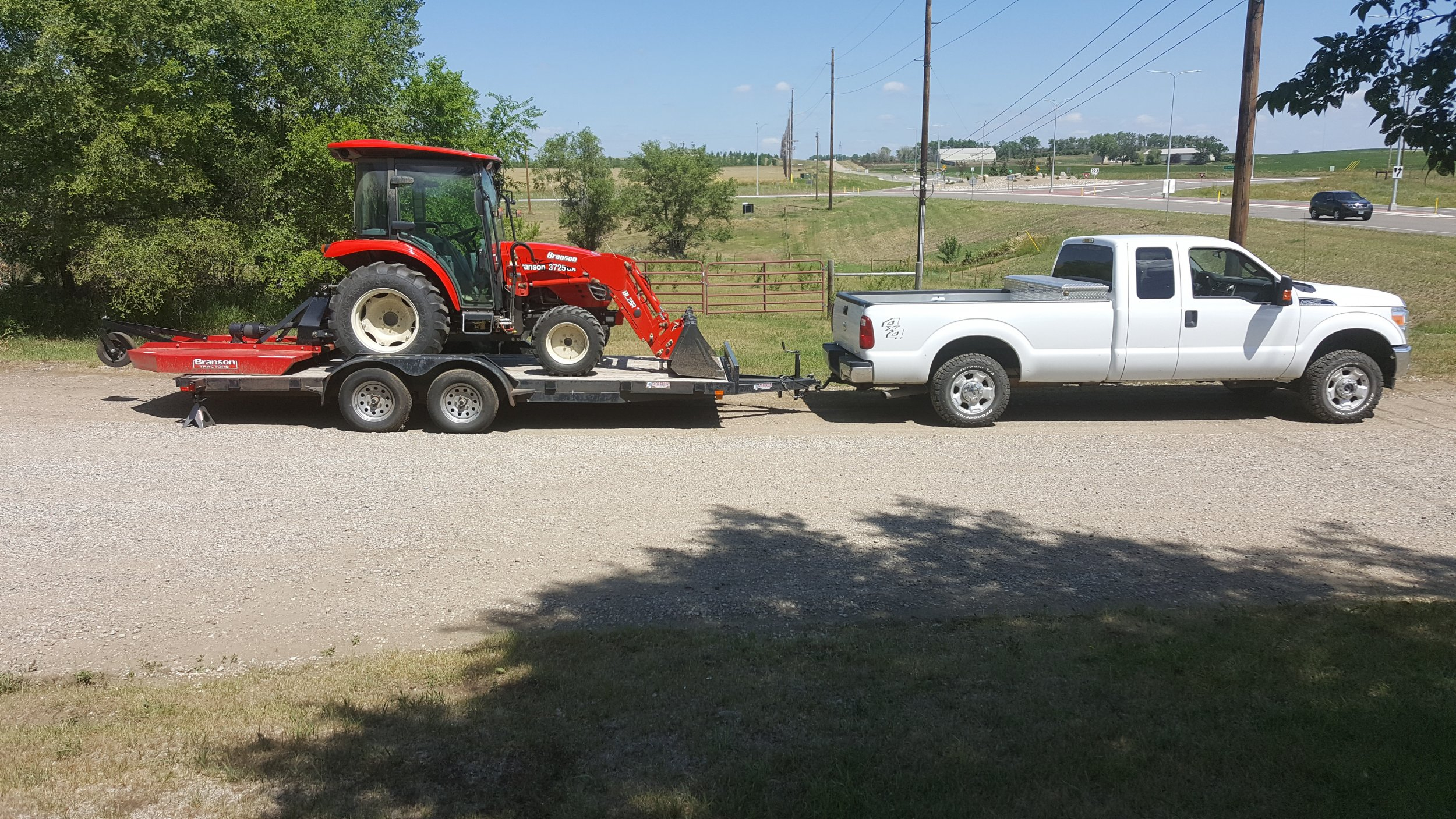

It’ll fit, just let the backhoe stick off.

Did you transport it with the bucket up? You're an agent of chaos! A madman! Lol

It’ll fit, just let the backhoe stick off. View attachment 697693
Awesome. What size tractor and trailer length is that? The tractor I'm looking at is 10.5 feet not including FEL length or backhoe. Dealer didn't call me back so I gotta wait until tomorrow to get more measurements.

That’s a Kubota M59 on a 20 foot trailer.
Yea if it was lowered it would mangle the jack and I couldn’t back it up more. Not the last attempt either.
