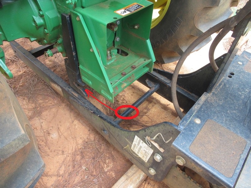

Does anyone out there happen to have a backhoe attachment on their 60 HP ish John Deere farm tractor?? I have found a good used Kubota 4540A(I would paint it green when I was done) that has onboard hydraulics and I am looking for good ideas on how to build a rugged subframe for it to attach. I have an older(mid 80s ) 2350, 55 HP MFWD AG tractor w/245 FEL and have the use of a full machine shop and am a very good welder/fabricator. I have been running ideas through my head for awhile . I would want to keep the 245 loader frames in place so I can keep the loader on. I would appreciate any pics that you could supply with ideas.

I can get you pics for a 5055E with the factory subframe mounted 485 backhoe if that would work for you.

Oh that would be great. Seems like a 5055 is approximately the same size tractor. All pics are greatly appreciated. Don't be shy.

There are 2 pieces to the subframe. One is bolted to the tractor at mid point, the other is bolted to the back at the 3pt hitch area. ( I have to remove all 3 pt parts to mount the backhoe) All the subframe parts are black. But the black tube under the tractor is part of the MFWD and not part of the subframe.
The backhoe has 2 parallel channels that pin to the forward subframe mount.
The rear mount has a notch that a bar on the backhoe slides into.
Here's a pic of the forward mount that shows how the backhoe frame channels slide into the subframe. Note the pin holes on the outside leg are larger than the inside leg. The pin is stepped. There are only 2 pins (and 2 slots) holding the whole thing in place.

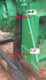

I'll get you some thicknesses of the steel - but it's built up from different thicknesses in different places.
   / Backhoe attachment on an AG tractor #6
The forward subframe is made from 0.5" steel. The rear subframe is a welded assembly of different thicknesses. The 2 that I can get to at the moment are 0.5" and 1.0" - see picture. The channel is 5". If you need more dimensions, let me know, but it may be a couple days before I can get them.

Thank you 3Ts. I think I can work with this idea
