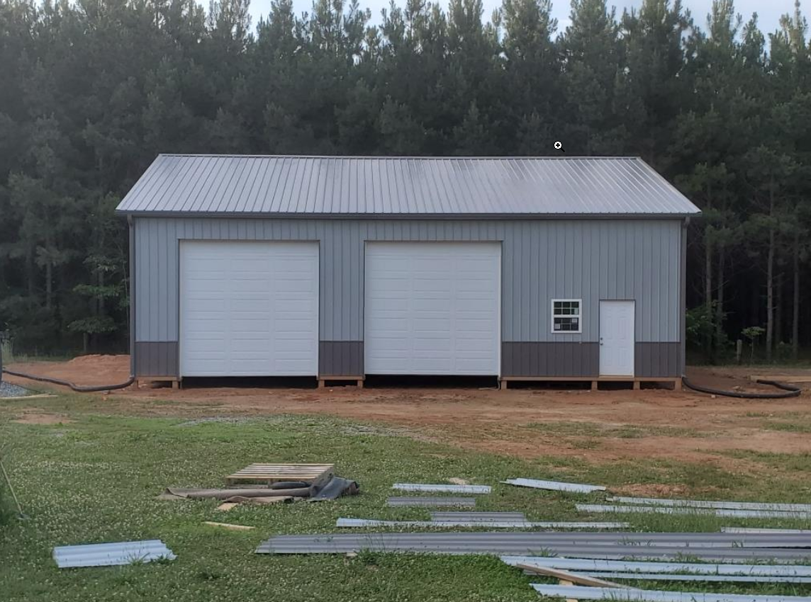

Hi guys,
Just finished a 40x48 pole barn. There is ~12" gap below the bottom of the skirt (2x8) that I need to do something with. This was intentional as the barn is on a slight grade and I wanted to raise it up a bit due to the crazy rain we get here in NC. Due to complications with the county, the building pad was built up just enough to create a level area for the builders to do their thing. Even then, this resulted in ~2.5' of fill in the back. Yes, I understand it would have made more sense to build pad up to

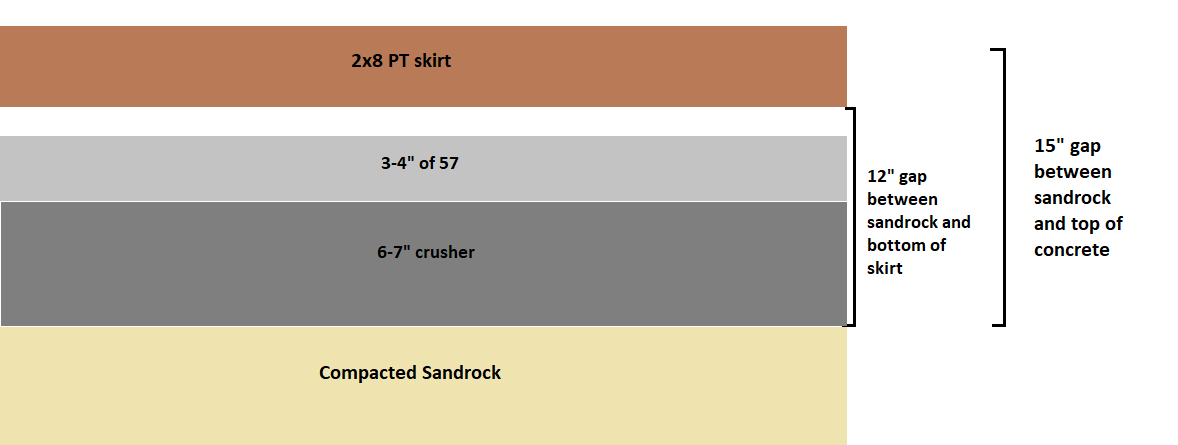

I have ~14" that needs filled up INSIDE the barn. I figure 4" concrete + 4" #57 and ~8" of compacted sandrock would do the trick. The outside we will blend off using cheap fill dirt. Should I double skirt this building with a 2x10 below the existing 2x8?
Just curious if anyone has been down this road before...the builder said they typically put the skirt right on grade but that wasn't going to work in this situation.
thanks for any advice!!
Drew
   / Backfilling pole barn, need advice #2
I wouldn't add skirting. In addition to the fill inside, I would fill outside to gently slope away with rock, at least a couple of feet. In addition, maybe lay landscape cloth under the outside fill. Then you should be in good shape for water resistance.

I take a different opinion than Kenny and certainly would add more skirting now, especially with how easy it would be to do here. Shoot, I laboriously dug down 24+" around my pole barn perimeter on the inside just to pour a concrete rat wall. Keep the critters from undermining your slab! Plus erosion benefits, etc. It will also make your backfilling easier, allowing you to keep the inside fill separated from the outside fill, etc.

Ya know....rock is damn expensive right now or else I would go wild and fill the building up with it. The local quarry gives away free dirt from processing and we have a ton of dirt work to do on the outside so thats why I was thinking about using that for the OUTSIDE. Sandrock is ~200 bucks a load right now.
Deezler - I priced ground rated 2x10x16's and they are ~$55 each so double skirting would prob cost me in the neighborhood of ~$600 or so. I tried to get tongue and groove before building was up but it was special order and we ran out of time. I think the fill inside and outside will keep that second skirt from going anywhere. According to the plans the finished EXTERIOR grade should be the BOTTOM of the skirt shown in the pic.

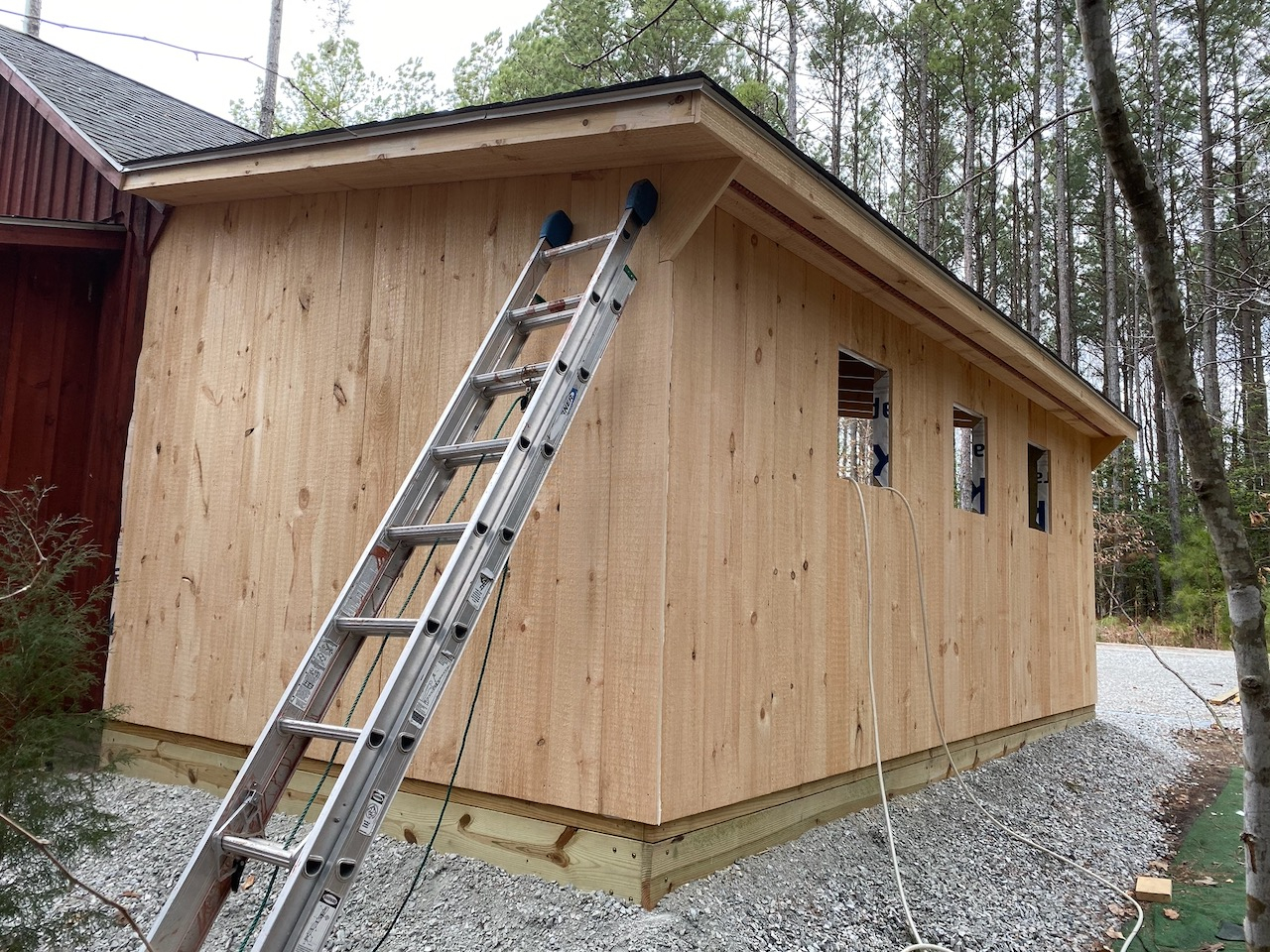

Here's a view of an addition on my barn. Extra skirt added in the rear and sides, slopes up to just the standard skirt in the front.
