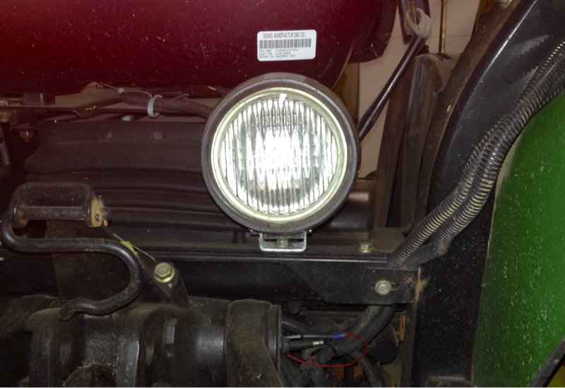

If you REALLY know what you're doing and have LOTS of time to kill I suppose you could rig up a light to come on when you hit the reverse pedal but it's a lot faster and simpler to just plug a light into the open slot in the rear wiring harness and control it with the switch on the dash. At least that's how it works on my 4310 and I'm guessing yours is similar.
Here's my light.
I can only post one pic per reply so I'll continue on the next reply...

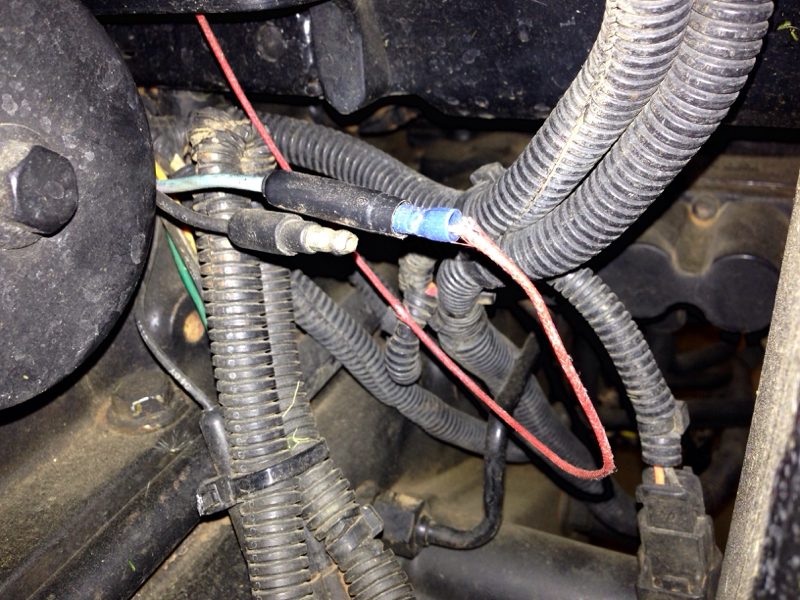

Here's where it's plugged in at. The wiring harness on the back has an unused male and female end. I bought a bullet connecter and crimped it onto the wire for my light and just plugged it in.

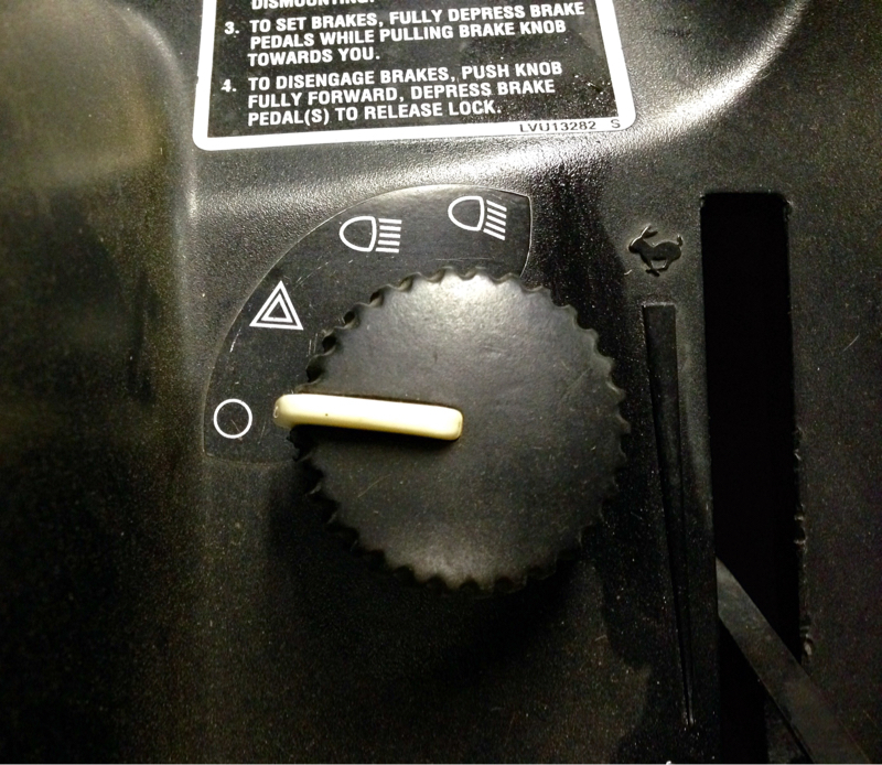

I turn it on and off with this switch on the dash
Just turn it all the way to the right and it comes on along with the headlights and 4ways.
A couple things worth mentioning that I've read on here...
Don't hook up too many lights or you can fry your wiring harness. My light is a 55 watts (waterproof Hella light off amazon ). I think it can handle two of them (one per harness on each side) but I've read that that is pushing it. I'd get LED if I was doing it again or if I ever add more because the electrical draw isn't as great.
