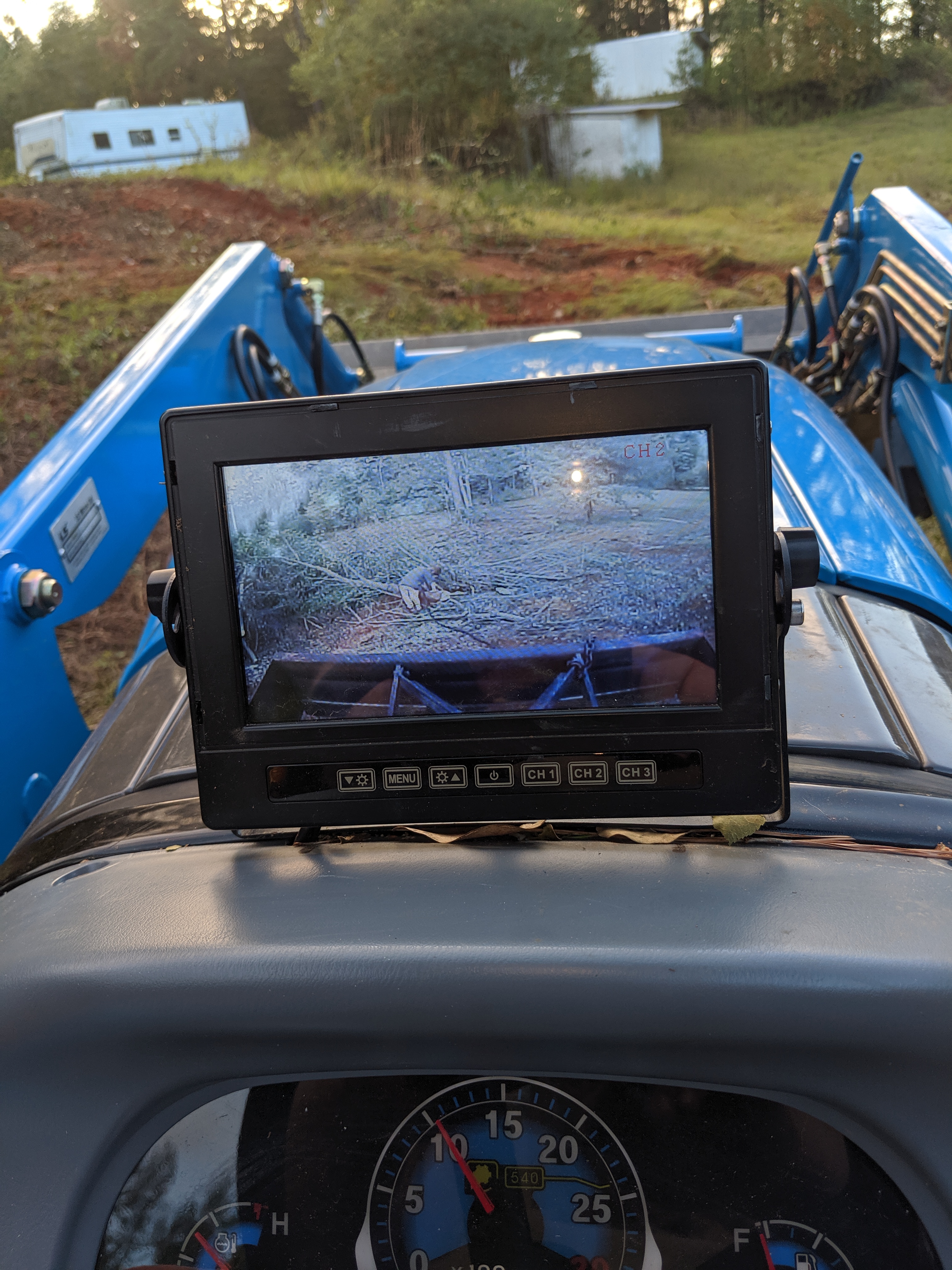

I lost my right eye in a car wreck a little over 4 years ago. Hooking up implements to my tractor has been frustrating to say the least. So after shelling out money for a new LS XR 4145 I decided to add a backup camera. I called camera source and ordered a 7" weather proof monitor and a hd infarred Sony camera. It's mounted looking down on the lift arms. You can definitely see to hook up, but it doesn't allow me to line up on the implements before I'm right on top of them. So I bought another camera (monitor will support you to 3). The second camera looks straight back and is perfect for lining up on the implements and when you get close just hit a button on the monitor and swap to the down facing camera. It has made my life so much easier. Also the back looking camera is great for driving on the highway!

I'll try and take a few pics and figure out how to load them.

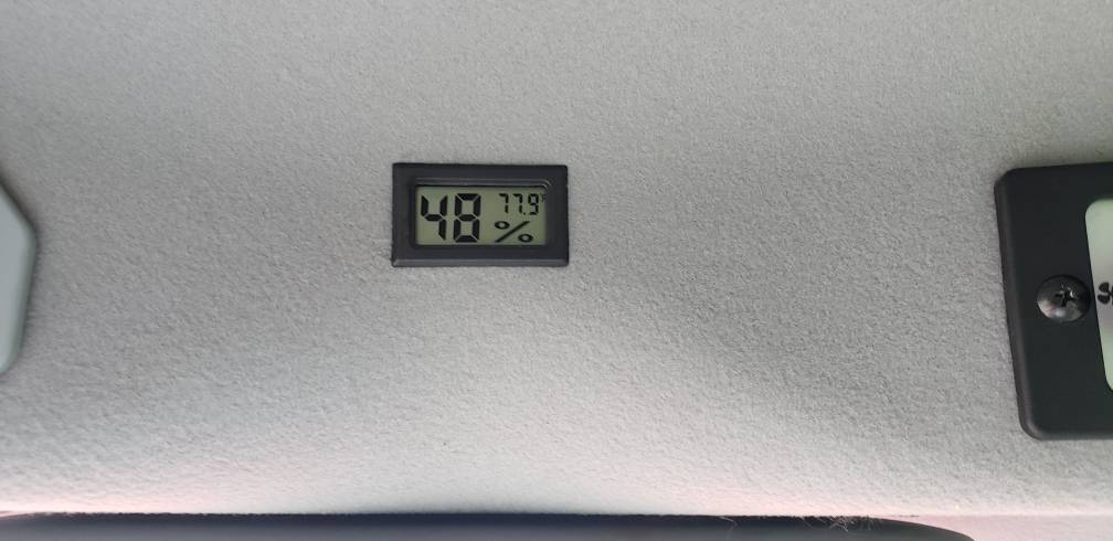

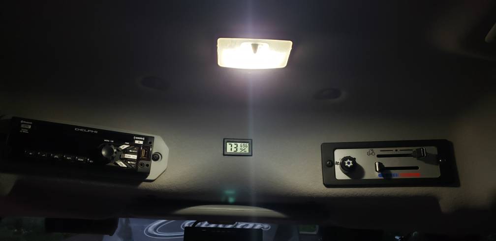

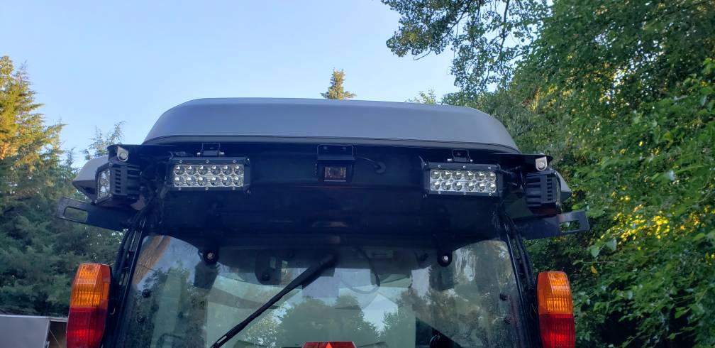

Here are a few upgrades I made earlier this year after I lost my 1742 in the flood That had only 80 hours on it (**** I loved that tractor) I replaced it with a 1755. I installed front and rear night vision cameras with the split screen that can handle up to 4 cameras. Then I also added A thermometer and humidity gauge and LED front rear and side work lights and dome light.View attachment 628817View attachment 628822View attachment 628818View attachment 628819View attachment 628820View attachment 62882120190722_195538.jpg20190722_174637.jpg20190722_210713.jpg
