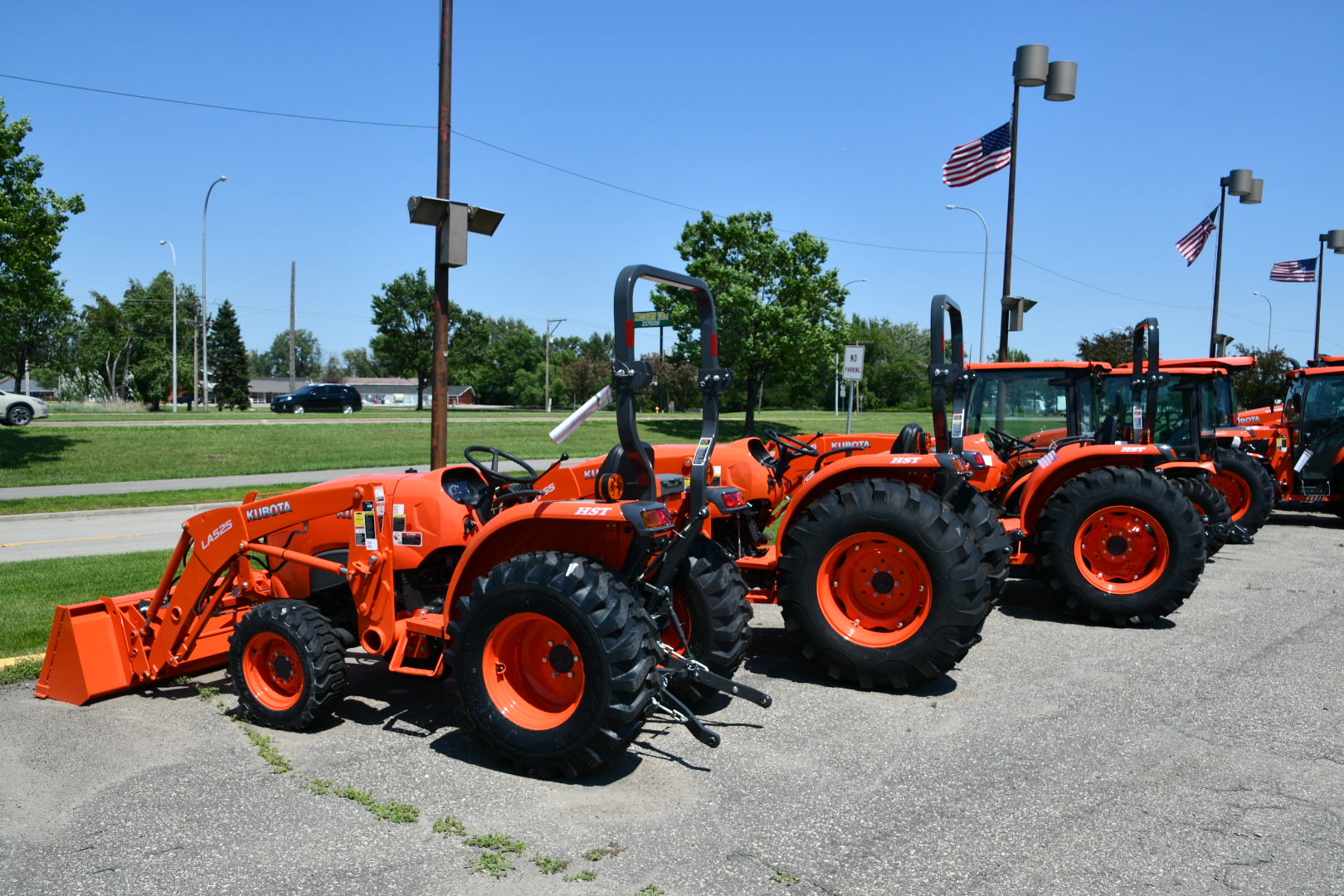

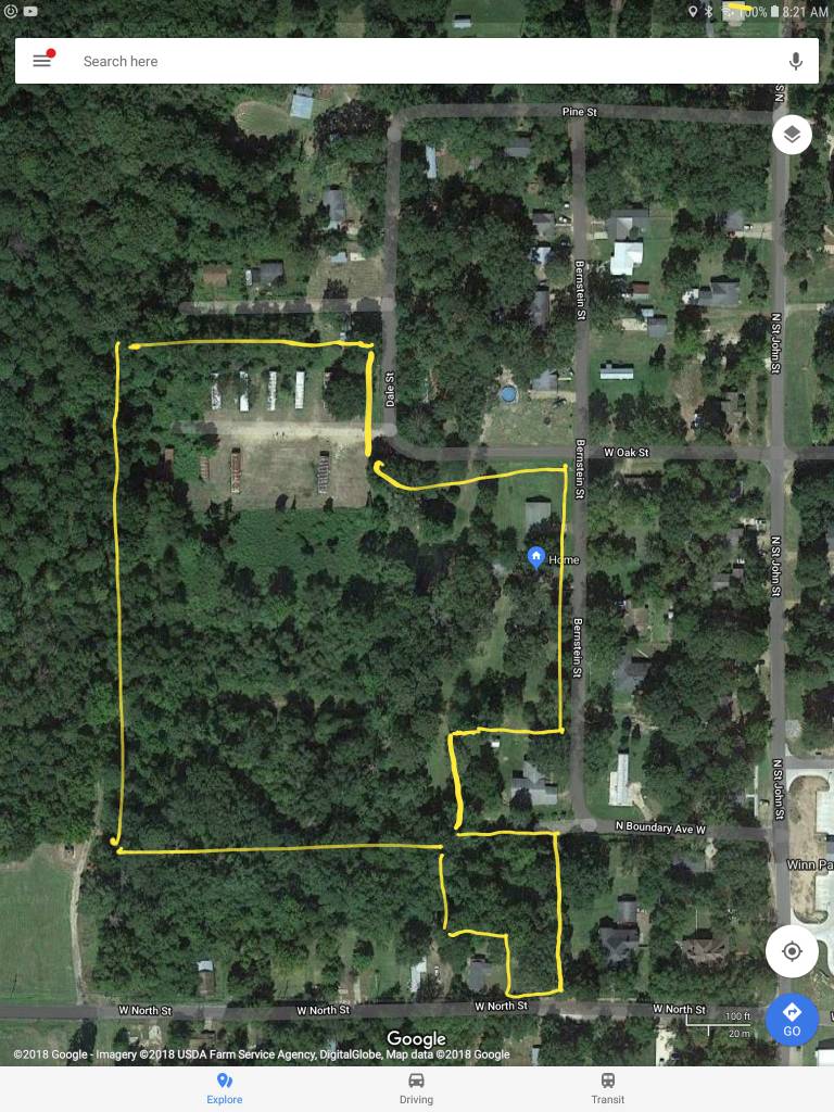

All three of them were parked side by side at ACME equipment, Grand Forks ND, here where I am working, really liked the looks of the L4701. Below is my property now. Screenshot_20180624-082226_Maps.jpeg
   / Back in the Tractor Market, after a few years of enjoying a B3200
Here's three possibilities, all in a row, L3901, L4701, and MX5800. Leaning toward the L4701 currently. TR7_3409.JPG

<snip>Below is my property now. View attachment 561731
If that is your 25 acres it looks like you've got about 15 acres of mature hardwoods and it's flat. What do plan on doing with your tractor?
Bigger is not necessarily better in dense woods.
Just like heavier is not necessarily better in rice paddies.

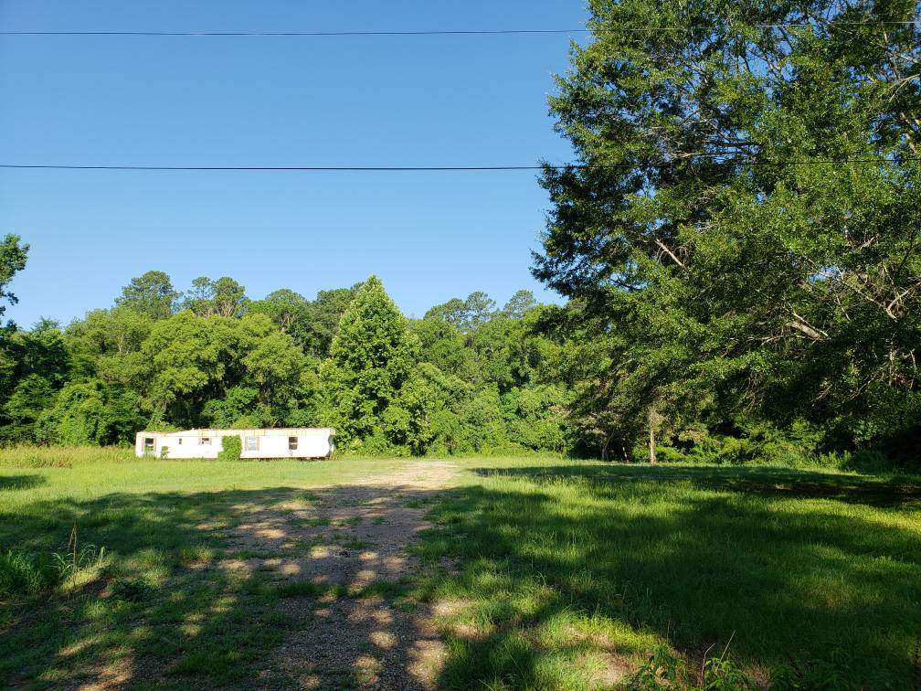

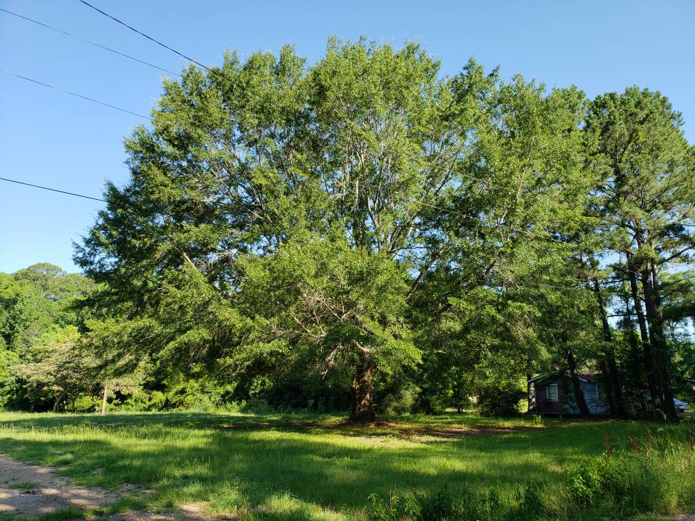

The top part, which is north, was an old trailer park, all but two are gone now, and just use the 60 RFM to keep it down, just south of that is a part that I have to bush hog, due to the taller stuff that has grown up, currently have one of my friends do it about ever other month for $125 dollars, since I am gone most of the time, Working, only 16 months to go before retirement. The part to the east that is where my House is, is all mowed with small riding mower. The South West Conner is heavy wooded, and I am building trails thru it to ride my Side by Side. Lots of downed trees in it due to storms, and a bunch of brush piles from thinning about 10 years ago, starting to rot now though. In between all this is a low area, that I want to make about an 2 Acre Pond.
The old Trailer park, even that last trailer is gone now. Two old ones still back in the woods. 20180616_090047.jpeg20180616_090032.jpeg
