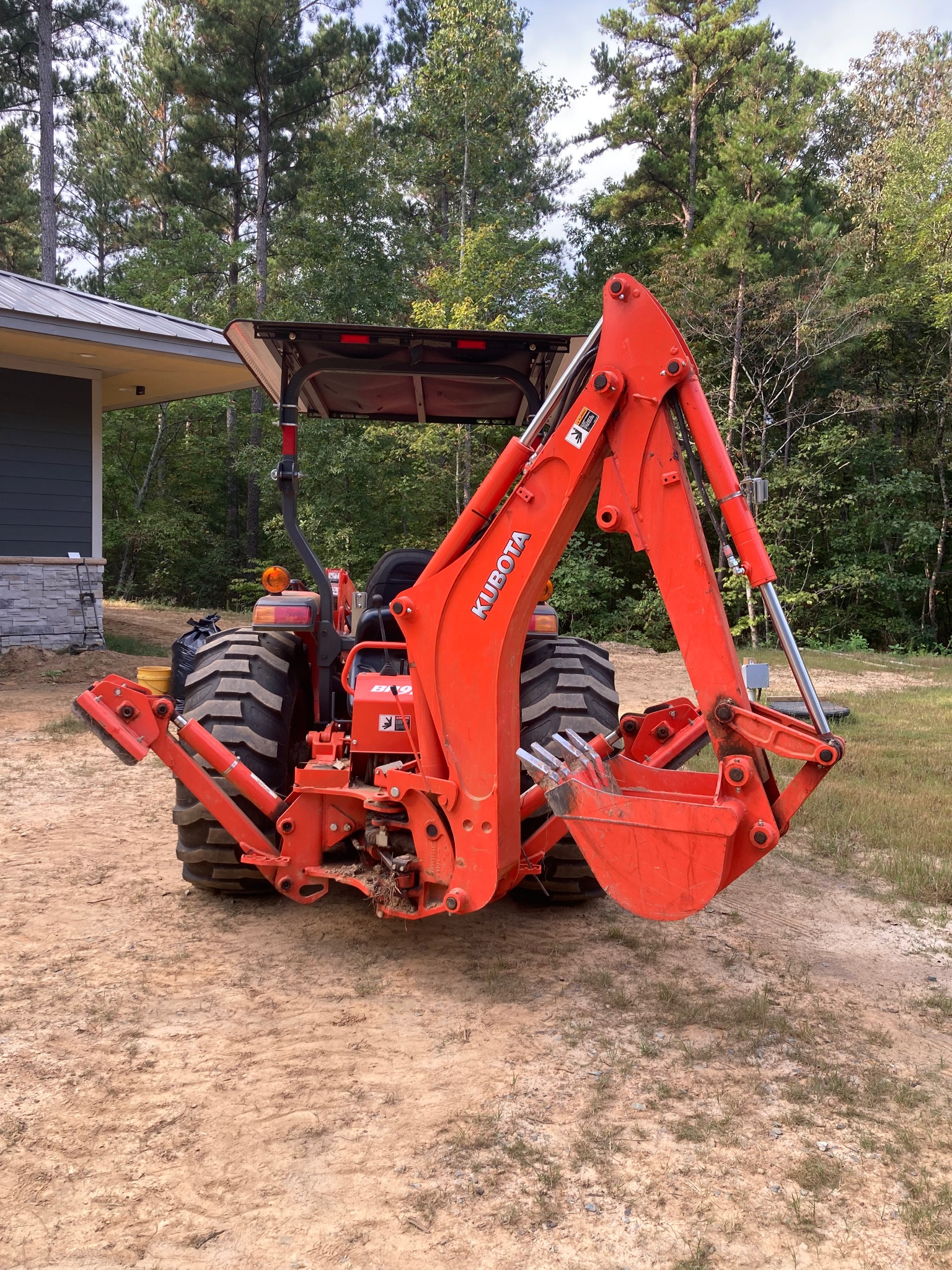

it's been almost 2 years since i got my tractor and the BH has never been off. i use it all the time, not every day but almost every time i'm out and about i see a rock or stump and i just gotta rip it out.
i drive around with the BH in what i'm calling the standard configuration, it sticks way out and straight back, everything tucked in properly. it took me a long time to understand just how far that thing sticks out and how it limits your ability to get around so.....
i just rotated the BH to the side and it buys me a little more clearance in the rear.
Is there any reason not to do this?
As a side note, i extended my 4 in 1 bucket as far out as it would go and the BH as far back as it would go. i think i walked off
40 ft? that's a long machine!

Having it off to the one side all the time, expect to see suspension and tire wear to be accelerated. Possibly also the articulation joint bearing from bouncing around off-axis (depends on the bearing type kubota used).
Small tractors, unlike large tractors and dedicated backhoes, are not centered or offset to maintain that position. Part of the cost savings.

To answer your question, I carry the BH centered. It's less in the way for getting around than that huge loader bucket is. Sometimes when moving a tree trunk I'll offset the hoe like in your photo so that the tree is carried fore and aft like a lance, but I travel slowly because of the weight on the side. The tractor handles that fine.
In really tight areas I'm likely to drop the front bucket, raise the FEL arms, and leave the BH attached. I might leave it centered or to the side. My feeling is that the BH doesn't stick out all that far but I've never measured it.

I can’t see why not. You could alternate sides if you’re concerned about uneven wear.

That's why the side shift backhoes are great.
Not only the operator can offset the arm so he can actually see the ditch he is digging, he can also just swing the boom all the way to the side and makes for a very compact attachment, that doesn't really get in the way and still be within the tractor width.
   / back hoe side saddle? #9
Another thing to consider, aside from what is mentioned above, is traversing inclines. If the incline is sever enough and you have to travel perpendicular to the hill you would want to swing the boom to the uphill position to shift the centre of gravity. Less likely to tip when the weight is uphill. Something to keep in mind if you always put it to one side and then find yourself in a position where you might be going diagonal to a decline and maybe drive through an unseen hole on the low side with the backhoe parked at the low side as well. Could be quite disastrous!!

On my hillside farm always swinging the boom uphill for stability. Sometimes slightly drag an outrigger just in case. Had a few add-on ag tractor backhoes that were hard to reach the swing controls from the driver seat that were more hazardous and not well balanced. Sold those. Even full size dedicated backhoes are tricky on a slope. The Kubota TLB models fit well in my niche environment for work vs stability. So always conscious about the backhoe position and clearance. Have to lower the boom of the M59 to clear the tractor barn door. Raise and lock inside so will not bleed down a push on sliding doors. Works good till the day I forget.
