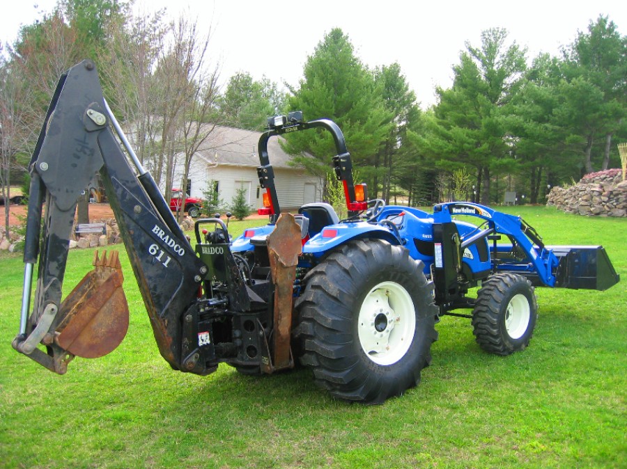

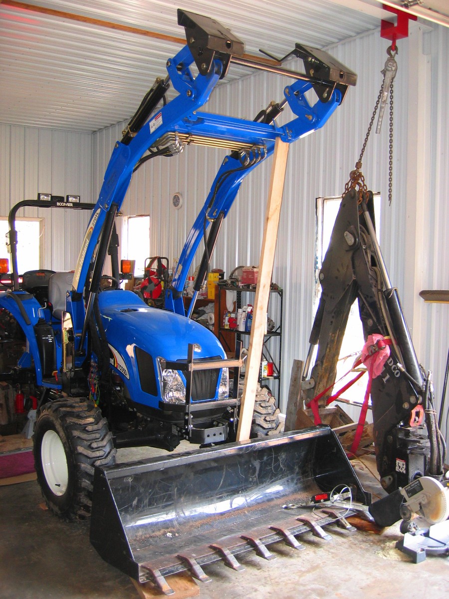

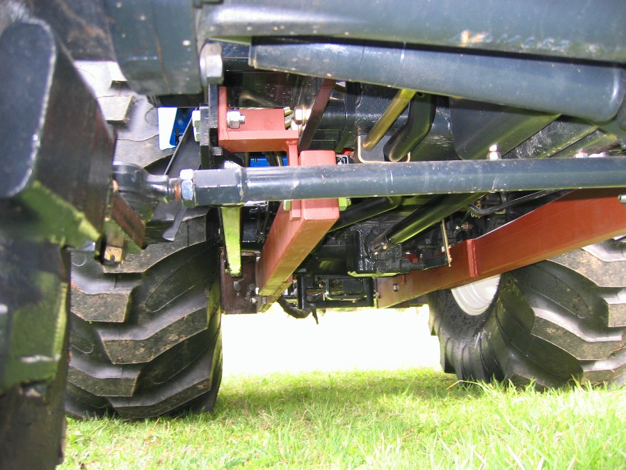

Local dealer stated there was no available mount for the 611 to the New Holland TC 55. A lighter series bracket would fit but not reccomended. I had some flat steel sheared and bent for the back hoe mount. The tractor mount used flat and 2" x 4" tube steel. I tried it out today and it passed the stress test with ease. The tractor hydraulic system has ample flow to dig in clay soil while maintaining an adequate pace. It would probably handle a bucket larger than the present 20".
