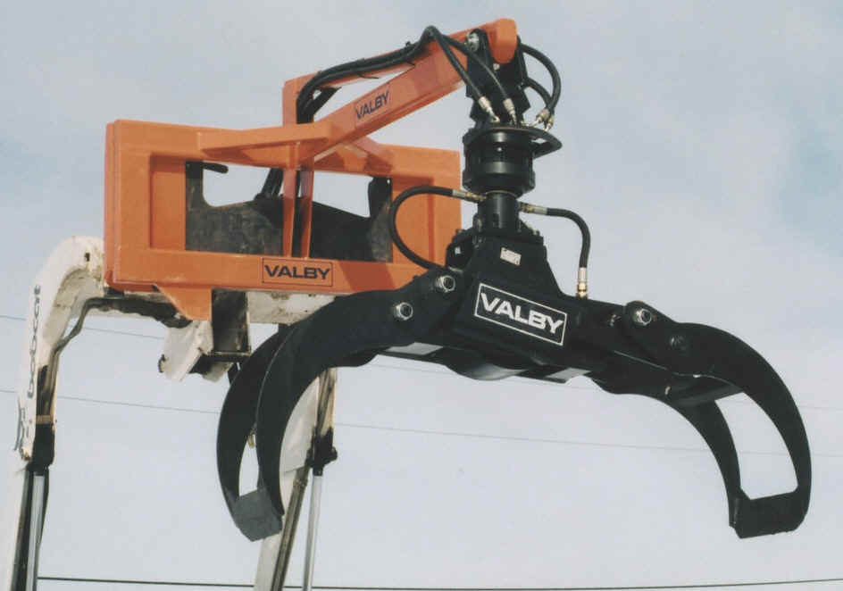

Or you could pay the big bucks and buy one of these.
