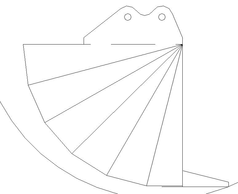

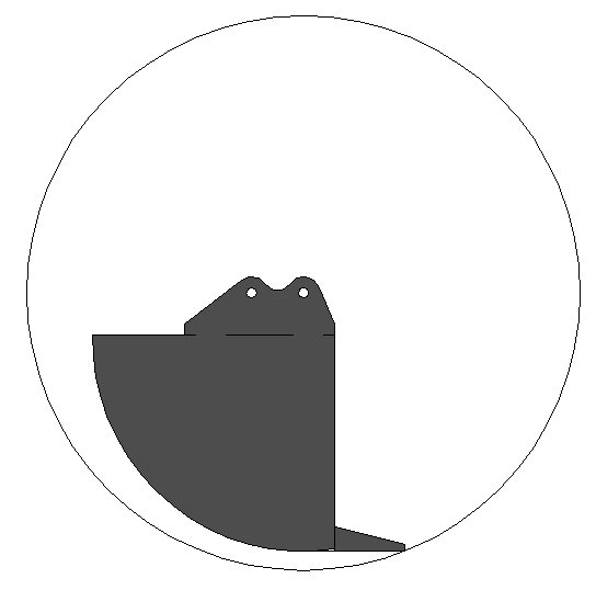

I've seen a number of bucket designs by fellow members, many seem to be of an angular design. This has got me thinking, as I've always made mine with a rounded back and flat top as shown in the image below
My reasoning for the flat top is that its then easy to see the bucket is flat and ready to draw back toward yourself.
My reasoning for the rounded back is mainly for the easy flow of soil into the back of the bucket, though I suppose an angular design would help break-up the soil. Another feature of my round design is to maximise the area within the 'swing' area of the bucket so it continues to dig without being pushed out by the back of the bucket.

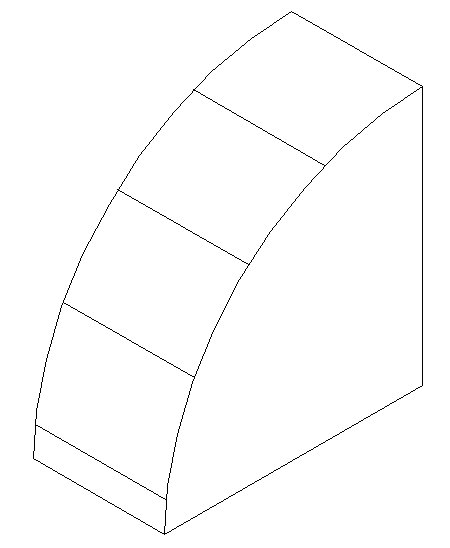

I appreciate the rounded back can be an issue, the way I over come the curve is to use strips of flat and weld them all together.
The radial lines are just to emphasise the flats on the curve. The flats are obviously the width of available stock.

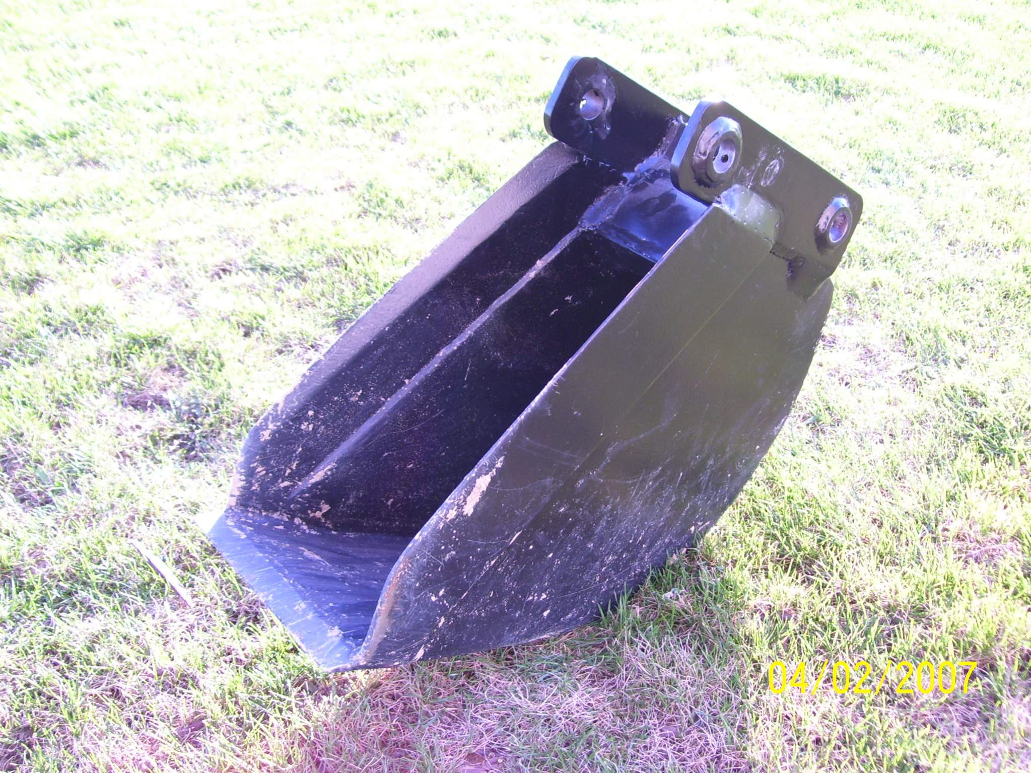

Another twist, is to add a taper to the bucket making the back part narrower than the front, and you can also make the top narrower than the bottom. This allows the bucket to be easier to maneuver in the trench, and allows you to make turns, without knocking the sides down.
I made this bucket with both tapers.
