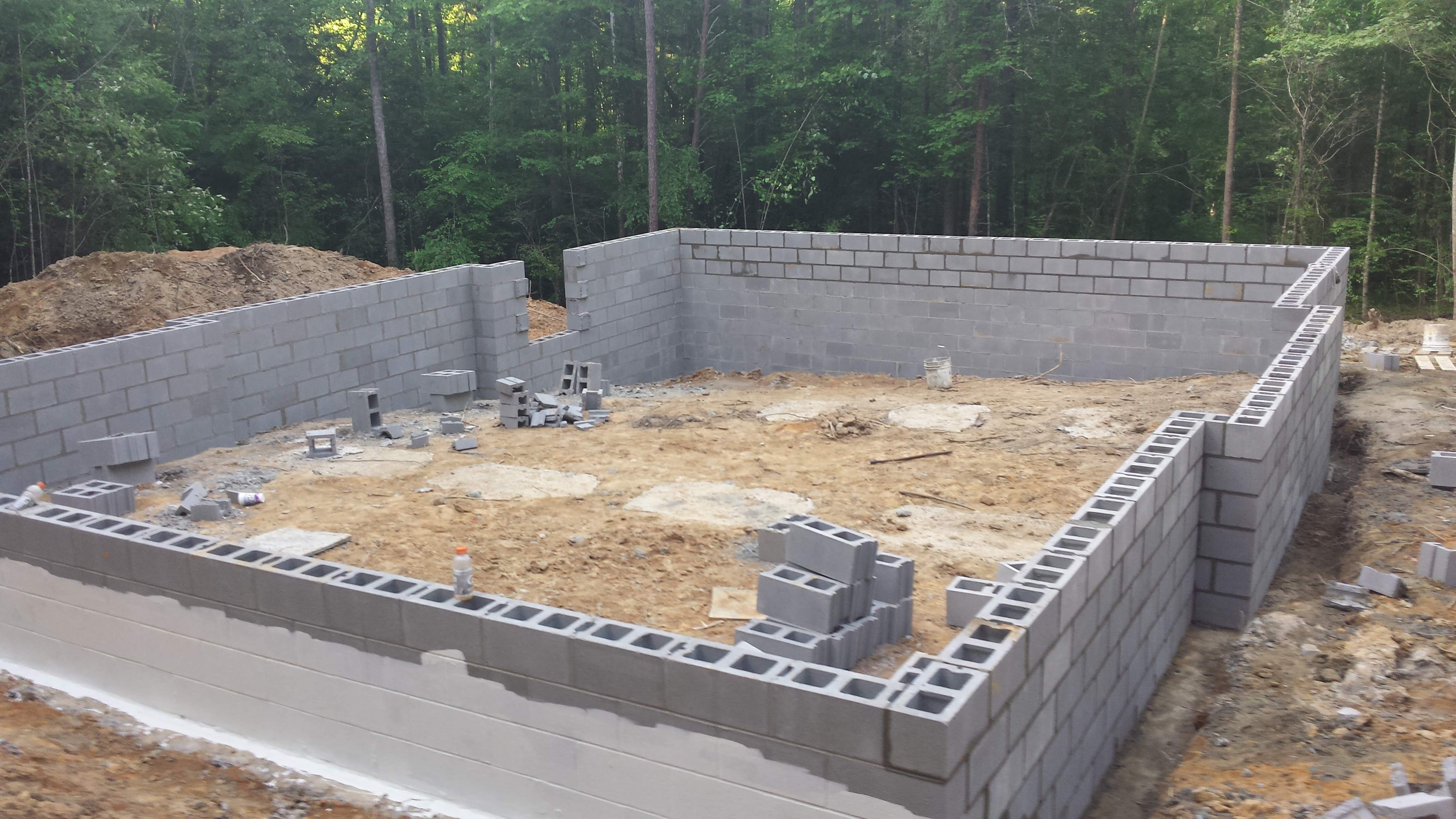

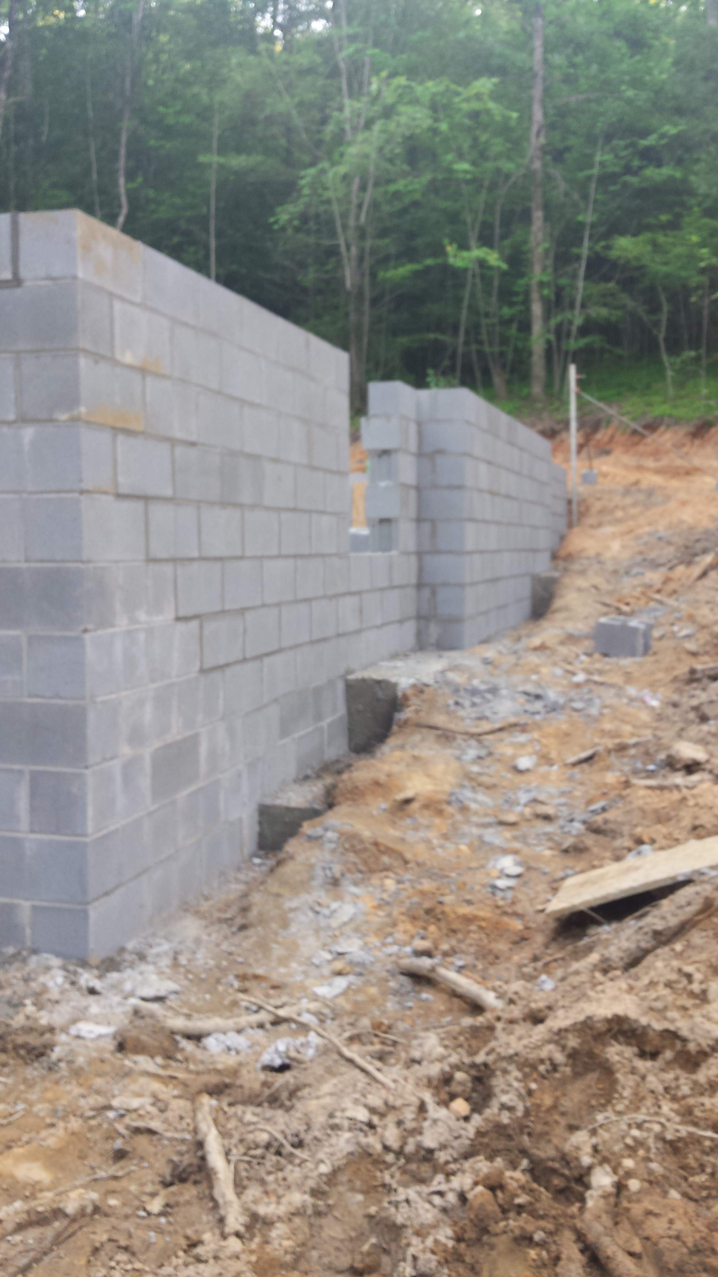

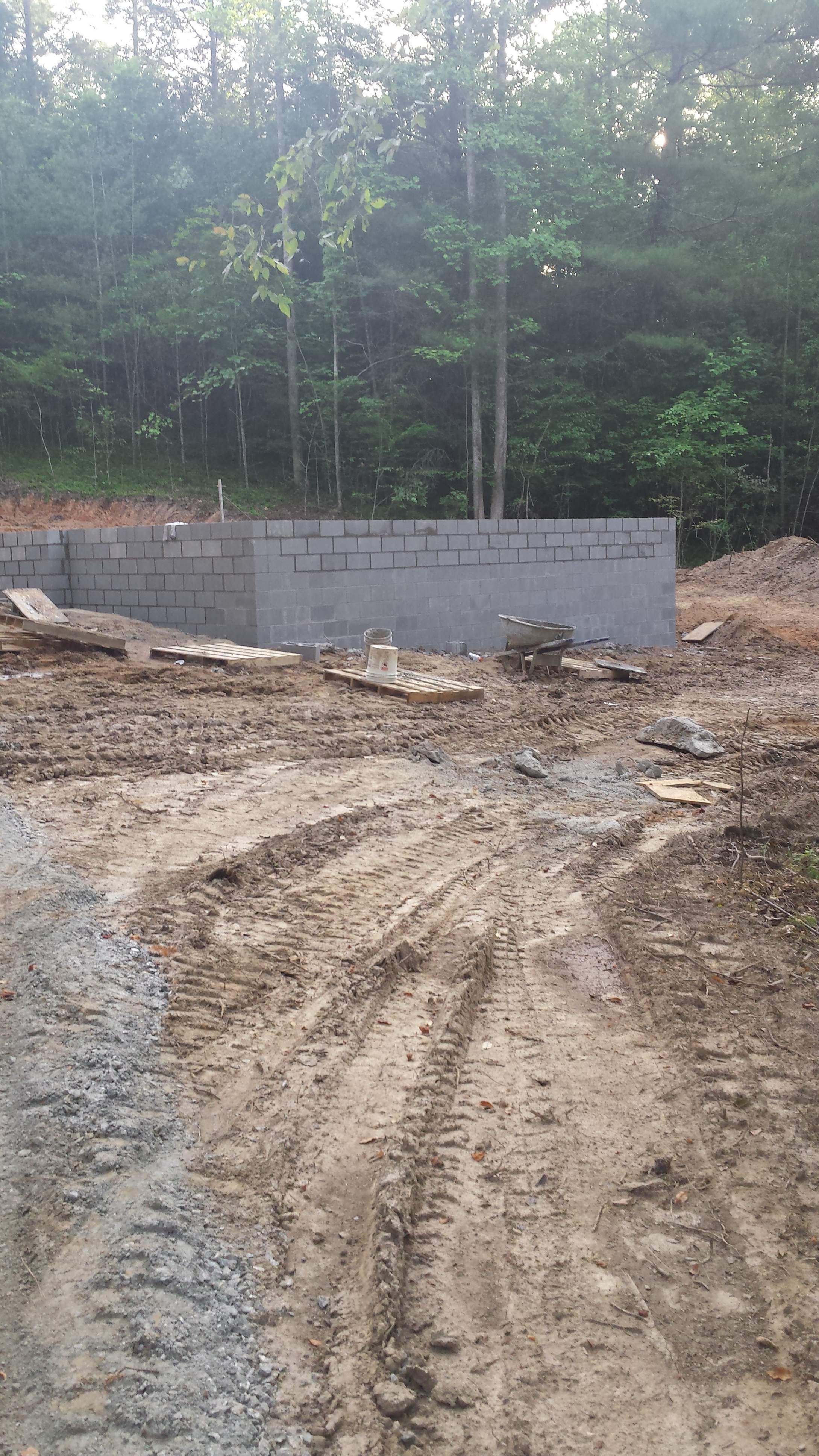

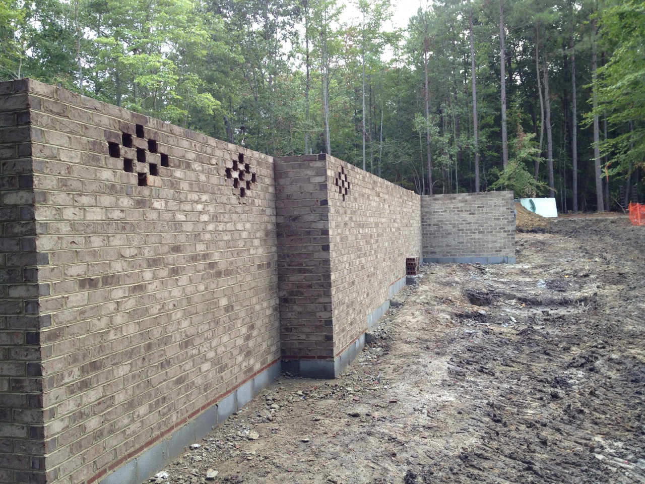

I'll provide a couple of pics for you to get a lay of the land, but for this crawl foundation, the highest portion (downhill) of block is a bit over 6ft high, but the other end is at about 4ft. Now that is a tall front porch:eek:. My GC was able to tell me these measurements before the block was ever laid, so it's no surprise on paper, but on site it looks immense. I didn't go with a walk out as I was quoted an additional $13K, so a tall conditioned crawl seemed the next best thing. Anyway, once proper back fill is accomplished, what's your guesstimate on the finished height of the front? A 6ft front porch is going to look crazy me thinks...

I find it crazy that it was an extra $15,000 for a walkout. It looks like there is already 6 courses of block (4') on the "short" side, so all it would have taken was digging out about another 4' or 5' of dirt and laying 6 or 8 courses of additional block - POOF - basement! Well, you might want a concrete floor and stairs and a door, but still....
I think you can make it look nice. You can always do some landscaping, rock garden, etc. and diminish the appearance of the tall porch - maybe a few short retaining walls with a planter or two....
It looks like a nice site, anyway. Good luck and take care.

Could always build a two tier boulder retaining wall. It'll get the deck closer to grade and still allow you to have a elevated view.

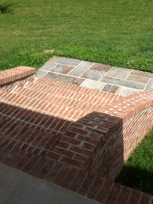

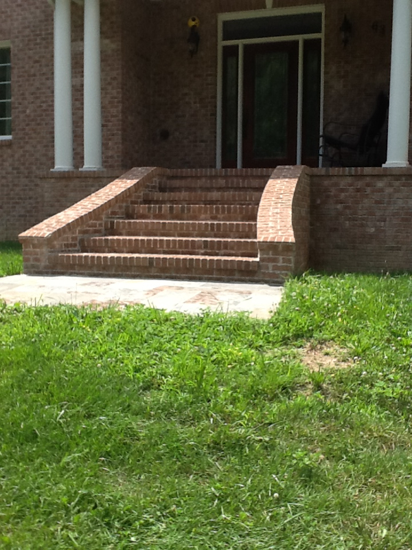

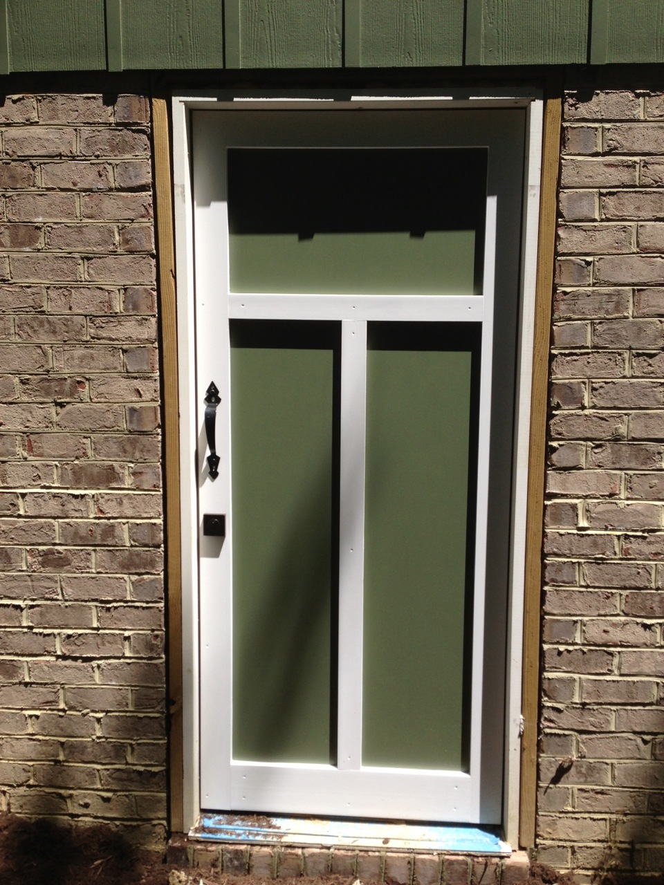

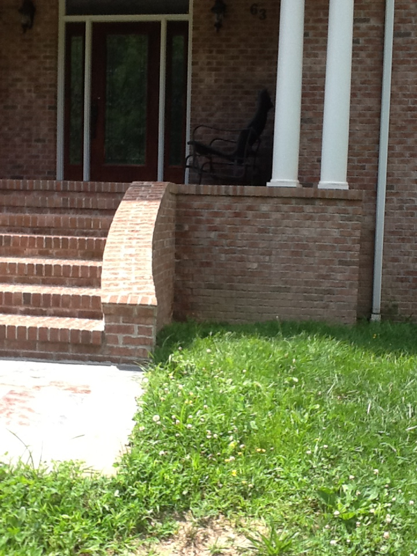

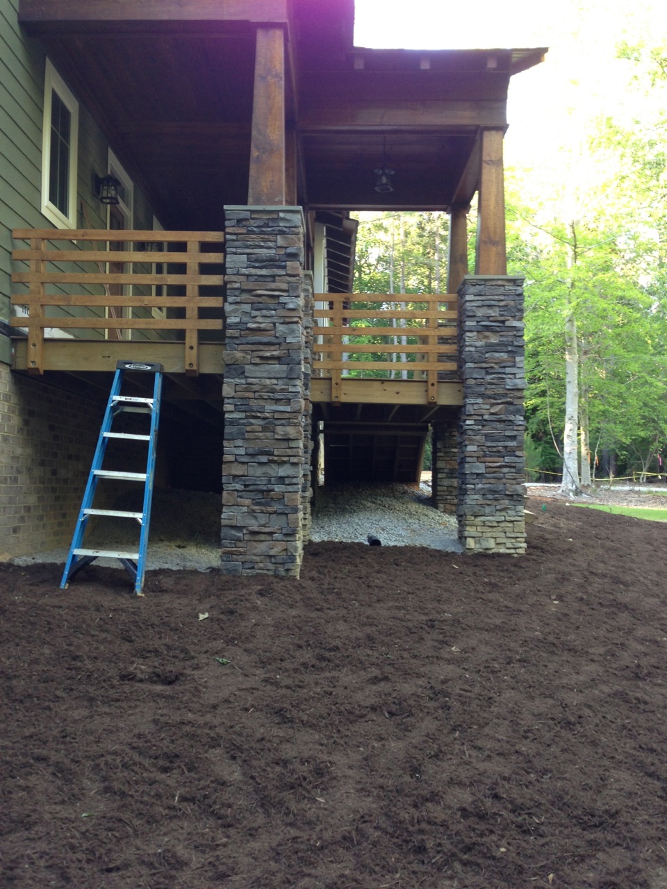

Here's a before and after pic, more or less same view. We have a tall corner in the crawl, and put a full height door there with a small 12'x12' slab. Been awesome for storage, and since it's conditioned area, no worries about putting "nice" stuff down there.
And here's the door before it was trimmed out:

That is one beautiful home. Did you have a build site? I am almost embarrassed to post when I see this home. Love the style.
