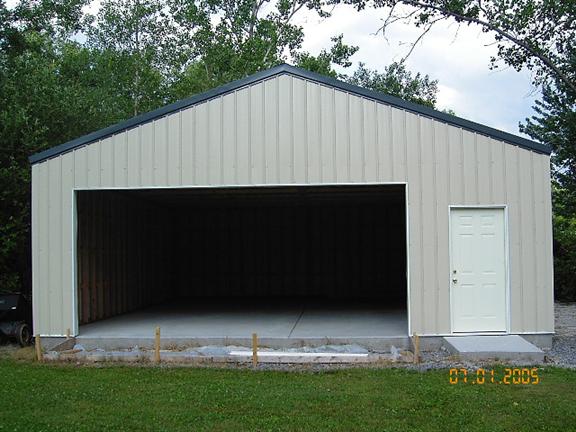

The TC 30 has her new home and did a lot of the work herself. This has been my summer project.

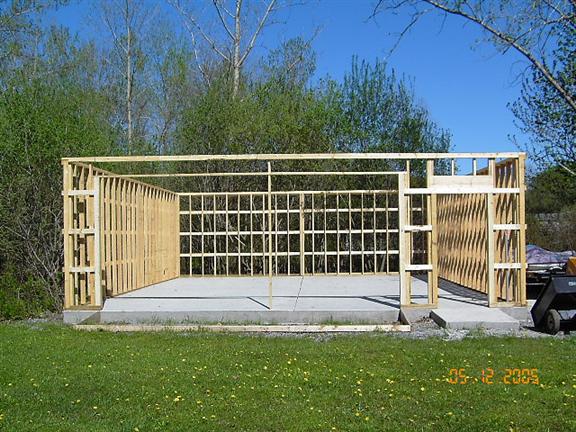

   / Baby's got a new home Finally
#2
Re: Baby\'s got a new home Finally
Picture #2

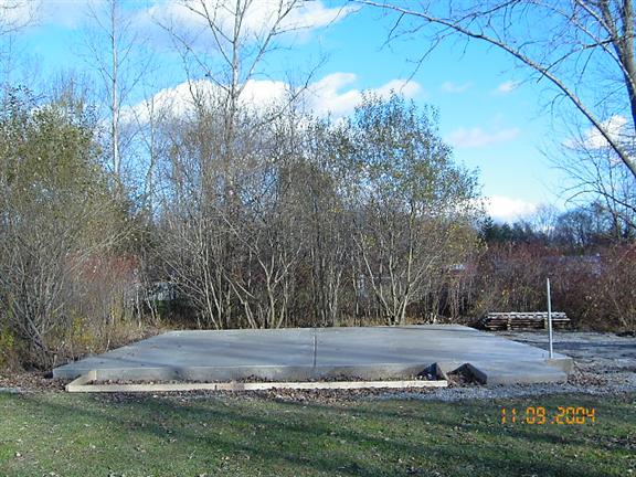

Picture #3

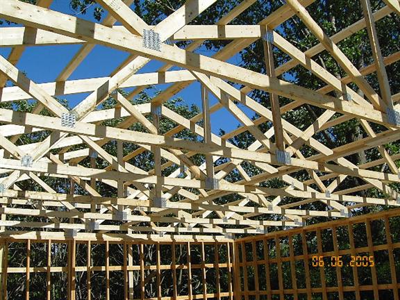

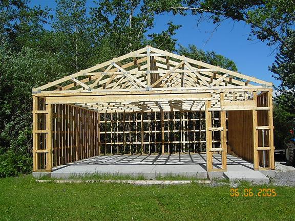

picture #4 truss system

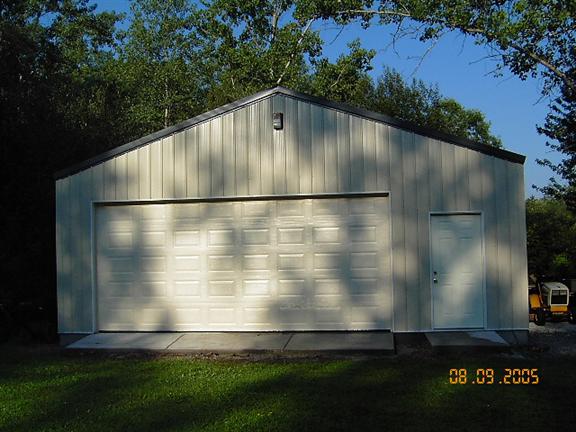

picture #6 DONE !!!!! 28'wide 32' deep, 18' x 8' overhead door, 3' man door, no windows, 220v electric, phone, gas, 16" center 2x4 studs, 4' on center trusses, purlins and nailers 2' O.C. on roof and walls. Steel roof, walls, garage door and man door. 6" stone base, #4 rebar, 6" concrete and 18" x 12" honch. And a whole lot poorer, but me and the TC are real happy.
Sorry something got screwed up. Picture #5 Steel roof and siding
   / Baby's got a new home Finally #7
EXCELLENT JOB! I need to build something like that on my place - as soon as I win the lottery...........
   / Baby's got a new home Finally #8
</font><font color="blue" class="small">( picture #6 DONE !!!!! 28'wide 32' deep, 18' x 8' overhead door, 3' man door, no windows, 220v electric, phone, gas, 16" center 2x4 studs, 4' on center trusses, purlins and nailers 2' O.C. on roof and walls. Steel roof, walls, garage door and man door. 6" stone base, #4 rebar, 6" concrete and 18" x 12" honch. And a whole lot poorer, but me and the TC are real happy.
)</font>
It looks great, when can I move in /forums/images/graemlins/grin.gif
   / Baby's got a new home Finally #9
Looks great. Did you notch out the studs for the horizontal 2x framing? Hard to tell from the side and end wall pictures.
<font color="blue"> And a whole lot poorer, but me and the TC are real happy.
</font> Is the Cub Cadet now treated like the "red headed step child" , Left alone out in the cold and rain. /forums/images/graemlins/blush.gif
didn't have to put horizontals in because i have 2x4 nailers going horizontal every 22" going up the sides with two nails on every 16" OC stud, then add the metal panels and it doesn't even shake. The cub gets used often for front lawn finished mowing. Sometimes at night, when it's cold, I noticed the cub rolls over to the TC and snuggles up. They play together all the time and get along great.
