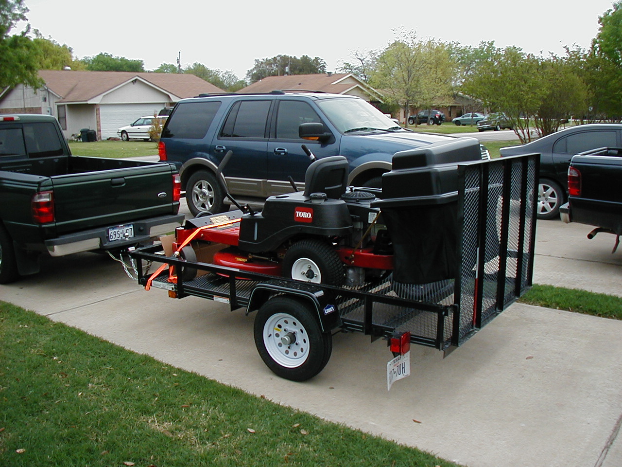

The dealer got my bagging kit in and installed today. Besides the bags and chute, the kit included a new high lift blade, an engine guard, a trailer hitch, and a front weight. It remains to be seen how well it works.

Nice looking mower, Bird :thumbsup:. You didn't waste any time using your new trailer either.
You mentioned this models ability to fit through a three foot gate. I assume the bagger chute prevents this ability? Do you still have a need to fit through a three foot gate?

With the bagger, it won't even fit through a 4' gate, or the door to the storage building where it'll be kept.:laughing: But fortunately, it's pretty easy to remove the things that need removing to put it away. And no, I don't really need to fit through a 3' gate anymore, although that's the only way into the back yards of the neighbors on either side of me, and they're nice folks, so I don't mind helping them a bit now and then. Back when I sold the other ZTR, I was going through a 3' gate at one daughter's place pretty regularly but they now have a double drive gate in addition to the 3' gate, and they've been doing their own mowing.
Of course at my own home, I have a 4' gate on the north side of the house and a double drive gate on the other side, but I don't intend to use the bagger all the time. I'll definitely use it for leaves in the Fall and the first mowing (scalping) in the Spring.
