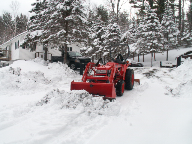

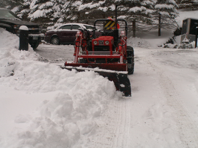

Can you use manual snow plow also attach the plow to your bucket?
Over the years I had B7100HST with 7' snow plow and it did great job removing snow,also L2800HST with 7 1/2 snowplow attach to bucket,I would pull 2 pins to remove snow plow for bucket use...addlittle rear ballast and loaded rear tires also tire chains should be okay.
