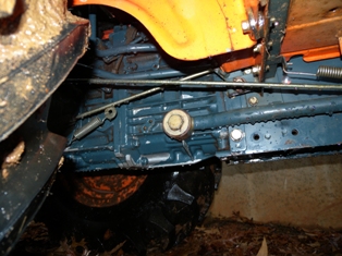

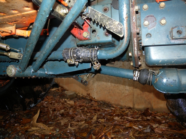

I expect Kenny is right about the suction given the pump noise. I am thinking it could be a tubbing leak. Any idea about how I can look up the hydraulic tubbing size seen in the attached picture? Hate to pay a high price from Kubora for what appears to be a simple part.
Robert, yes to your question - I cleaned the fine metal screen (strainer) on the side of the transmission case. Reference attached picture showing location (big silver bolt head) so I know were referencing the same part. I understand this to be the only hydraulic filter on the B8200D - true?? I've looked all overthis simple engine for another filter and see none. Am I missing something you know to be there?
Again, every time I've cleaned the screen or strainer, the problem disappears for a while. When I do this, I loose all the hrdraulic fluid and just end up replacing it with new fluid. It only resolves the problem for 30 to 50 hours of use.

That hose definitely looks like it's worth replacing. Guessing it may be original; a B8200 is a 1984-86 manufacture(mine was a '85).

Thanks Robert. It is the orignal hose (1986). Which fender - right / left from drivers seat? I presume it would look like a screw on oil filter, or is it something like the fuel filter size (quite small on this tractor). If it's large like a oil filter, I am sure I've seen nothing like it on the tractor.

Robert, Where can I find out what size hose that is?

For the hose, I am not sure; I would check with a dealer. I get parts from a local independant; he has helped me out with the B8200 when I had it. Otherwise, take that hose off and go to NAPA... I was able to get tune-up, belts, filters for the B8200 and the '41 Farmall I used to have, from NAPA.

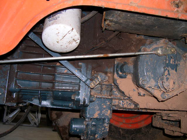

I found a picture...
The Hydro filter is accessed from under the left fender. It is basically in front of the battery.
I think I had the left rear tire off for this picture. But, you can easily get to the filter with the tire on.
There's a reason I keep old pictures... :D

I may have missed something, but did Bill say he had a hydro tranny? My B8200D is a gear tractor, and doesn't have a spin on hydraulic filter, just the screen insert.
