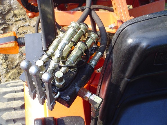

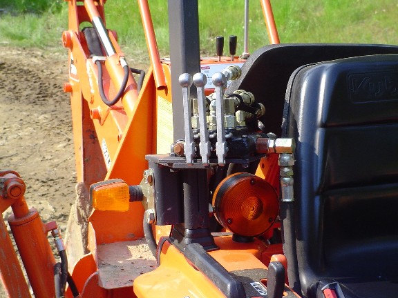

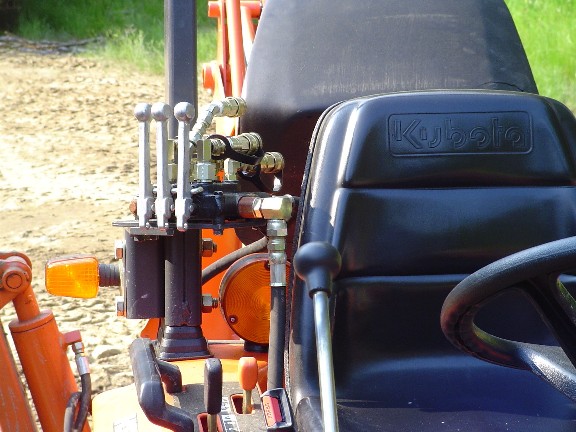

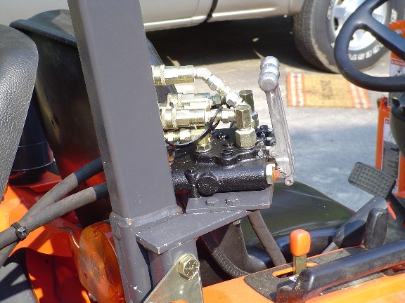

Nice set up. I hope you upgrade the wood mount, to steel...
You might want to rotate the valve 90 degrees fwd, makes operatin from the seat easier...
Hydraulic Top link, and grapple /plow controls

The plan is to upgrade it to steel. I don't have metal fabrication tools or skills, so I need to wait until one of my buddies that does has time to do it.

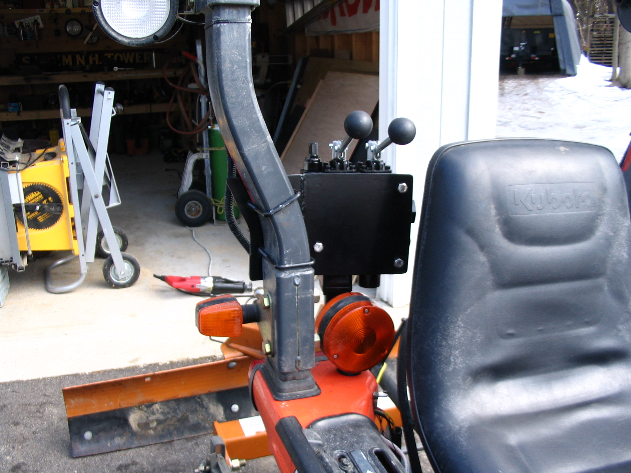

When you get around to mounting the valve permanently, here is mine on a B2410. It's a very handy location, makes looking behind you while operating the levers very easy. With your arm resting on the back of the seat, your hand just falls to that location.
