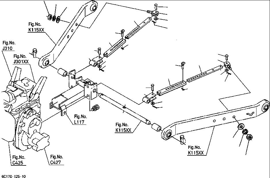

I have also replaced my 3pt linkage arms with the ones from a 2910 that so many of you have recommended. Much better setup. Thanks.

Why would you put the 2910 3pt hitch arms on the 7610?
   / B7610 50Hr. Service
I did not replace the actual lift arms. I replaced the sway bar linkage for the lift arms. The sway bar linkage from the 2910 is much better than the linkage from the 7610. It provides much more support for 3pt. mounted implements.
