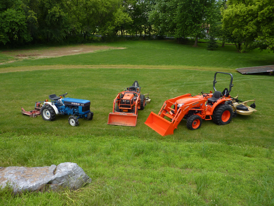

I've owned both a 154 LoBoy and a B7500. The B7500 was a lot more tractor than the Cub and I had it from new in 2002 till last summer. That said, there were often times when something bigger would have been better. I ran a 5' rotary mower a few times and it was really too big for the B7500 for any rough stuff. Since you have the M7040 you can hop on that if the B7500 isn't up to the task.
With regard to price, I sold mine for $9K a year ago. It had around 1,100 hours, was very clean, well-maintained and fortunately the hood didn't ever get creased from the loader frame missing the pins while installing it. The dealer said many with the 302 loader have the crease. Here's a shot of the B7500 the night it was separated from its "brothers".
