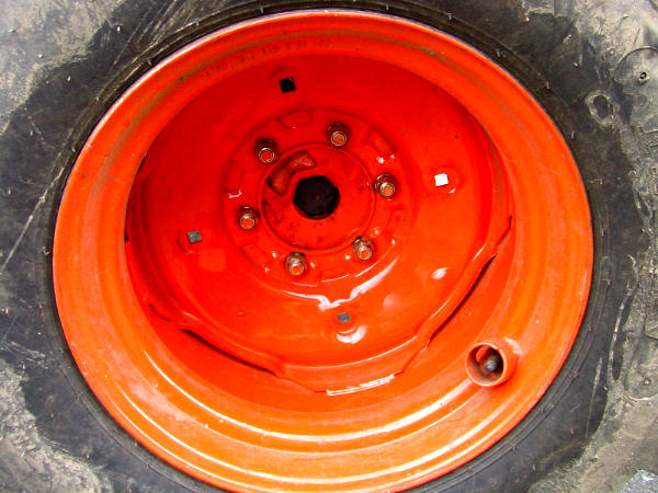

Ifyou look at my rear tire/rims, they are as follows:
The "dish" of the rim faces out, with the "mounting" plate of the rim in towards the tractor, as usual. BUT, the separate hub with the hexagon sleeve that sleeves the axle should be inside the dish of the wheel, mounted to the outward face of the wheel, and pointing outward. My hub is mounted with the flange on the inside face of the rim on the wheel side closest to the tractor, and the hex sleeve of the hub then protrudes toward the tractor from there, so it sets the wheels waaaaay out such that the inside face of the tires is even with the outside edge of my rear fenders. I'll bet some of your rear tire is under your fender... mine aren't. The installation I have is for what my manual says "Non-USA Models".

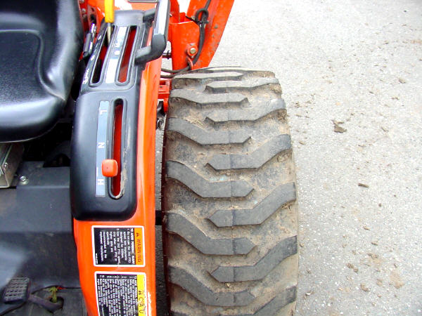

Robert,
That's the way mine are. The wheels are outside of the fender. I'll take a couple of pictures tomorrow and post them. Once again, I hope I am understanding your description correctly /forums/images/graemlins/blush.gif, but they say a picture is worth a thousand words.

Robert,
Sorry it took a while to get back with photos. Had a few distractions this weekend, so it has taken a while to get back to the tractor and camera. I'll post 3 photos. One of the wheel from a side view, one of a frontal shot showing the tire in relation to the fender and one more showing the reason for my delayed response. The picture attached here shows the wheel configuration.

   / B7500 Tire Placement? #10
Here is a frontal shot showing the tire in relation to the fender.
