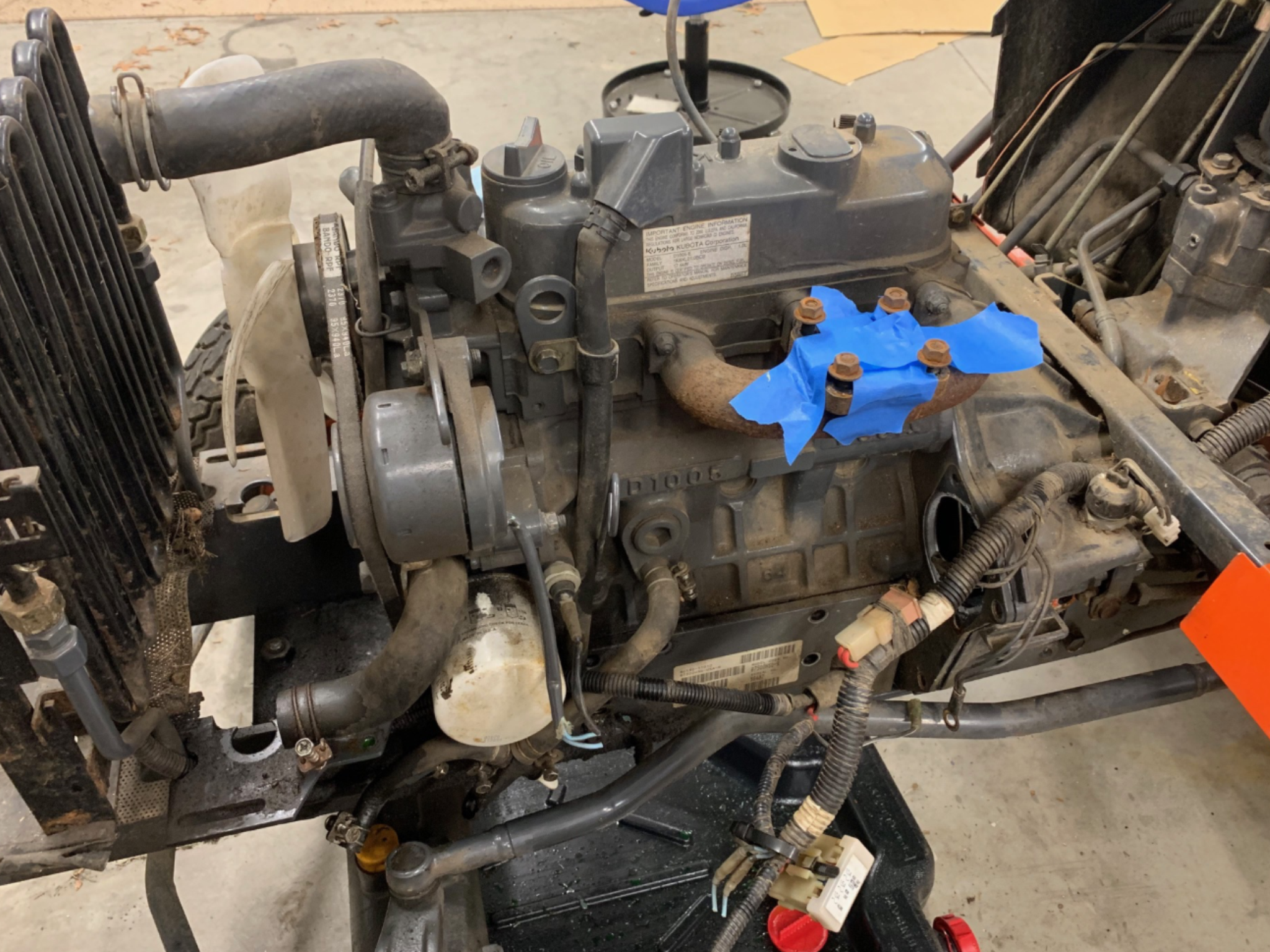

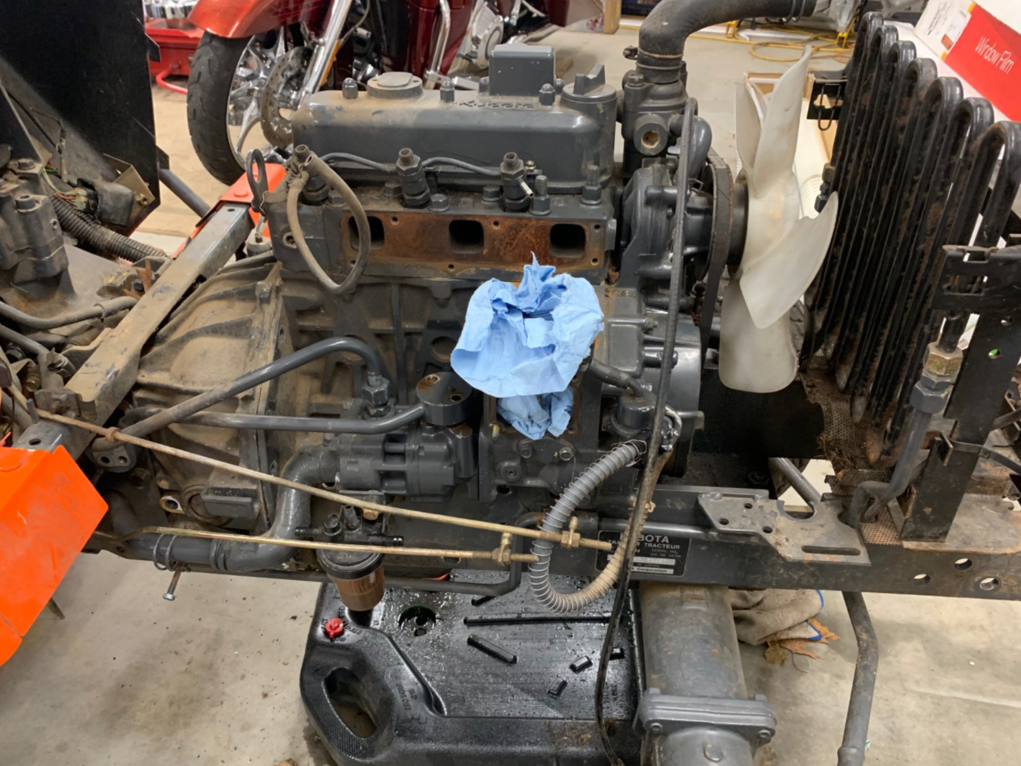

Got the "new" motor all unbolted and ready to pull. I'm going to be a little more attentive pulling the other motor so that I remember where everything came from and goes back the same way.

   / B7500 motor swap #4
Can you set both blocks to top dead center and then swamp the injection pump from the bad block to the replacement block?
   / B7500 motor swap
I may try that.
