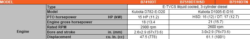

easygo said:
I do not have any wisdom about the different rating on the engines but I believe that 1hp in the US is the same HP in Germany, Japan or in China for that fact. .........there is a mathematical definition of 1HP that should be the same any place.
That is true.
Hence, that mathematical definition is expressed in different manners, according to the standard in which it was calculated.
RoyJ is telling you correct.
Or the sticker may be in a miscombobulation status. :D
